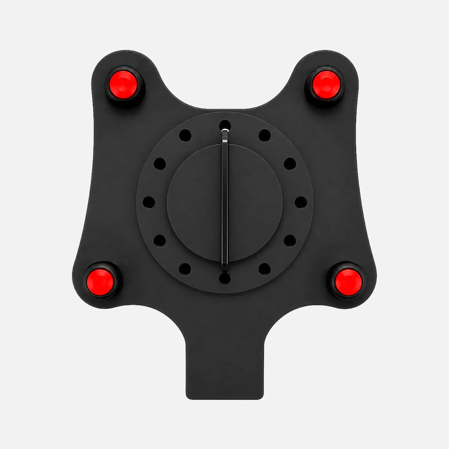

    Racing faster, harder and safer with the Motorsport steering wheel plate, with push-button controls at your fingertips, combining minimum driver distraction with maximum ease of use for every track day.
    CAN wireless system CR2 lithium battery
    4 momentary pushbuttons 3-year guarantee
    Bolt between the wheel & boss

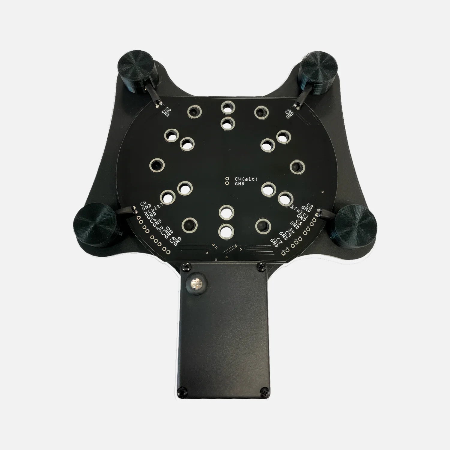

    The four-channel wireless system allows you to have push-button controls at your fingertips whether you have a detachable steering wheel or would like to avoid the need for an unreliable coiled wire connection from your steering wheel to the dashboard.
    The system uses a wireless (RF) connection between the wheel plate transmitter and the CAN receiver. The compact receiver is neatly installed behind your dashboard and attached to an AiM CAN device directly using the binder harness.

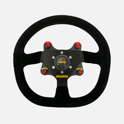

    Upgrade your wheel plate with adhesive stickers. Pre-cut and hard-wearing, and professionally printed. They are easy to apply and add a professional finish to your wheel plate. See accessories tab.
    Please Note: Images showing the steering wheel are for illusion purposes only. The steering wheel is not included. The stickers are also for visual display to show how the wheel plate could look.
    Please see the accessories tab to purchase stickers.

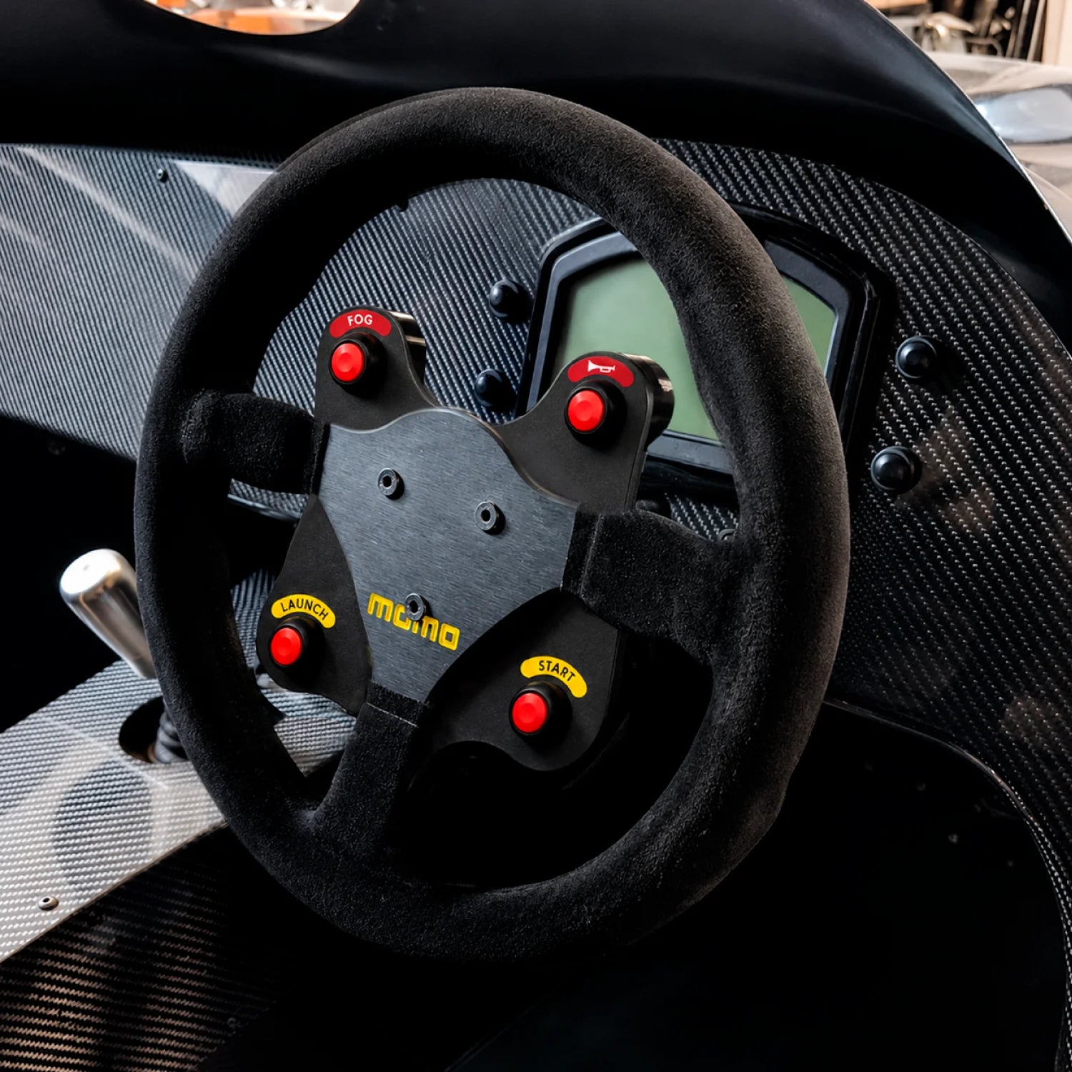

    4 Momentary Pushbuttons
    Wirelessly implemented, the in-vehicle commands in a fraction of the time with four digital push-buttons, ideal for features such as lights, horn or engine start.
    The steering wheel plate is lightweight and integrates with most CAN devices, including dashboards, ECUs, PDUs and dataloggers and has been tested to withstand the harshest EMI that can be generated within your car.

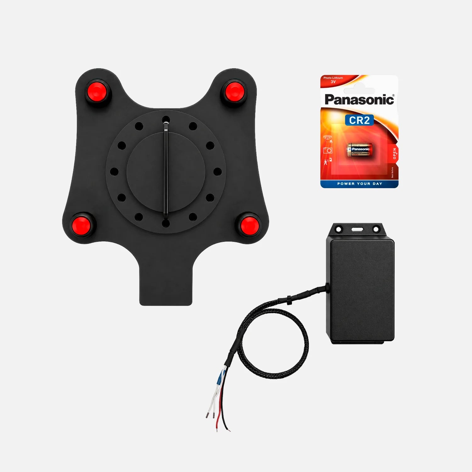

    4 Button Wireless Steering Wheel Plate
    • Four channel wireless wheel plate
    • Connection harness
    • CR2 lithium battery
    • AiM sticker
