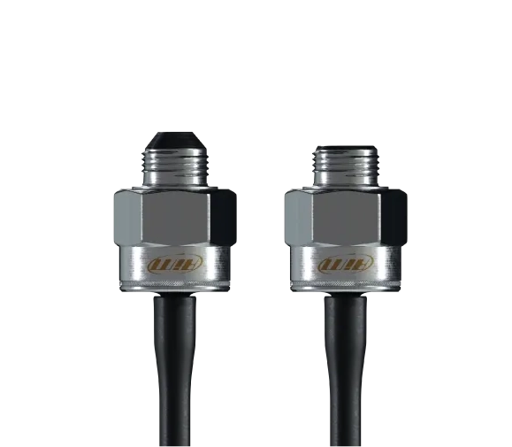

The Aim Brake Pressure Sensor 0-100 Bar is a key tool for racers and engineers who want precise, real time insight into braking performance on track. It’s widely used in both cars and bikes, from club-level to professional motorsport, and can be easily installed in a -3 brake line using a three-way T-piece.
Why Choose the Aim Brake Pressure Sensor
The 0-100 Bar Aim Brake Pressure Sensor is available with -3 JIC (3/8-24 UNF) or M10 thread options and is fitted with a 4-pin 719 male binder connector to suit Aim loggers and dash displays. Whether your car is equipped with single, dual, fixed or adjustable master cylinders, adding brake pressure sensors allows you to monitor brake performance, make real changes and identify issues quickly and precisely.

The Aim Brake Pressure Sensor is installed directly into the hydraulic brake line, usually at a calliper or master cylinder. As you apply the brakes, hydraulic pressure builds up in the line. The sensor detects this pressure and converts it into a voltage signal, which is then sent to your Aim dash or data logger. That voltage is interpreted as a pressure value (up to 100 bar), giving you a live readout of exactly how hard you’re pressing the brakes at any given moment.
0-100 Bar Pressure Sensor
The pressure sensor allows you to detect fluid and air pressures. It offers a high level of reliability and endurance and is protected against the high vibration, shock and high temperatures found in motorsport.
