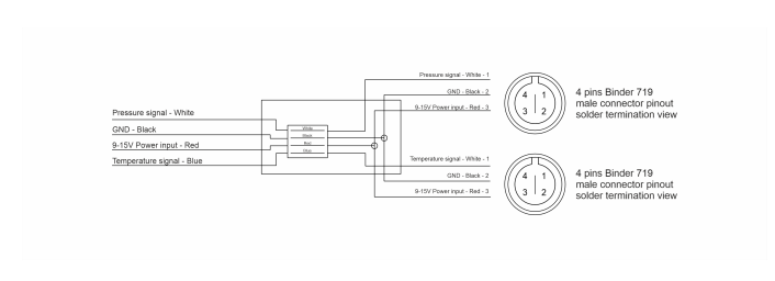

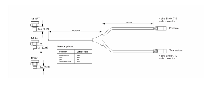

Combined temperature and pressure sensor diagram
Combined temperature and pressure sensor pinout
