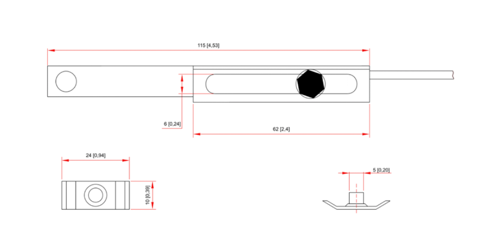

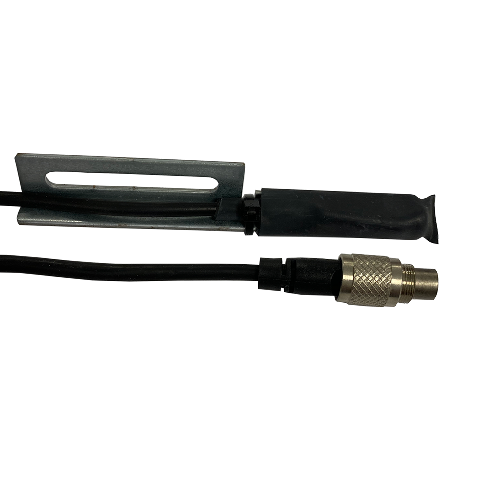

    This Aim device can measure the kart's front wheel speed using a non-contact sensor that needs a magnetic metallic trigger to pass in front of it.
    Speed sensor 712 - 4 pin binder connector
    Magnetic trigger
    Aim Front Wheel Hub Speed Pickup Sensor
    This AiM device can measure the kart's front wheel speed using a non-contact sensor that needs a magnetic metallic trigger to pass in front of it.
    The sensor kit includes a metal plate with a magnetic cylinder and a metallic bracket the sensor is welded to.
    Easy Installation
    Install the magnetic plate on the front wheel rim.
    Install the bracket onto the steering arm; if the steering arm is solid, make a hole with a 6mm drill bit.
    When mounting the bracket, ensure that the sensitive part passes in front of the cylinder at a 3-5mm distance.
    Firmly fix the bracket to the steering arm to avoid sensor movements due to the intense vibrations of the Kart front wheel.
    Ensure the bracket does not get in contact with the metallic plate when steering.
