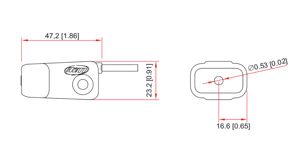

Optical Lap Receiver Diagram
Optical Lap Receiver User Guide
