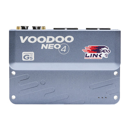

G5 Voodoo Neo 4
The next generation of engine management for many more engines.
The G5 Voodoo Neo 4 Can Run:

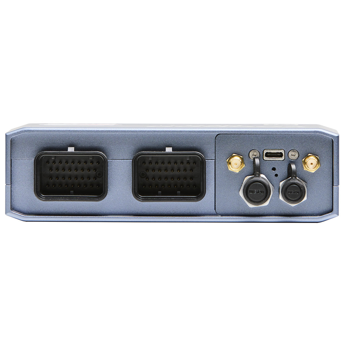

Communications
  • USB-C (cable included)
  • Power over USB
  • Connect directly to the ECU via built-in WiFi access point, or add it to an existing network (antenna included).
  • New WEIPU connector supplies power for CAN devices
  • Built in ethernet which can function like USB. Also adds the ability to connect to the ECU over a network.
  • Functional when GPS antenna is connected (antenna included)

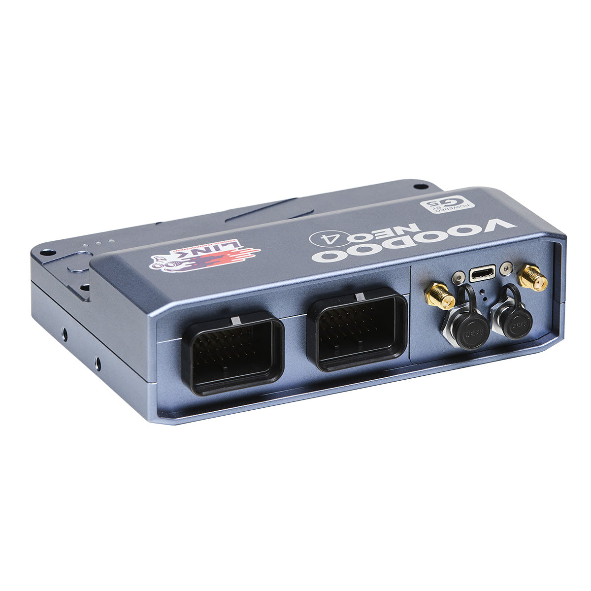

  • Length: 107mm
  • Width: 158mm
  • Max Side Height: 45mm
  • Weight: 730g
Mounting
  • 4x M5 threaded mount holes on the sides for bracket mounting
  • 4x M5 threaded mount holes on the underside for clean mounting
  • 4 x 5.5mm unthreaded through holes for mounting through (designed for use with M5 bolts)
