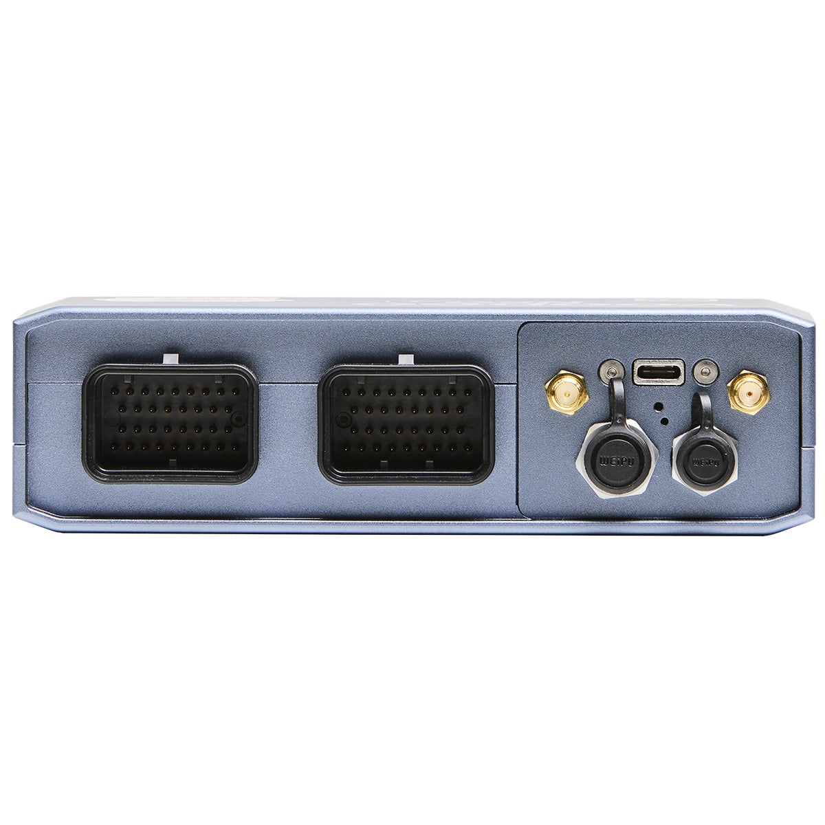

  • CAN 1 via Weipu connector. CAN connector now supplies power and ground.
Communications
  • USB-C (cable included)
  • Power over USB
  • Wi-Fi: Connect directly to the ECU via built-in Wi-fi Access Point, or add it to an existing network (antenna included)
  • CAN: New WEIPU connector supplies power for CAN devices
  • Ethernet: Built-in ethernet, which can function like USB. Also adds the ability to connect to the ECU over a network.
  • GPS: Functional when GPS antenna connected (antenna included)

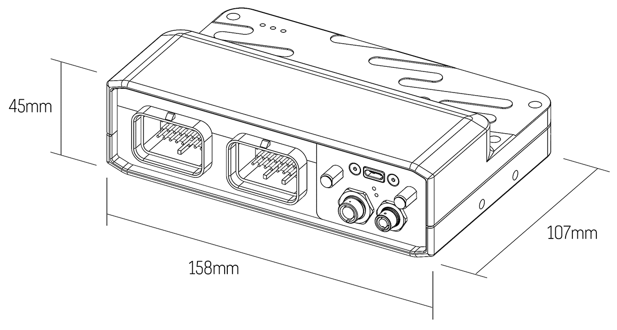

  • Length: 107mm
  • Width: 158mm
  • Max side height: 45mm
  • Weight: 730g

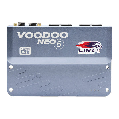

Mounting
  • 4x M5 threaded mount holes on the sides for bracket mounting
  • 4x M5 threaded mount holes on the underside for clean mounting
  • 4x 5.5mm unthreaded through holes for mounting through (designed for use with M5 bolts)
