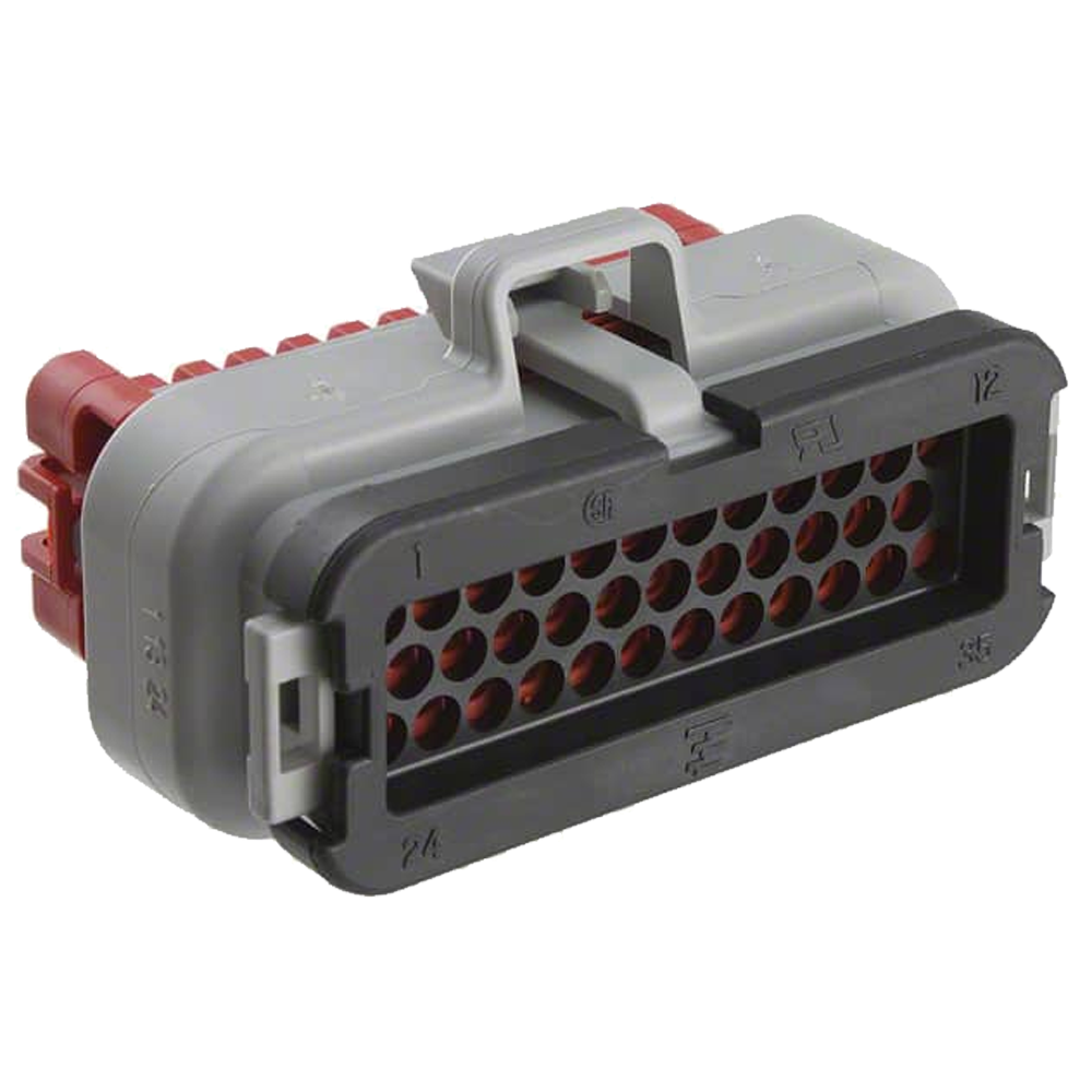

The Grey 35-Pin AMP PDM Plug Connector provides a rugged housing socket for PDM connection harnesses. It's highly reliable under high temperatures and has an IP67 rating, making it extremely water and dust-resistant.
Why Choose the Aim 35-Pin Grey AMP Connector Plug
The 35-Pin AMP Plug Connector is a brilliant and rugged connector housing that can withstand extremely high temperatures (-40°C to +125°C). It has a 2-piece contact hold design with secondary locking to prevent the contact from getting torn out under harsh conditions. These connectors accept a wire size of 0.5 to 1.25mm².
  • Type: Automotive connector housing
  • Number Of Contacts: 35
  • Gender: Female
  • Number Of Rows: 3
  • Current Rating: 17A
  • Mounting Type: Cable mount
  • Colour: Grey
  • Termination Method: Crimp
  • Height: 34.6mm
  • Width: 63.4mm
  • Depth: 33.6mm
  • Minimum Operating Temperature: -40°C
  • Maximum Operating Temperature: +125°C
  • Housing Material: Polybutylene Terephthalate (PBT)
  • Waterproof: IP67
  • 2-piece contact hold
  • Integrated latch for mating
SKU: P-AMP-35-G
Part Number: 5CND7761644
