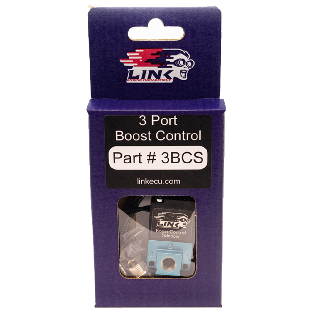

    Link 3 Port Boost Control Solenoid for engine boost management
    Link 3-port boost control solenoid for engine turbo boost management
    3BCS
    Link Boost Control Solenoid 3 Port
    販売価格£102.00
    通常価格 £120.00
    Need more boost then this 3 port boost control solenoid will help you do it.
    3 port boost control solenoids are the go-to for the majority of boost control applications, they allow for precise control of boost and boost levels can be raised to around 2-3 times the spring pressure of the wastegate.
    For higher boost applications consider our 4-Port boost control solenoid.
    Features
    Compatible with all Link ECU’s
    Can be used with single or multiple wastegates (Using T junction)
    Compatible with internal or external wastegates
    Fast and consistent response times
    High shifting forces
    MAC 35 series – Rugged, reliable and long operational life
    Short stroke, high flow
    Balanced poppet, immune to variations of pressure
    We recommend starting with a PWM frequency of 20Hz for this Boost control solenoid. A detailed description of setting up boost control can be found in the help file in the PC Link software which is available in the download tab.
     MAC 35 series
    120 PSI max
    1/8” BSPPL
    12 VDC (5.4W)
    18” (45cm) coil leads
    Includes 3 x 1/8” BSP hose tail fittings for easy connection
    • 3 Port Boost Control
    • 3 x 1/8" BSP hose tail fittings for easy connection
