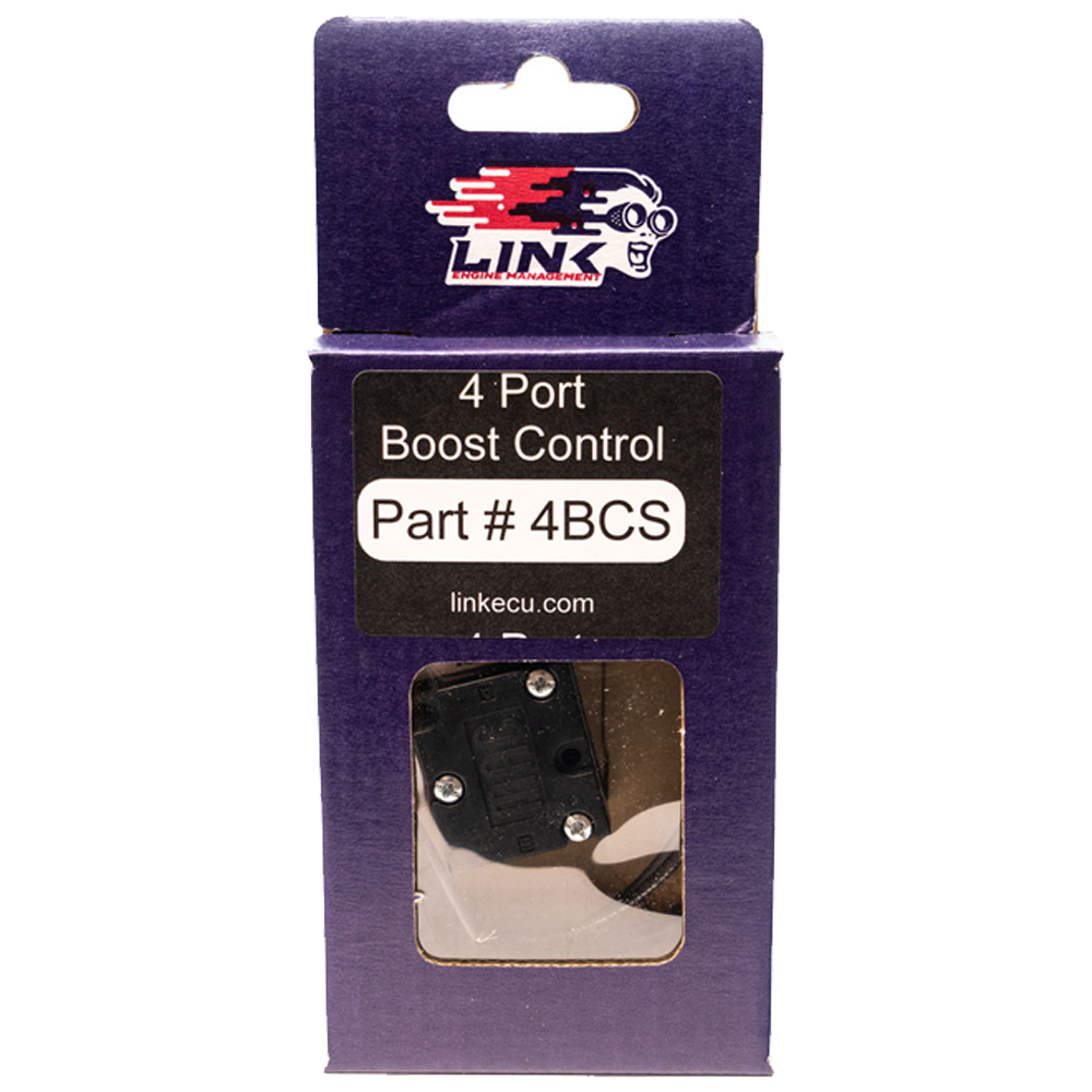

Link Boost Control Solenoid 4 Port by Link, compact black boost control valve with four ports
販売価格£120.00通常価格 £150.00
Thinking of turning up the boost to the max? Then this 4 port boost control solenoid is perfect. It allows for precise boost control of up to 120PSI.
4 port Boost control solenoids are commonly used for big boost applications, boost levels can be raised as high as 6-7 times the spring pressure of the wastegate and they allow you to use lower wastegate spring pressures for more precise boost control when launching. Particularly useful in high power traction limited situations where you might want a low boost in low gears and a higher boost in high gears.
Features
Up to 120PSI
Compatible with all Link ECU’s
Can be used with single or multiple wastegates
Fast and consistent response times
High shifting forces
MAC 45 series – Rugged, reliable and long operational life
Short stroke, high flow
Balanced poppet, immune to variations of pressure
We recommend starting with a PWM frequency of 25Hz for this Boost control solenoid. A detailed description of setting up boost control can be found in the help file in the PC Link software which is available in the download tab.
 MAC 45 series
120 PSI max
1/8” BSPPL
12 VDC (5.4W) 18” (45cm) coil leads
Includes 4 x 1/8” BSP hose tail fittings for easy connection
  • 4 Port Boost Control
  • 4 x 1/8" BSP hose tail fittings for easy connection
