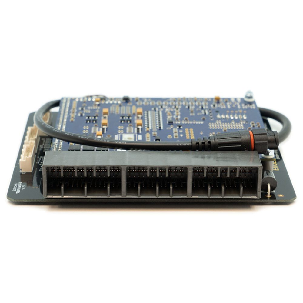

    This ECU is designed for the EVO 9 4G63 engine.
    Includes onboard 4 bar or 7 bar MAP sensor
    Suitable Applications:
    CT9A Lancer Evolution 9, 2005-2007
    CT9A Lancer Evolution 8, 2003-2005 with 3 plug ECU ONLY
    Any EVO8 car with a 3 plug ECU will also require this ECU.
    PlugIn Key Features:
    Sequential fuel delivery
    OEM idle hardware supported
    CAN port
    USB tuning cable included
    Staged injection
    Knock with "windowing"
    I/O Expansion Options:
    Expansion connector 1
    Gnd Sensor Ground Only
    DI 9 Digital Input
    DI 10 Digital Input
    Aux 11 Auxiliary Output
    An Volt 11 Analog 0-5V input
    An Volt 8 Analog 0-5V input
    Expansion connector 2
    Aux 9 EThrottle - can't be used as an Aux out
    Aux 10 Auxiliary Output
    An Volt 6 Analog 0-5V input
    An Volt 7 Analog 0-5V input
    An Volt 9 Analog 0-5V input
    An Volt 10 Analog 0-5V input
