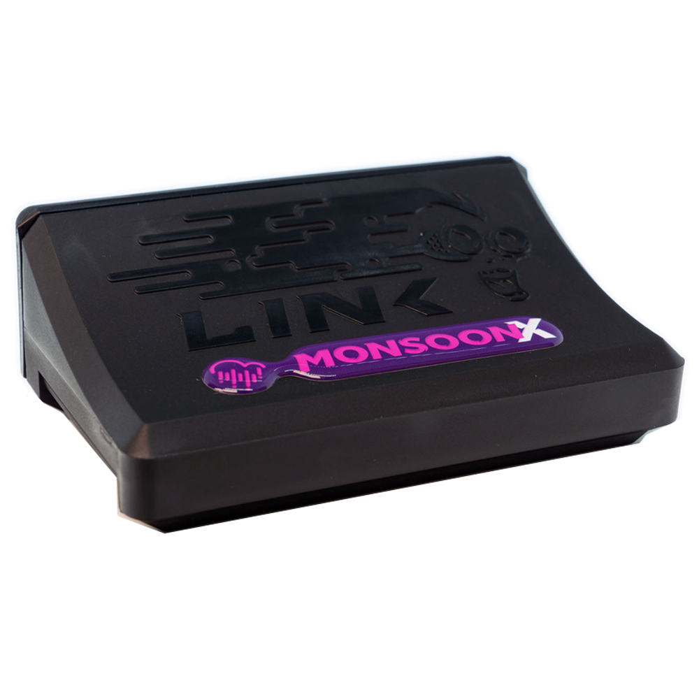

    Link G4X MonsoonX WireIn ECU
    More features, more powerful.
    The MonsoonX has been upgraded to provide 512 megabytes of data logging, meaning you can log much more data at a faster sample rate. Control loops are also more precise compared to its G4+ predecessor, along with advancements such as single-precision floating-point format fuel tables, better resolution within ignition timing and faster communications. These upgrades make the G4X Monsoon a true powerhouse in a small shell.
    G4X features 512 megabytes of logging at 32bit using up to 250 channels, each limited to up to 1kHz per channel (by the Operating System), with a maximum of 100 kSamples/sec.
    With the MonsoonX you have all the tuning capabilities of the AtomX, but you can also choose to run some of the following features: Launch Control, Anti-lag, VVT Control and Closed Loop Boost Control. It also comes with a built-in 4 bar or 7 bar MAP sensor further reducing installation cost.
    Note: The MonsoonX will run any of the above features, but it cannot run them all at once. The number of features you can run is dependent on how many of the limited Inputs and Outputs each feature needs.
    The MonsoonX will control up to 2 rotors or 4 cylinders with sequential injection and direct spark. Or, it can be used for up to eight cylinders using batch fire.
    This makes it ideal for naturally aspirated or turbocharged engines that just need a retune and one or two extra features, so you don’t need to jump up to one of our higher-level ECUs.
    * Requires "A" loom (sold separately)
    The MonsoonX is ideal for:
    1-12 Cylinder Distributed
    2-8 Cylinder Wasted Spark
    1-4 Cylinder Direct Spark
    Odd Fire Engines
    2-Stroke Engines
    Configurable Firing Order
    Configurable TDC Points (for odd fire)
    * Requires A Loom
    Inputs
    4 x Digital inputs
    2 x Temperature inputs
    4 x Analog inputs
    2 x Trigger inputs
    1 x Onboard 4 Bar MAP sensor
    Outputs
    4 x Injector drives
    4 x Ignition drivers
    6 x Auxiliary outputs^
    +5V Sensor power supply
    ^unused ignition drives can be used as additional Aux outputs
    Communications
    1x CAN bus
    1x USB tuning connection
    Upgraded communications chip (four times faster than G4+)
    Physical
    Dimensions: 95mm(L) x 130mm(W) x 45mm(H) (without loom)
    Weight: 220 grams
    Advanced features not found on the AtomX:
    Antilag, rolling anti-lag and launch control.
    Up to 2 fully variable closed loop VVT cams.
    Misc:
    512MB of logging memory
    20 general-purpose tables
    Runs on PC Link software for G4X
    The MonsoonX comes supplied with waterproof connectors, a mounting bracket and a USB tuning cable. “A Loom” to be purchased separately.
