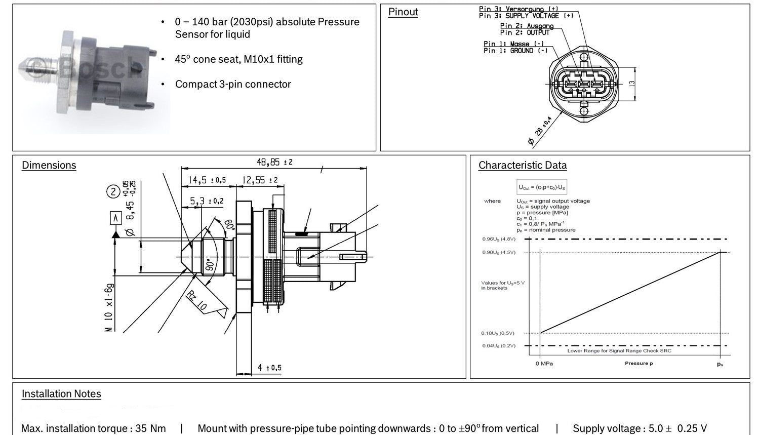

The Link high-pressure sensor for liquid is used for things like fuel, clutch, brake etc.
Why Choose the Link M10 140 Bar Pressure Sensor

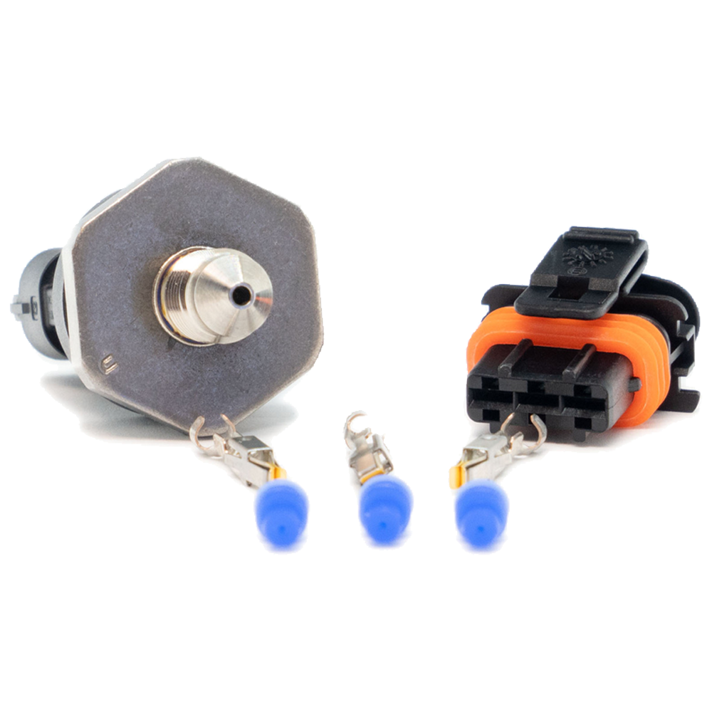

The Link M10 140 bar pressure sensor provides accurate measurement of high-pressure systems up to 140 bar (2030 PSI). It features an M10x1 thread with a 45-degree cone seat for a secure, leak-free connection. Supplied with a mating connector kit, it ensures straightforward installation and dependable performance in demanding environments.
Pressure Sensor M10

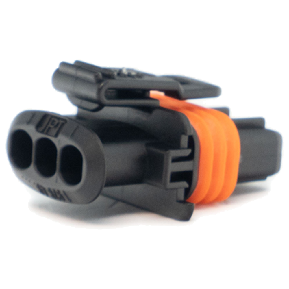

Mating Connector Plug

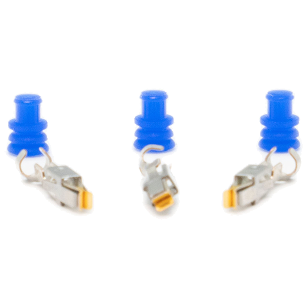

Mating Connector Pins
