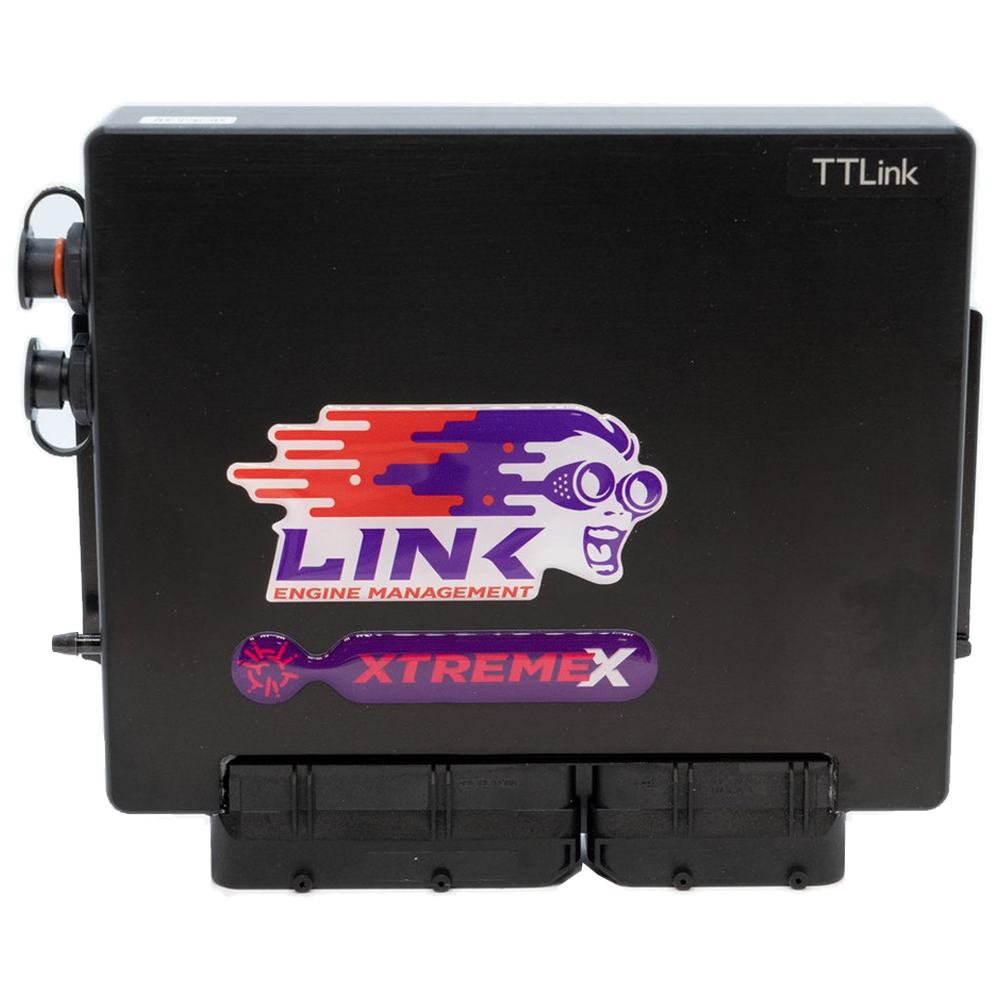

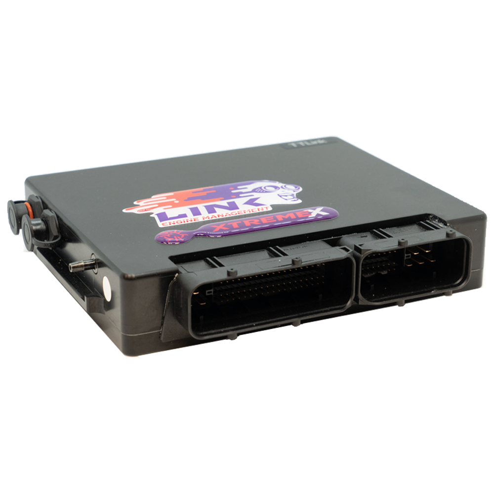

    G4X PlugIn ECUs offer the latest in engine management technology, designed to maximize the potential of your car.
    This ECU fits in the factory OEM location. Installation is a breeze, with no alteration of the factory wiring loom required for the models listed below.
    The Link G4X ECU TTLink TTX PlugIn Designed for the VWAG PQ34 1.8l Turbo engine with E-Throttle.
    This ECU works with manual transmissions only.
    Includes an onboard 4 bar or 7 bar MAP sensor.
    Suitable Applications:
    The engine must be 1.8T
    ECU header must have two connectors, 121 pin total
    Must be Drive by Wire (E-throttle)
    Must be manual transmission
    FWD or 4WD (Haldex)
    p to 6D fuel and ignition mapping
    Sequential fuel delivery
    OEM idle hardware supported
    CAN port
    USB tuning cable included
    Staged injection
    Knock with "windowing"
    Expansion connector 2
    There is no separate expansion connector on the TT Link.
