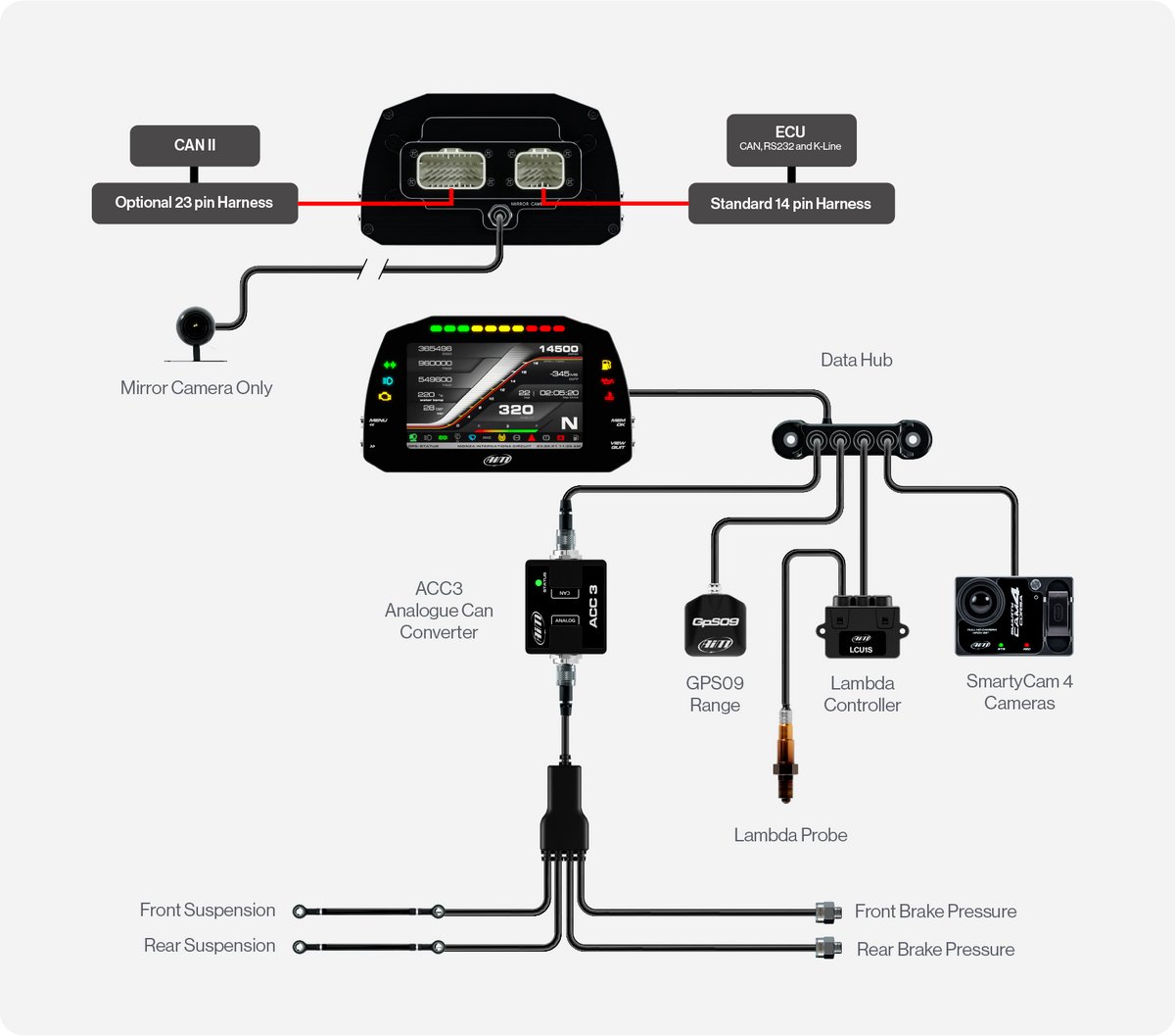

The MXS Strada with road icons is one of the most widely used dash displays on roads around the world. The MXS 1.3 Strada has a compact 5" colour TFT display that offers great visual impact. You can configure the dash to show all the information coming from the motorcycle’s ECU, analogue/digital inputs, predefined math channels and an optional GPS Module.
The MXS 1.3 Strada has a choice of ECU connections. Choose between the OBDII or K-Line CAN. Depending on whether you want to connect to the motorcycle's ECU using the OBDII port or directly to the ECU through the CAN channel.
Connecting the MXS 1.3 Strada dash to your motorcycle's ECU is simple; you can sample and display dozens of channels. This is usually the quickest and easiest setup, needing only 2 cable connections to the ECU instead of multiple connections to analogue sensors.
The sampled data depends on the actual ECU, but will typically include RPM, throttle position (TPS), oil, air, water temperature, oil pressure, battery voltage, speed, gear, and lambda value (air/fuel ratio). The list of available ECU drivers is over 1,000 and is constantly being updated and upgraded.

The MXS 1.3 Strada features a 1-AMP digital output configurable to be activated/deactivated depending on the value of the analogue/digital inputs or on the impulses coming from the motorcycle’s ECU. This allows you to automatically run external systems, such as switching on/off additional lights, to activate/deactivate a cooling fan or circulation pumps when a certain event happens.
With CAN output, you can send messages directly to an existing CAN network to improve the range of the motorcycle's control possibilities.

How do I connect my MXS Strada to the motorcycle's OBDII connector?
Use a dedicated OBDII wiring harness and configure the MXS Strada with Race Studio 3. The process involves a physical connection followed by software setup to identify your motorcycle's specific ECU protocol. More information can be found here.
