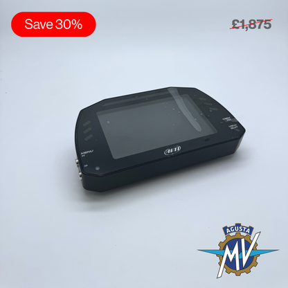

    Aim MXS 5" MV Agusta OEM Data Logger Kit
    The MXS 1.3 MV Agusta dash logger has a 5" TFT display which has been designed to acquire and display data coming from the ECU.
    5" compact TFT display GPS Module
    CAN output 6 configurable RGB LEDs
    Aim MXS MV Agusta OEM Data Logger Kit
    The MXS 1.3 5" TFT compact Dash Logger is fully configurable and suitable for many different Motorsports. It has been designed to acquire and display data coming from the ECU. Analogue/digital inputs and predefined math channels. Performance and data acquired can also be incremented by adding up to eight expansion modules. The MXS 1.3 is a great choice for compact cockpit installations where space is at a premium.
    Connecting the MXS 1.3 dash to your ECU is simple. You can sample dozens of channels straight from the vehicles ECU. This is usually the quickest and easiest setup, needing only a cable connection to the ECU instead of multiple connections and analogue sensors. The sampled data will depend on your actual ECU but typically includes RPM, engine load, throttle position (TPS), oil, air, water temperature, oil pressure, battery voltage, speed, gear, lambda value (air/fuel ratio). The list of available ECU drivers is constantly updated and upgraded and includes approximately 1000+ different  ECUs.
    Two Digital Outputs
    MXS 1.3 features two digital outputs. Each of them can give an output of 1 amp at 12 volts. They can be configured to be turned on/off depending on the value of the analogue or digital inputs. They permit to automatically run external systems such as switching on/off additional lights, to activate/deactivate a cooling fan or circulation pumps when a certain event happens.
    With a high contrast 5" TFT display which is fully configurable. You can create and customise pages/displays to suit your requirements. Swapping pages can be managed by pushing on or two push buttons.
    Two analogue camera inputs are available, to switch your display into a mirror camera, through a push button command or event management. The camera sold separately.
    Flexible Alarms
    The MXS has six configurable RGB LEDs. You can choose the conditions and colours. Select a solid alarm or flashing one and the flashing frequency, you can choose to have an accompanying text message and set the alarm priorities.
    CAN output
    GPS Module
    The GPS Module connected via CAN to the MXS makes lap time calculation and track position analysis easy. With 4000+ worldwide tracks already stored with the start and finish line coordinates you will have no problem when you're on the track. As soon as the MXS is turned on the GPS Module will locate its position, identify track line coordinates and start immediately sampling lap and split time. If the track is not on the database, you can easily add the start/finish line coordinates to the MXS via a PC before you go to the track using our Race Studio 3 software.
    The GPS Module is available in 1.3m or a roof version in 2m.
    Pin Harness
    These are only some of the items that can be added to our MXS 1.3 for incrementing the performance and the data acquired.
    With Race Studio 3, you can also analyse all data recorded by MXS 1.3 and download it to your PC: graphs, histograms and tables will help you study your performance, providing objective support to avoid mistakes and improve performances.

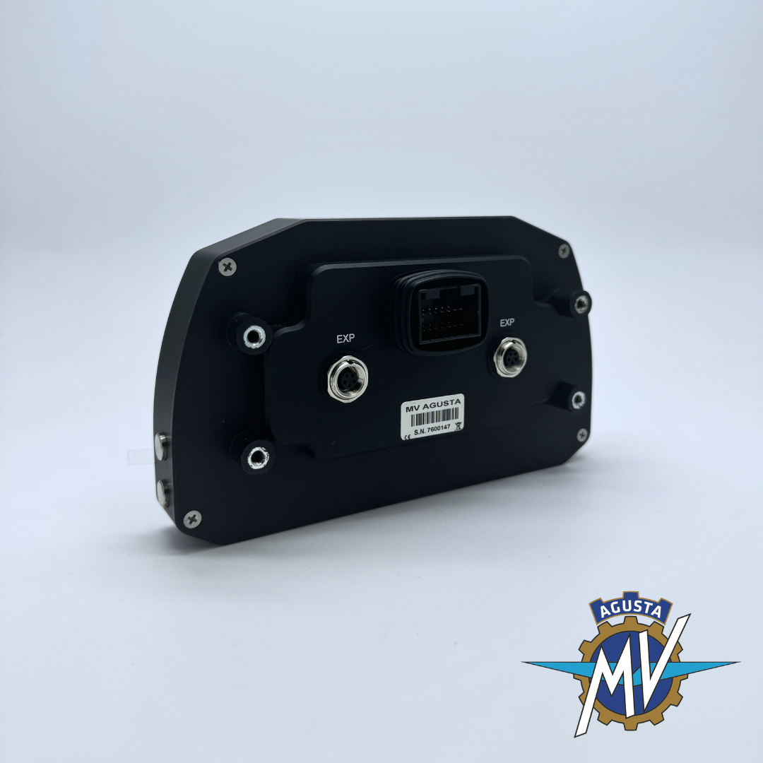

    Aim MXS 1.3 MV Agusta OEM Data Logger Kit
    • Display: 5" Display
    • CAN connections: 3
    • ECU connections: CAN, RS232 or K-Line
    • Analogue Inputs: 8 fully configurable, max 1,000Hz each
    • Second CAN: Yes
    • Wi-Fi connection: Yes
    • Internal Memory: 4GB
    • Body: Anodised Aluminium
    • Power Consumption: 400mA
    • Weight: 530g
    • Waterproof: IP65
    • MXS 1.3 Dash Logger
    • 37 Pin standard harness
    • GPS Module with cable
