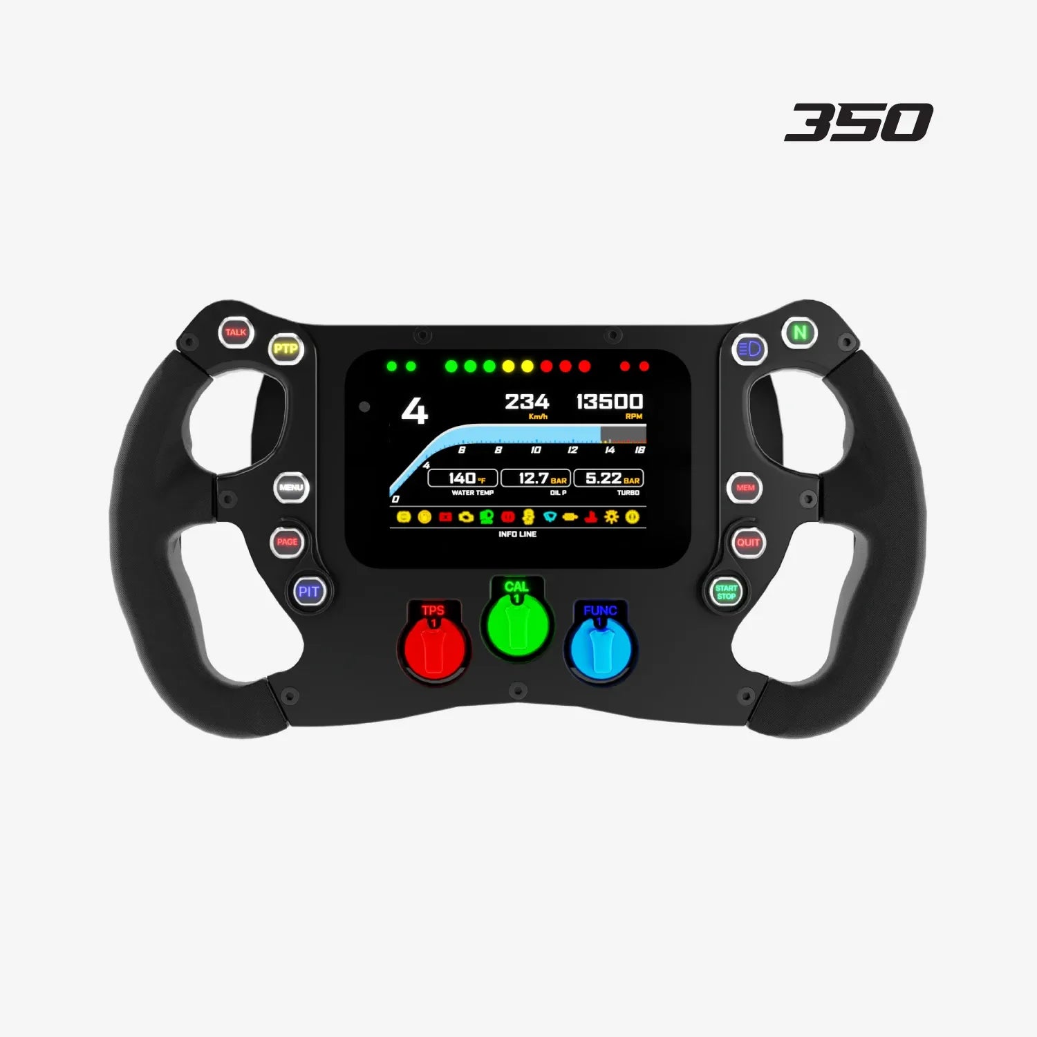

The Formula Steering Wheel 4 GT320/GT350 has a high contrast 5" TFT display that is fully configurable and resistant to sunlight glare. With the ambient light sensor, the display is easy to read night and day.
The Formula Steering Wheel 4 GT320/GT350 has 10 push buttons and 3 rotary switches, all backlit with RGB LEDs for enhanced usability.
