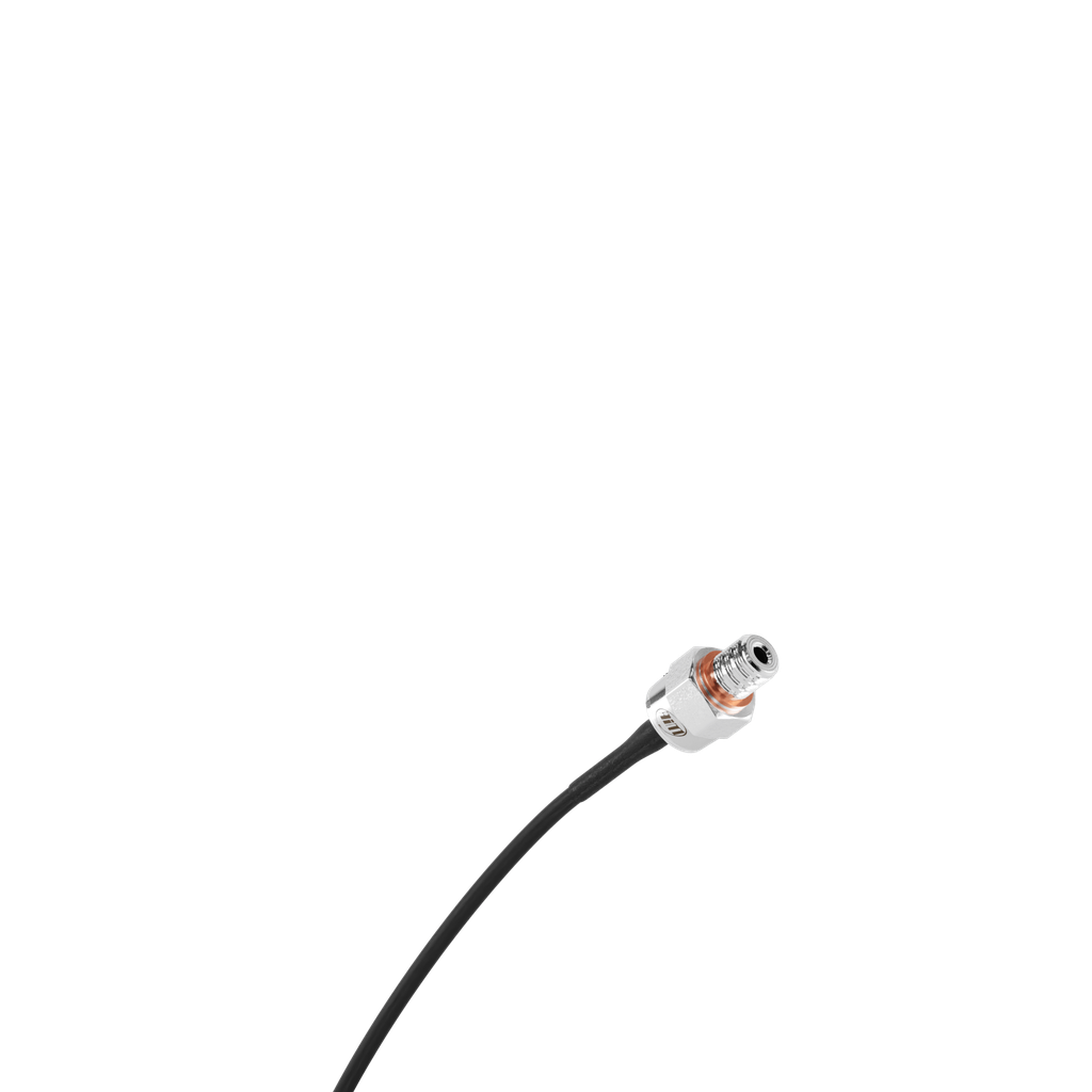

The Aim Absolute Pressure Sensor is installed directly into the air intake or boost line. Inside the sensor is a sensitive internal component, typically a thin diaphragm with a vacuum sealed behind it.
As the turbocharger or supercharger generates boost, that air pressure forces the diaphragm to flex. The sensor precisely measures this movement and converts it into an electrical voltage signal:
- Minimum Pressure (0 PSI Absolute): The sensor outputs its lowest voltage, typically 0.5 Volts (V). This represents a total vacuum.
- Maximum Pressure (50 PSI Absolute): The sensor outputs its peak voltage, typically 4.5 Volts (V).
This is a linear scale, meaning the voltage increases at the same rate as the pressure. For example, if the pressure is exactly halfway (25 PSI Absolute), the voltage will also be halfway (around 2.5V).
