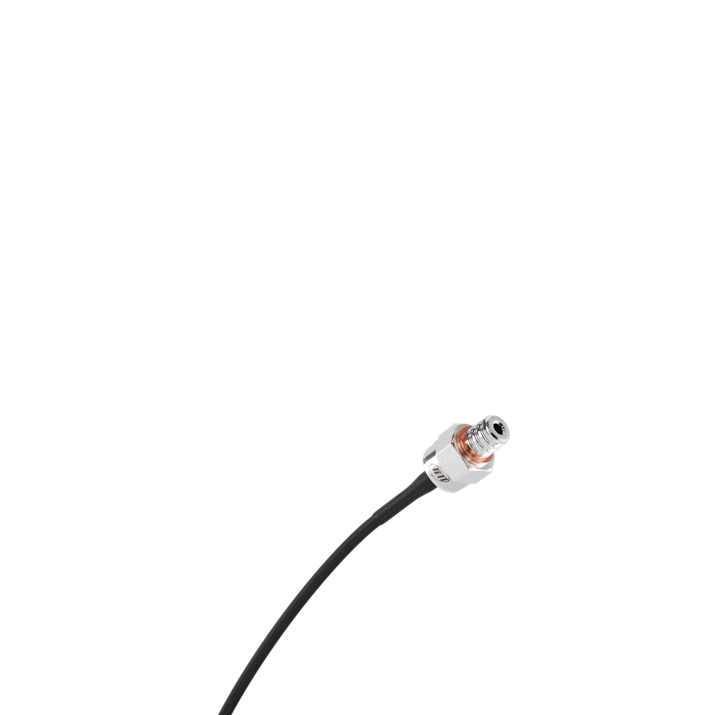

The Aim Pressure Sensor is suitable for oil, fuel and water pressure readings, reading pressures up to 150 PSI. This pressure sensor sits within the oil/fuel line, and measures exactly how much pressure passes through.
Why Choose the Aim Oil / Fuel Pressure Sensor
The Aim 0-15 PSI Pressure Sensor is available in 1/8 NPT thread options and is fitted with a 4-pin 719 male binder connector to suit Aim loggers, dash loggers, lap timers and dash displays. Many aspects affect various engine pressures, so knowing your engine has the correct amount of pressure is paramount to longevity and performance.
If there is a pressure change, incorporating a pressure sensor into your setup will allow it to be detected and signalled to prevent the worst. You can see through live telemetry about what’s happening as the sensor turns the physical force of fluid pressure into a predictable electrical signal that can be monitored to protect your engine.
How the Oil / Fuel Pressure Sensor Works
The Aim Oil / Fuel Pressure Sensor sits in the oil/fuel line. Inside it, there's a sensitive part (often a small sheet of material called a diaphragm). When the pump pushes the oil or fuel, the pressure makes this diaphragm flex or bend. The sensor measures exactly how much it bends. The pressure sensor then converts the pressure into voltage:
- Low Pressure (0 bar): The sensor might output a very low voltage, like 0.5 Volts (V).
- High Pressure (5 bar): The sensor outputs a high voltage, like 4.5 Volts (V).
This is a linear scale, meaning that if the pressure is halfway (at 2.5 bar), the voltage will also be halfway (around 2.5V). This electrical signal is what the vehicle’s data logger or ECU (engine computer) records.
