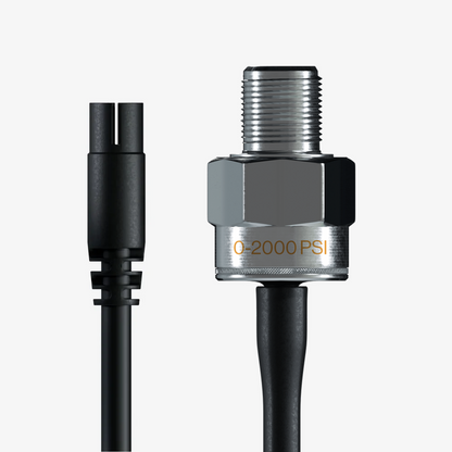

The Aim Pressure Sensor is suitable for brake, oil, fuel and water pressure readings, reading pressures up to 2000 PSI. This pressure sensor measures exactly how much pressure passes through.
Why Choose the Aim Brake Pressure Sensor
The Aim 0-2000 PSI Pressure Sensor is available in 1/8 NPT thread options and is fitted with a 4-pin 719 male binder connector to suit Aim loggers, dash loggers, lap timers and dash displays. Many aspects affect various engine pressures, so knowing your engine has the correct amount of pressure is paramount to longevity and performance.
If there is a pressure change, incorporating a pressure sensor into your setup will allow it to be detected and signalled to prevent the worst. You can see through live telemetry about what’s happening as the sensor turns the physical force of fluid pressure into a predictable electrical signal that can be monitored to protect your engine.
How the Brake Pressure Sensor Works
The Aim Brake Pressure Sensor is screwed into the brake line or master cylinder using its 1/8 NPT threaded fitting. Because brake systems can reach thousands of pounds of force, the internal diaphragm is made of high-strength stainless steel.
As you press the brake pedal, the master cylinder forces hydraulic fluid against this diaphragm. The sensor measures how much the diaphragm flexes under this intense pressure and converts it into an electrical voltage signal:
  • Low Pressure (0 PSI): With no pressure on the pedal, the sensor outputs a baseline voltage of 0.5 Volts (V).
  • High Pressure (2000 PSI): Under maximum braking, the sensor outputs its peak voltage of 4.5 Volts (V).
This is a linear scale. If you apply exactly half the maximum pressure (1000 PSI), the voltage will be exactly halfway between the minimum and maximum (2.5V). This signal allows the data logger to record exactly how hard - and how fast - you are hitting the brakes.
The Aim brake, oil, fuel and water pressure sensor is available with terminated and unterminated connectors for compatibility with external manufacturers
The pressure sensor allows you to detect fluid and air pressures. It offers a high level of reliability and endurance and is protected against the high vibration, shock and high temperatures found in motorsport.
These pressure sensors are available with a choice of PSI and Bar variants.
Compatible with MoTeC, Bosch & More
We also offer unterminated sensor that are designed to work seamlessly with Bosch, MoTeC, Cosworth, or other manufacturer hardware, making it easy for you to integrate the reliable and efficient Aim Pressure Sensors into any setup.
The Aim brake, oil, fuel and water pressure sensor is expandable with ACC3, Aim displays and display loggers, XLog, Data Hub and more
You can expand your system with a range of products from the ACC3 Analogue CAN Converter, Displays and Loggers, Data Hubs and more.
To extend the length between a dash display/logger and an analogue pressure sensor, you will need a 719-719 patch lead, available in lengths between 0.5m and 4m.
  • Supply: 8-16V
  • Characterisation: Start of scale 500 mV, End of scale 4500 mV
  • Consumption: < 10 mA
  • Burst Pressure: 3 x rated pressure
  • Temperature Working Range: -20°C to 135°C
  • Waterproof Rating: IP67
  • Housing: 316 stainless steel
  • Weight: 30g
  • Cable Length: 400mm
  • Thread: 1/8 NPT
SKU: S-P-NPT-2000
