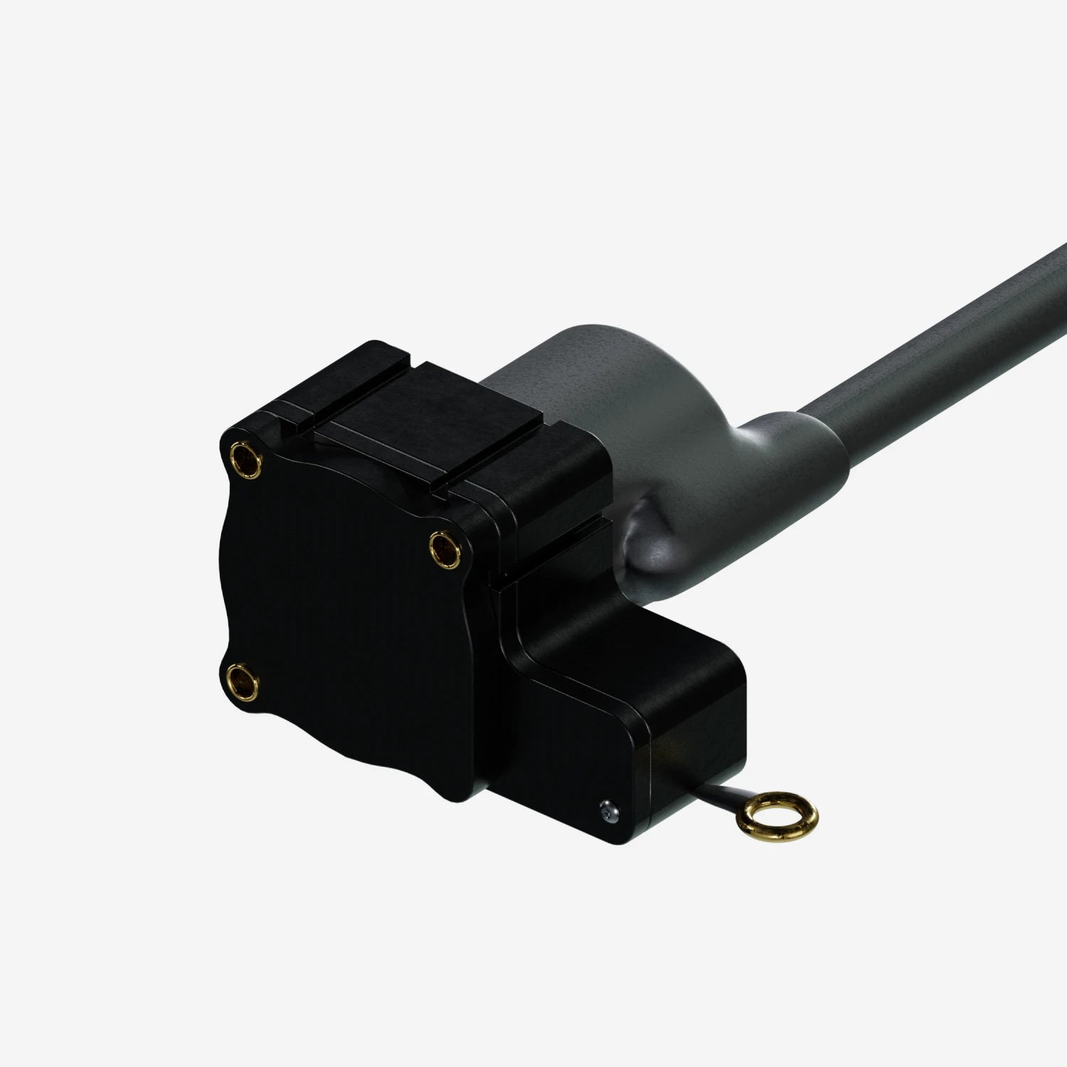

    The draw-wire sensor offers a compact and highly accurate way of measuring displacement and position.
    Key Features:
    Measure displacement & position Linearity - +0.375mm
    Robust housing 4 pin plastic binder connector
    Draw Wire Position Sensor String Pot 750mm
    The string pots consist of a measuring cable, a spool, a spring and a rotational sensor. The line is wound tightly around the spool, and the diameter of the spool is constant. The spring is in place to maintain the tension and retraction of the cable.
    The String Pot Sensor can measure linear displacements like:
    Dampers compression or extension, an excellent sensor to log on to the track to check how the suspension is performing. You can set up changes such as stiffening or loosening the suspension.
    Also, string rotation is measured through the rack displacement.
    Mount the sensor through three screws M2.5 DIN 931 or mounting clamps. The sensor does not have to be oriented in a particular way. Prefer an installation position with a measuring wire outlet facing downwards if possible. Choose the installation position so that damage and soiling of the measuring wire are avoided.
      • Robust plastic housing
      • Conductive plastic, wire, hybrid potentiometer
      • Smallest design in its class
      • Output: E/E830
      • Measuring Range: 750mm
      • Linearity: +0.375mm
      • Resolution: 6.7 pulses/mm - 0.15mm
      • Temperature Range: -20°c. +80°c
      • Material: Plastic
      • Wire Mounting: Eyelet
      • Sensor Mounting: Mounting holes/grooves
      • Protection Class: IP54
      • Weight: app 45g
