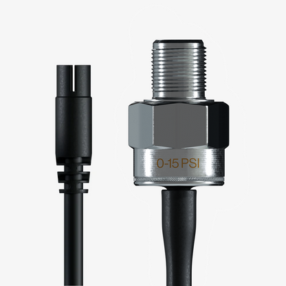

Oil / Fuel Pressure Sensor 0-15 PSI
The Aim Pressure Sensor is suitable for oil, fuel and water pressure readings, reading pressures up to 5 bars. This pressure sensor sits within the oil/fuel line, and measures exactly how much pressure passes through.
Why Choose the Aim Oil / Fuel Pressure Sensor
The Aim 0-15 PSI Pressure Sensor is available in 1/8 NPT thread options and is fitted with a 4-pin 719 male binder connector to suit Aim loggers, dash loggers, lap timers and dash displays. Many aspects affect various engine pressures, so knowing your engine has the correct amount of pressure is paramount to longevity and performance.
If there is a pressure change, incorporating a pressure sensor into your setup will allow it to be detected and signalled to prevent the worst. You can see through live telemetry about what’s happening as the sensor turns the physical force of fluid pressure into a predictable electrical signal that can be monitored to protect your engine.

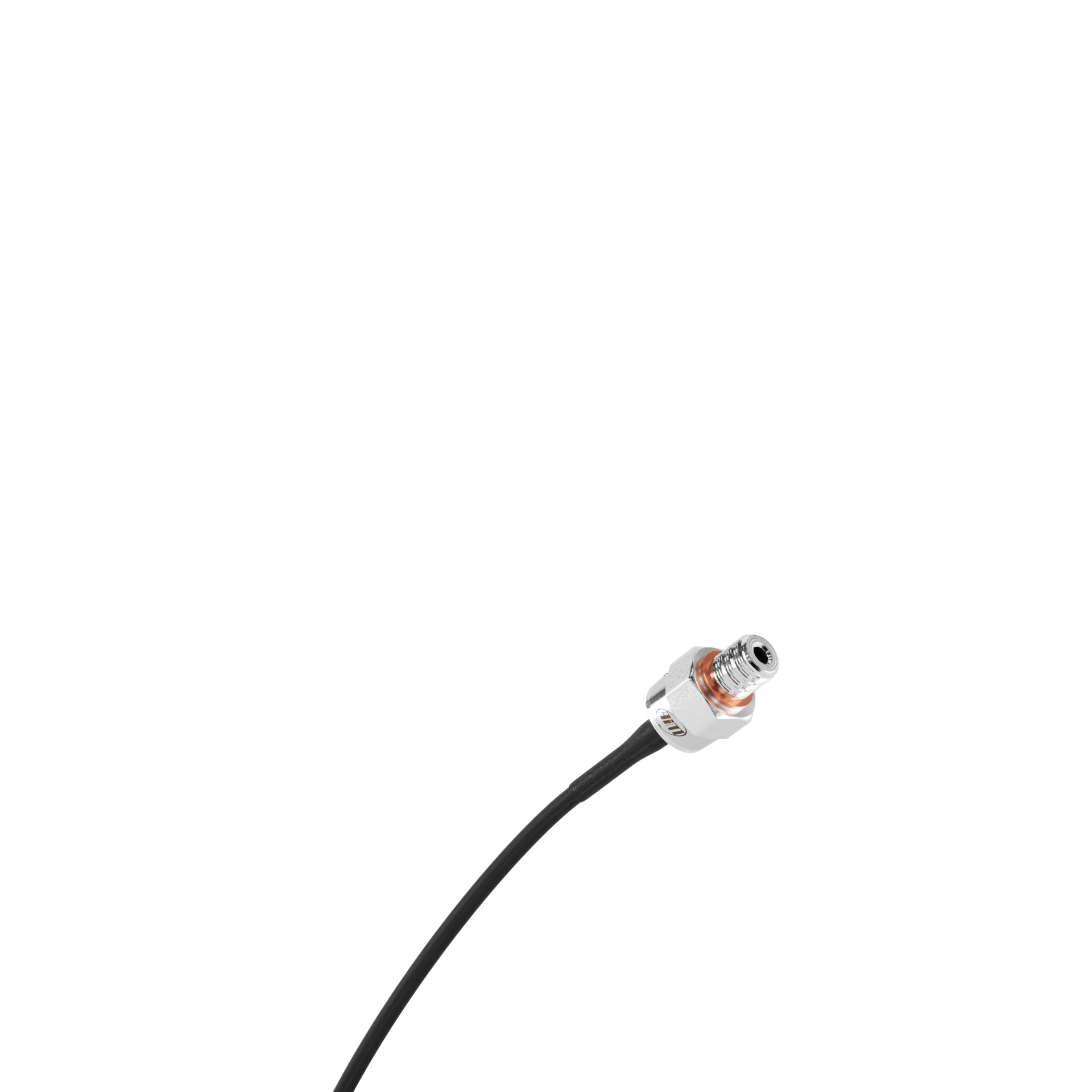

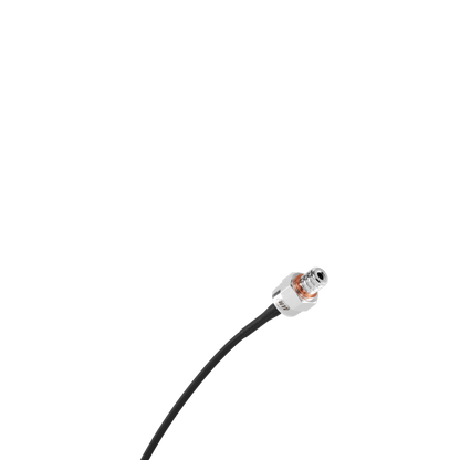

  • Supply: 8-16V
  • Consumption: < 10 mA
  • Temperature Working Range: -20°C to 135°C
  • Waterproof Rating: IP66
  • Housing: 316 stainless steel
  • Weight: 30g
  • Cable Length: 400mm
  • Thread: M10 or 3/8-24
