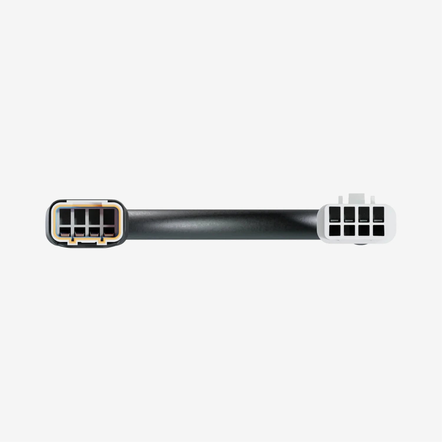

    The Aim Taipan universal extension cable has been specifically designed to allow connection of various ancillary systems to the Taipan ECU.
    UC bridge extension cable 2m or 4m length
    Handlebar Switch extension cable JST Connector - 04R-JWPF-VSLE-S
    Aim Taipan Accessories
    The Aim UC Bridge extension cable has been manufactured to connect the Taipan ECU to the UC bridge and/or the Handlebar Switch
    The patch lead is connected to the JST connector on the Taipan ECU and is available in two lengths 2m or 4m.

    Aim Taipan Universal Patch Lead
    • UC Bridge and/or Handlebar Switch extension cable
    • Length: 2m or 4m lengths available
    • Connects from Taipan ECU to UC Bridge and Handlebar Switch
    • JST Connector - 04R-JWPF-VSLE-S
    • Universal Patch Lead in 2m or 4m lengths available at checkout
