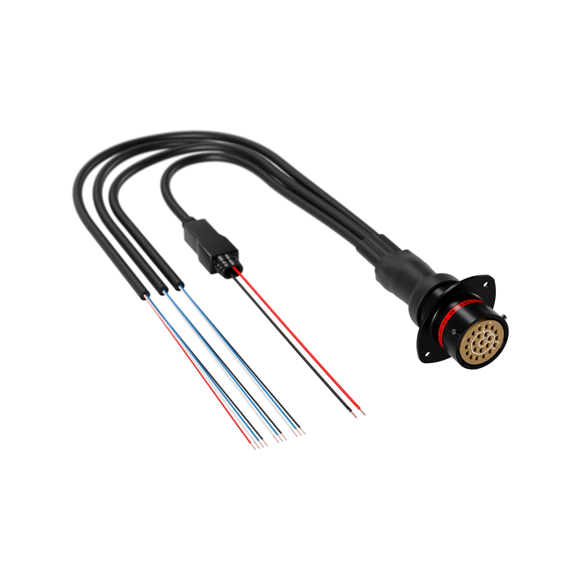

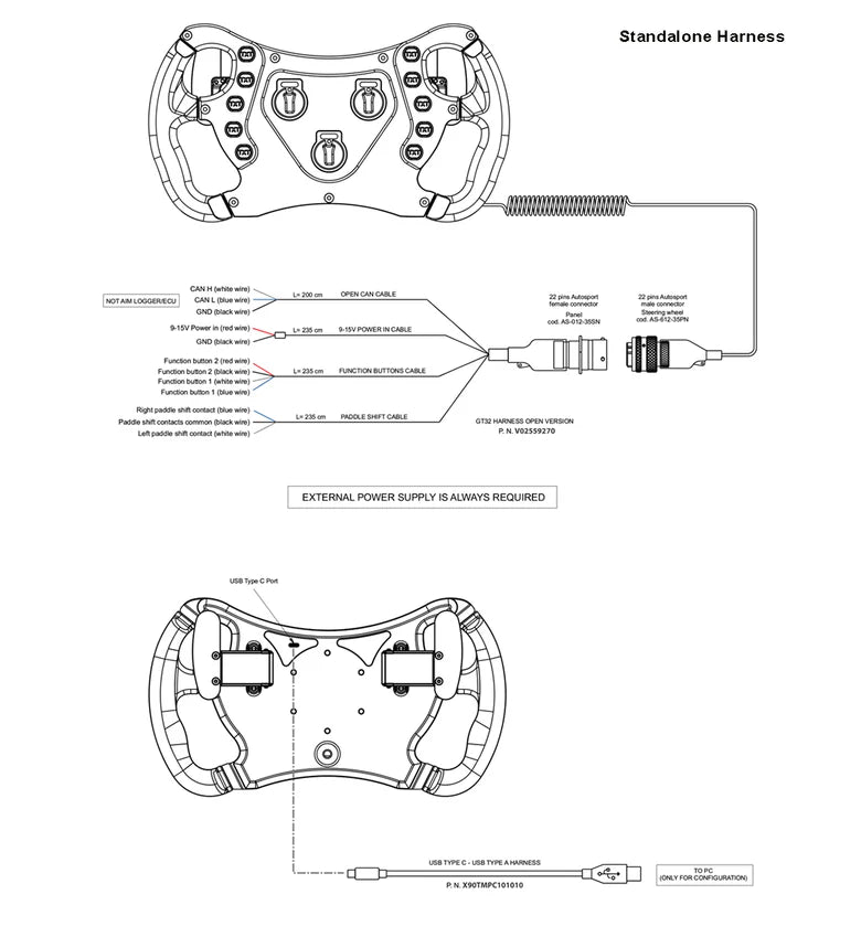

The open wiring harness has been designed for the GT32 steering wheel. Non-terminated wires allow for connection to non-Aim PDMs and ECUs, giving you flexibility to wire the steering wheel directly into a pre-existing setup.
Why Choose the Open Wiring Harness
Normally, Aim steering wheels are plug & play with Aim PDMs (Power Distribution Modules) and ECUs. But if you’re using a different brand like Motec, ECUMaster, Emtron, Life Racing, Haltech, Bosch, etc; those systems use different connectors and pinouts.
With an open harness, you can:
- Match inputs to your custom ECU or PDM
- Wire paddle shifters to your gearbox controller
- Wire clutch paddles for launch control
- Connect buttons and rotary switches for maps, radio, wipers, pit limiter, etc.
- Integrate CAN communication with non-Aim systems
