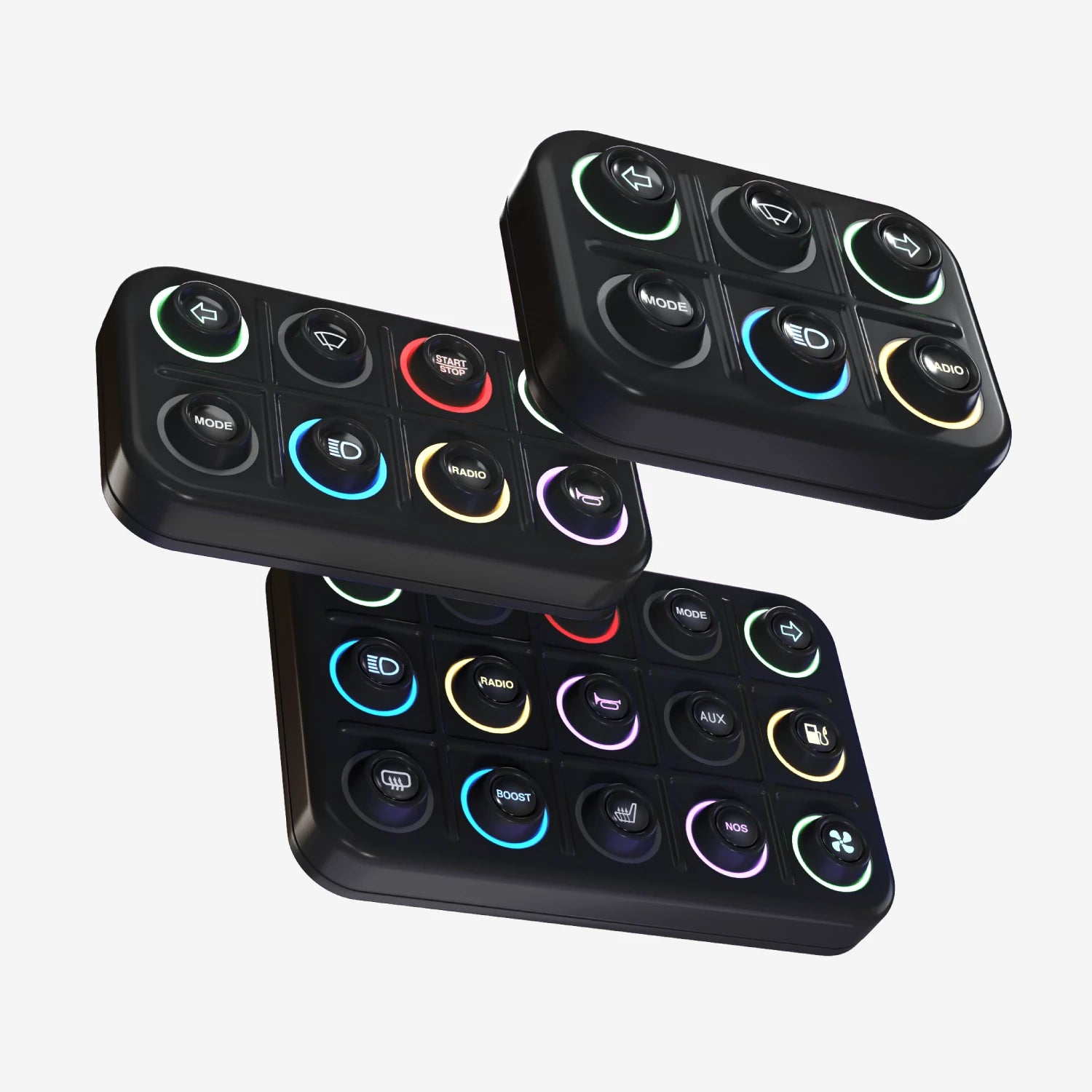

The Aim CAN Open Keypad, just like GPS09 or ACC 3, are available in an "Open Version". These keypads can be easily configured via USB with our free Race Studio 3 performance analysis software for transmitting the data via CAN to every external device. The Aim CAN Open Keypads are water and dust resistant and can be installed both inside and outside the cockpit. They are fully customisable and proposed with a wide range of interchangeable inserts.
This Open version can also be used as an Aim Expansion, without any issues or limitations. The keypads will enable you to have your very own selected buttons at your fingertips. Available in 6, 8 and 15-key.
Please Note: The keypads come blank with no inserts, of which we have an extensive range available.

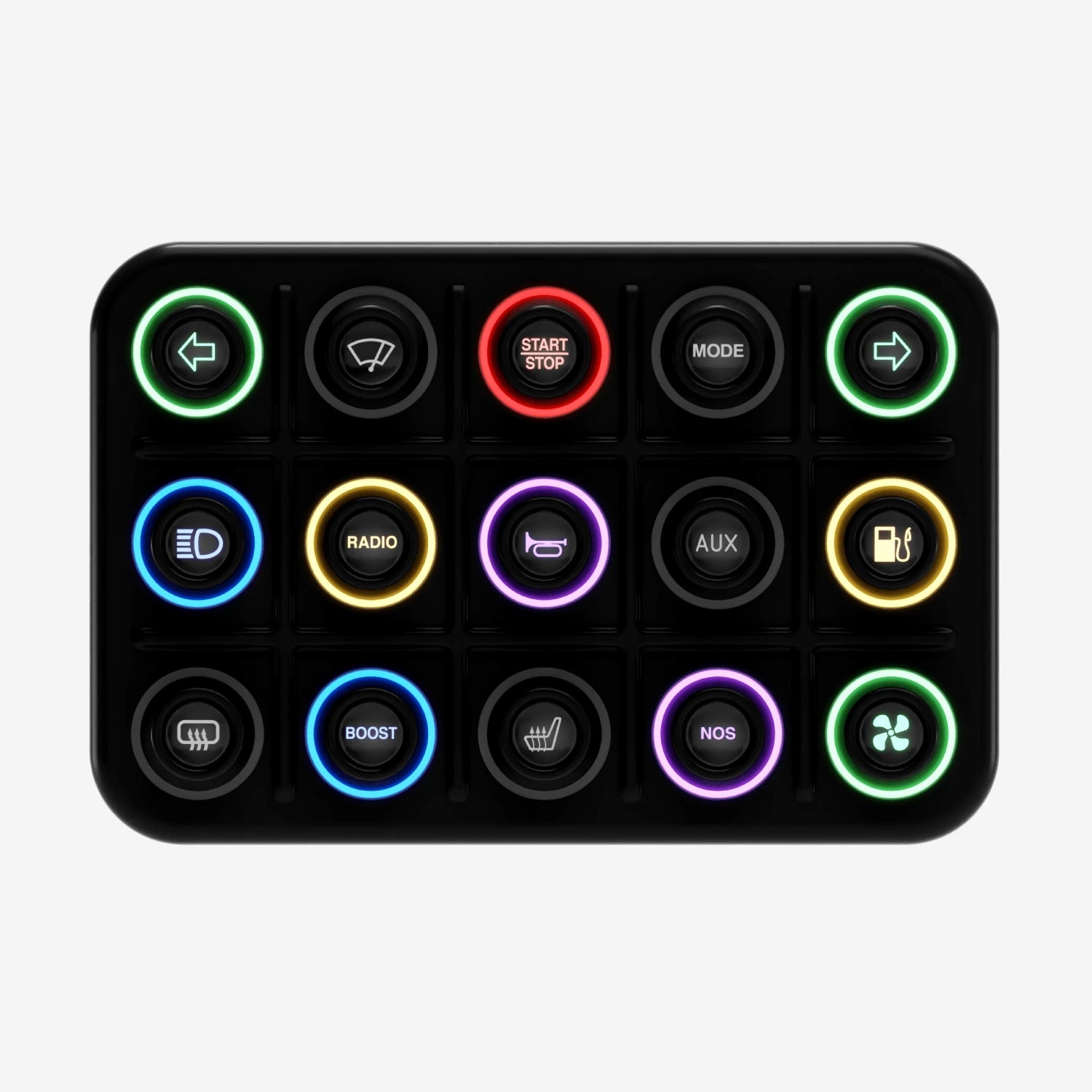

RGB LEDs
Every push button can be illuminated in 1 of 8 different colours, solid or blinking, according to the configuration defined by the user.

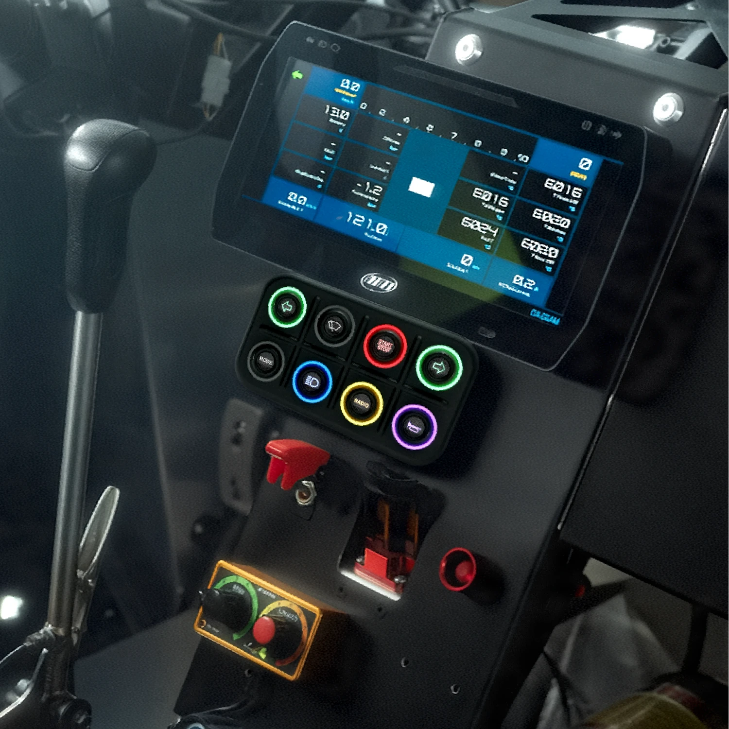

Aim CAN Open Keypads can be connected to the Aim master devices such as dashes, dash loggers and PDMs, and they can be freely configurable as an expansion using our free Race Studio 3 performance analysis software.
Additional Controls
In addition to the primary functionality of the buttons, Aim CAN Open Keypads buttons can be set up for managing any Aim display connected to the devices.

Explore endless possibilities with our wide range of laser-etched inserts to personalise your keypad – whether it's for lights, heating, fans, parking, and more. You can set these buttons to react based on parameters set by you; momentary, latching and toggle modes.
