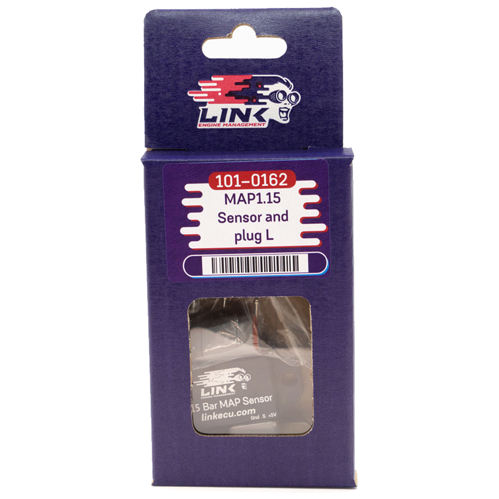

Link 1.15 Bar MAP Sensor
The Link 1.15 bar MAP sensor measures absolute pressures up to 1.15 bar, making it ideal for naturally aspirated engines. It can also accommodate positive intake pressures up to 0.15 bar (approximately 2 PSI), such as those caused by ram-air effects. The MAP sensor’s wiring pinout is clearly marked directly on the housing for easy installation.
Why Choose the Link 1.15 Bar MAP Sensor
The Link 1.15 bar MAP sensor comes supplied with a 3-pin Deutsch DTM connector kit and features a compact aluminium enclosure. The sensor can be mounted via 2 bolt holes and should be positioned higher than the intake manifold port to which the hose connects.
The MAP sensor provides very high-resolution readings, making it perfect for naturally aspirated applications, with mechanical connection via a 4mm (3/16″) hose nipple. When using Link G4, G4+, or G4X ECUs, select ‘Link 1.15 Bar’ as the MAP sensor type in PC Link for proper calibration.
  • Includes 3-pin Deutsch DTM connector kit
  • Easy to mount via 2 bolt holes
  • Note: The sensor should be mounted higher than the intake manifold port that the hose connects to
  • Compact aluminium enclosure
  • High-resolution readings for naturally aspirated engines
  • Mechanical connection via 4mm (3/16″) hose connector nipple
SKU: MAP115
