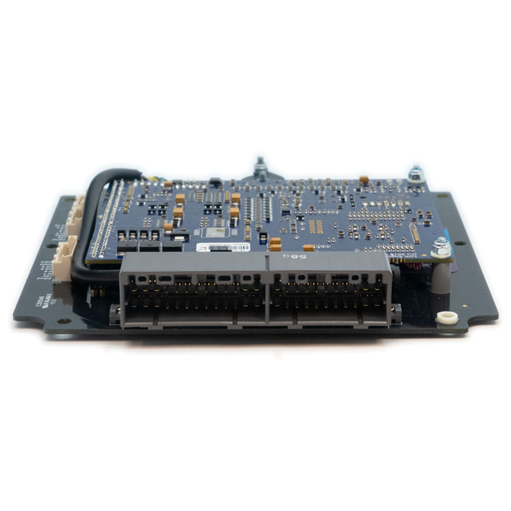

    Designed for the MX5 B6ZE(RS) / BP 1.8L engine.
    Includes onboard 4 bar or 7 bar MAP sensor
    Knock control not available on this ECU.
    Most factory features are supported
    Suitable Applications:
    1600 1989-1997 NA MX5
    1800 1989-1997 NA MX5
    1800 323 GTX
    1800 323 GTR
    Please note: This ECU does not fit NB, NC, ND models. This unit is only suitable for the 2 plug ECU and not the later 3 plug models).
    Sequential fuel delivery
    OEM idle hardware supported
    CAN port
    USB tuning cable included
    Staged injection
    Knock with "windowing"

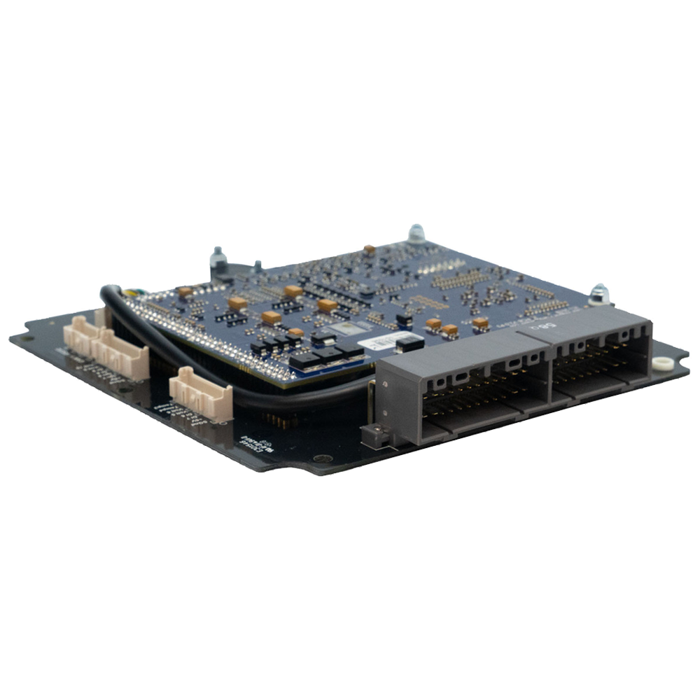

    I/O Expansion Options:
    Expansion connector 1
    SGnd Sensor Ground Only
    +5V Low Current +5V Supply
    DI 7 Digital Input
    DI 6 Digital Input
    Volt 5 Analog 0-5V input
    Volt 6 Analog 0-5V input
    Temp4 Temperature sensor input
    Temp3 Temperature sensor input
    Expansion connector 2
    Ign 7 Auxiliary Output
    Ign 8 Auxiliary Output
    DI 8 Digital Input
    DI 9 Digital Input
    Volt 9 Analog 0-5V input
    Volt 10 Analog 0-5V input
