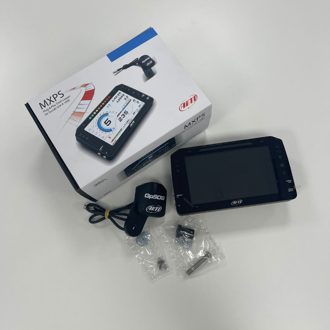

The Aim MXPS is a state-of-the-art plug & play dash logger designed specifically for Suzuki GSX-R1000 and GSX-R1000R models from 2017 to 2022. This MXPS’ advanced system seamlessly integrates with your Suzuki dash, providing comprehensive data logging and a customisable display to enhance your riding experience.

The Aim MXPS Suzuki GSX-R1000 Plug & Play Dash Logger is a high-performance piece of motorsport equipment that offers an advanced and upgraded data logging experience, whilst having a range of additional features that make it easier to expand your system.
The MXPS Dash Logger has delta times shown, letting you compare your current lap with others to see exactly where you are gaining or losing seconds. It has customisable LEDs as well as a high contrast TFT display for optimised personalisation and ease in seeing your data in any condition.
The GPS module is also very accurate to 25Hz, allowing for advanced tracking capabilities and data collection. Ultimately, data collection is upgraded massively with the MXPS Dash Logger, with multiple motorcycle parameters being monitored and recorded for performance analysis.
