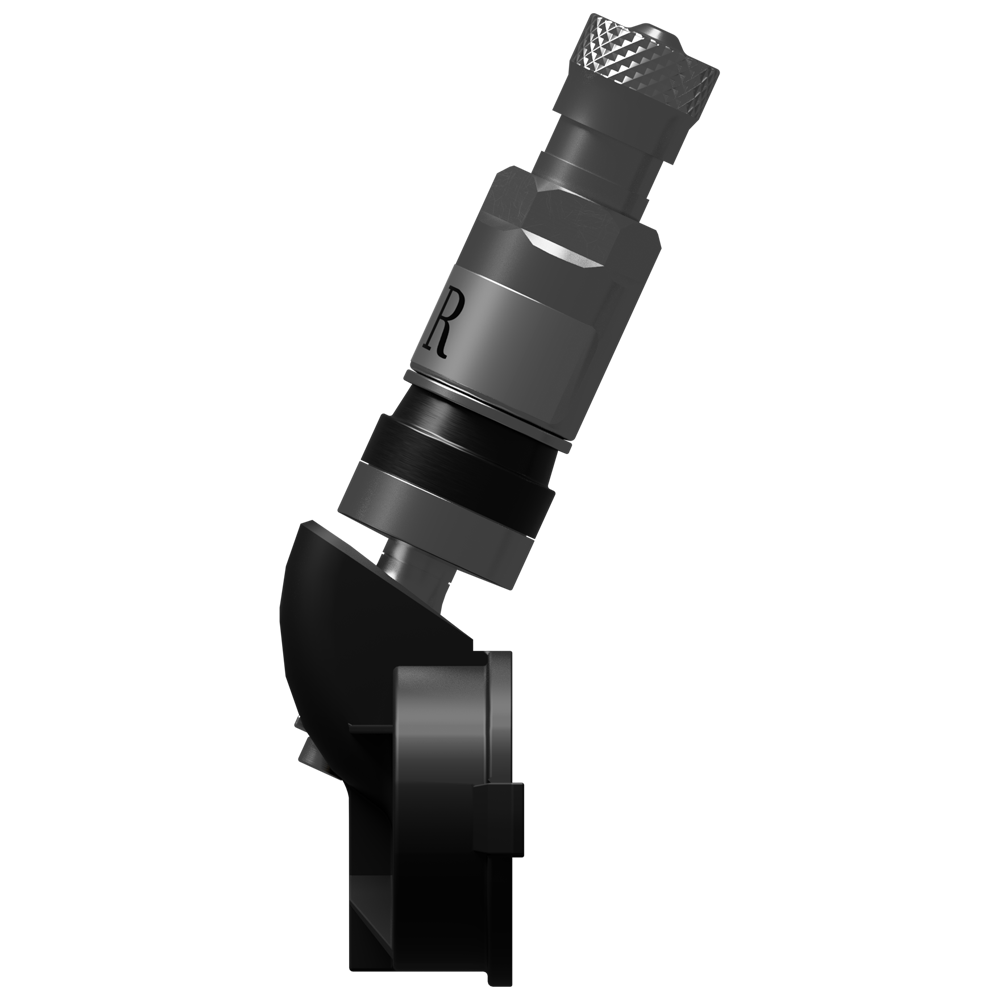

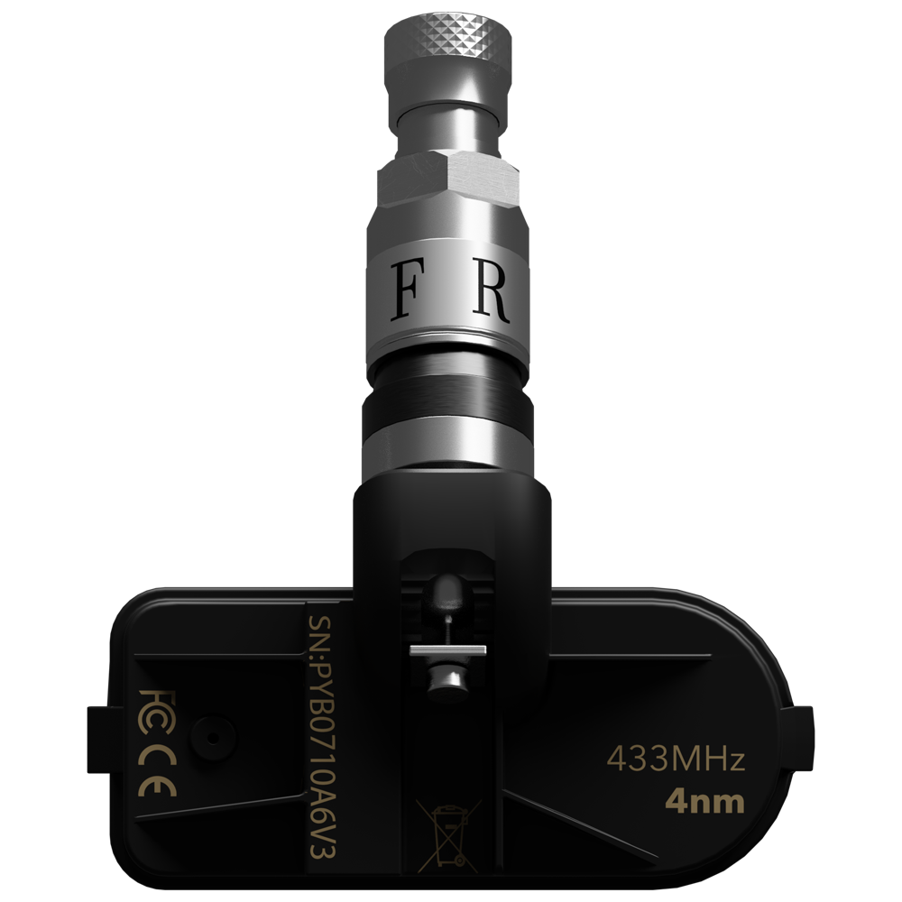

The tyre pressure monitoring system (TPMS) sensor has been designed for use with the Aim tyre pressure monitoring system. It is ideal if you want to add a spare set of wheels for testing purposes or mid-race tyre changes.
The whole purpose of using a TPMS single sensor within each tyre is to monitor specific pressure levels, such as temperature readings. All the data is sent to the monitoring system where it can be analysed and interpreted.
With this technology, each single sensor has its own serial number, and this is how the system distinguishes between itself and other systems on other vehicles. Changes can then be made to improve the performance of your vehicle on track.
TPMS Sensor Features
Spare sensors can be programmed with any of the serial numbers that have been allocated to the receiver. Sensor IDs of 2 unmounted wheels can be swapped. Sensors are supplied with an 11mm valve stem.
