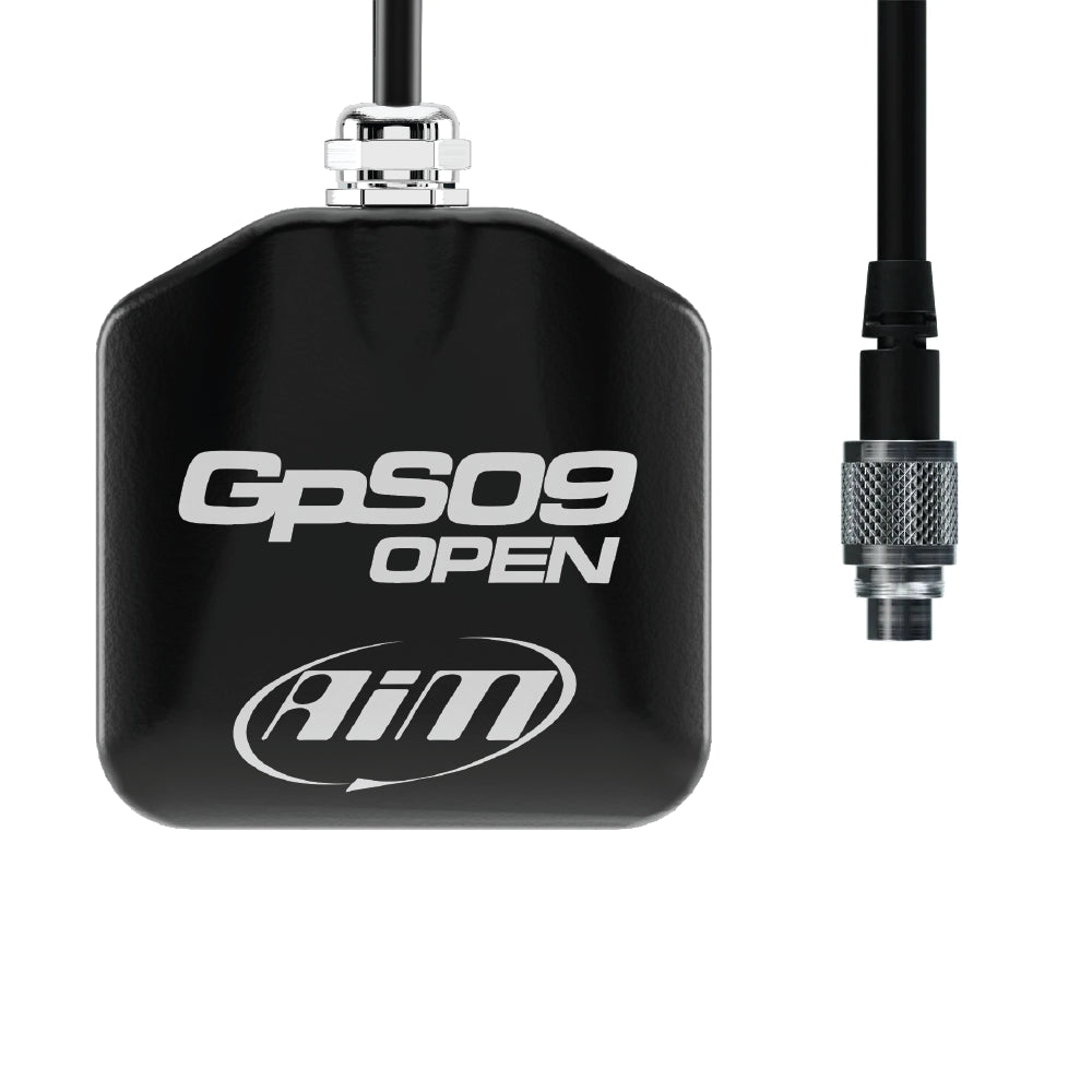

GPS09 Open activates instant lap tracking, recognising start/finish lines and details effortlessly. Please Note: The GPS09 Open has no inertial platform.
Why Choose the Aim GPS09 Open Module
The Aim GPS09 Open Module guarantees precision and reliability, working with almost 20 satellites to improve its performance.
With an average of less than half a metre tolerance, the absolute precision of the GPS Open Module determines exact vehicle position. The satellite signal uses rapidly locked moments after switching on the device, and there is no risk of missing signals due to noise or interference in the system.

  • Open Dimensions: 53.2 x 53.8 x 19.7mm
  • Open Weight: 60.5g
  • Open Roof Version Dimensions: 53.2 x 53.8 x 37.2mm
  • Open Roof Version Weight: 100g

Installing the Aim GPS09 Open Module involves mounting the antenna on a metal-free, unobstructed surface like the roof or top of the dash for maximum satellite visibility, then connecting the CAN (High/Low) or RS232 wires to your device.
