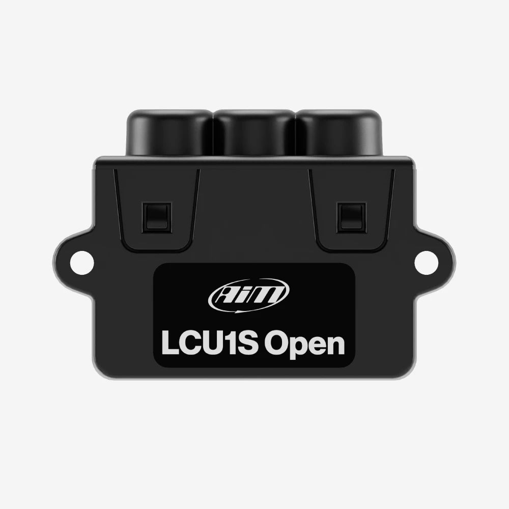

The Aim LCU-One S Open gives you complete control of your engine while offering unrivalled flexibility in motorsport data integration. Unlike the standard version, the Open version is designed to connect seamlessly with a wide range of networks outside of the Aim Technologies ecosystem, making it the perfect choice for teams and drivers running mixed systems.
Why Choose the Aim LCU-One S Open
The Aim LCU-One S Open Lambda Controller can detect an accurate Lambda value from 0.65 to 1.6, delivering precise and reliable measurements for engine tuning. By analysing the remaining oxygen in the exhaust gases, it highlights excess or a lack of oxygen in the carburetion process, giving essential insights for both 2-stroke and 4-stroke engines.

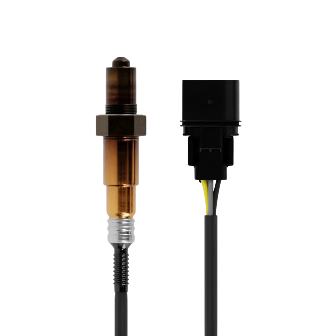

Bosch LSU 4.9 Probe Wideand Lambda Sensor
Bosch LSU 4.9 Probe
The Bosch LSU 4.9 is a wideband lambda (AFR) sensor designed to measure oxygen content in the exhaust gases of gasoline or diesel engines.
It is a planar ZrO₂ dual-cell limiting current sensor with an integrated heater and provides a monotonic output signal from lambda 0.65 to air, allowing it to be used as a universal sensor for lambda one and other ranges.
The connector module includes a trimming resistor that defines the sensor’s characteristic, and the unit is known for its robust design and high Bosch production quality standards. It must be installed where exhaust gas is representative and within the permissible temperature range, ideally mounted vertically with the wiring upwards, away from the exhaust outlet and leaks, protected from condensation, and free from paint, wax, or other treatments, using only the recommended grease on the threads.

With its compact, waterproof (IP67) design, the LCU-One S Open is engineered for the toughest racing environments - from cars and motorcycles to motocross and karting. It also supports multiple fuels, including petrol, diesel, and alternative fuels, giving it the versatility needed across modern motorsport.
  • Sensor Compatibility: Bosch LSU 4.9
  • Power Supply Voltage: 9-15V
  • Power Supply Current: 50mA + sensor heater current typical 750mA up to 2A on cold sensor
  • Reaction Time: Less than 10 msec
  • Materials: Latigloss 57
  • Dimensions: 43.4 x 30 x 18.4mm
  • Weight: 70g
  • Waterproof: IP67

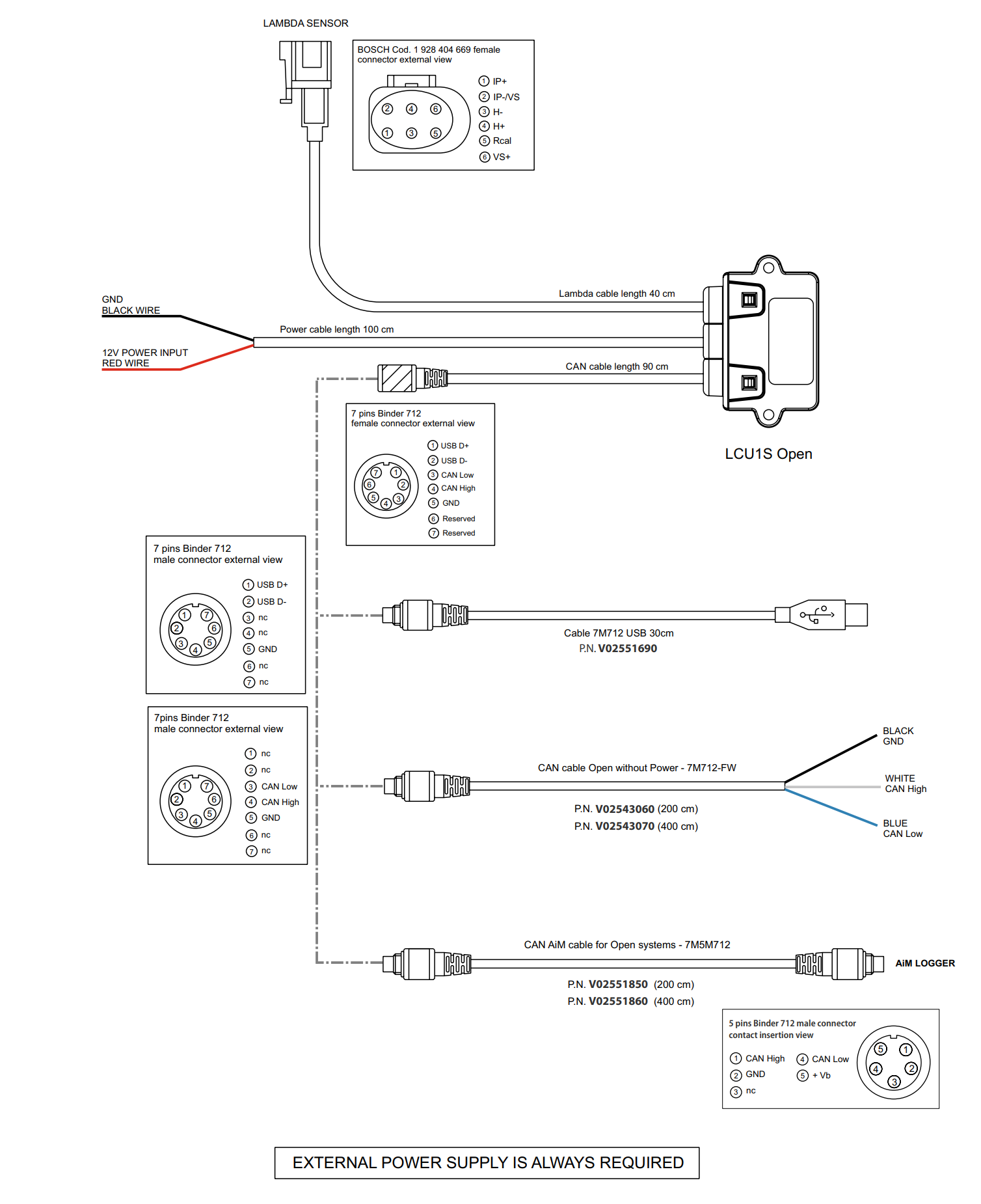

Connections

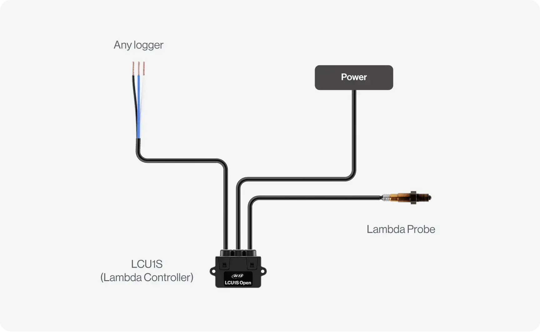

LCU1S Open Lambda Controller connection example with any logger, power and Lambda Probe/Sensor

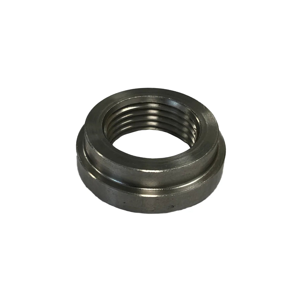

  • Aim LCU-One Lambda Controller Replacement Weld-On Bung
    Thread Iron Ring
