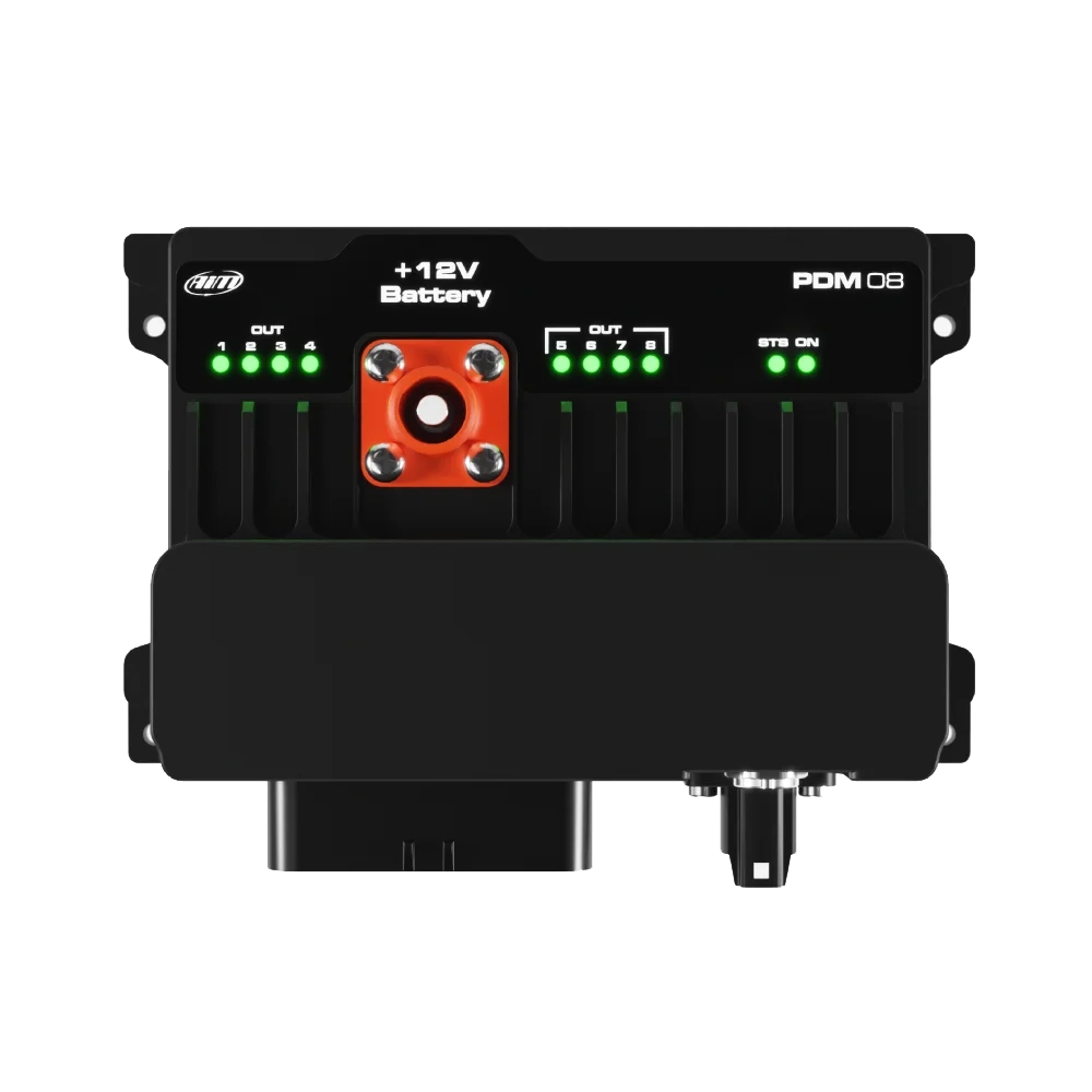

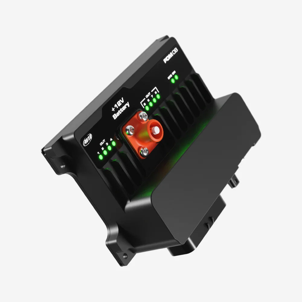

The Aim PDM08 is an 8-channel advanced power distribution module designed to power a multitude of vehicle circuits, removing the need for traditional fuse boxes and relays.
It allows for a simplified wiring harness with increased reliability and control functions.
Why Choose the PDM08
The PDM08 is available on its own or with a choice of 5", 6" or 10" dash displays. It also capable of receiving data from the vehicles ECU and even comes with an optional data logger and GPS module for lap timing and track mapping.
With a total continuous max current of 100A, each of the outputs provides feedback to the data logger to provide vital information such as open circuits, short circuits, high/low voltage, the number of fault retires and the time between the reties is user definable. All outputs can be configured as PWM's for a soft start/stop. All of the PDM circuits can be set up and monitored via the Race Studio 3 software.

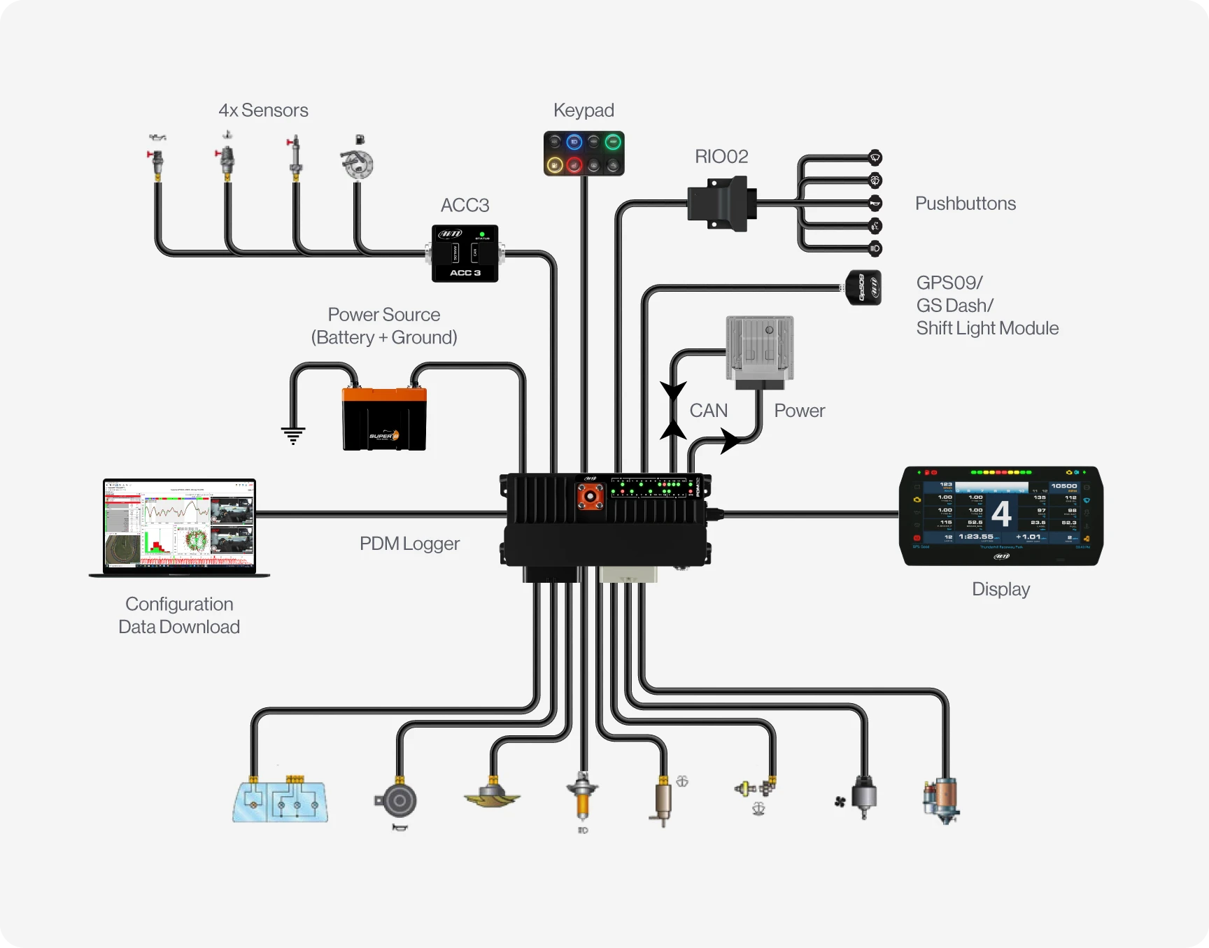

The PDM08 can receive and record data from the following sources:
  • Digital/analogue inputs
  • Internal 9-axis EMU
  • GPS: Lap time and position
  • Expansion Modules
  • Push buttons from RIO02 (Remote Input Output module) or any commercial CAN keypad
  • PDM Outputs: Currents and status of each channel individually
  • Other user-defined math channels

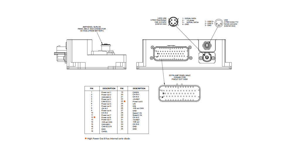

Power Outputs
  • 1 with a series diode rated up to 20A
  • 1 rated up to 25A
  • 6 rated up to 15A
  • Protected For: over-voltage, under-voltage, over-current, over-temperature
  • Total Max Current: 100A

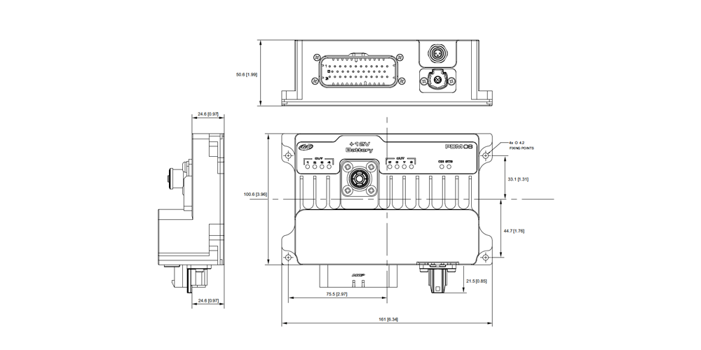

  • Dimensions: 161 x 100.6 x 50.6mm
  • Weight: 500g
