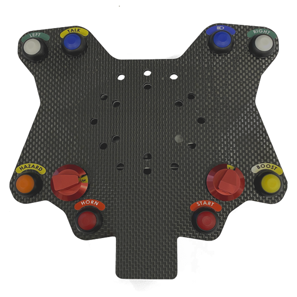

Race faster, harder and safer with push button controls at your fingertips. The Carbon 10 Button Wireless Motorsport Steering Wheel Plate combines minimum driver distraction with maximum ease of use.
Please Note: This product is not manufactured by Aim and is sourced from a third-party supplier.
Why Choose the 10 Button Steering Wheel Plate

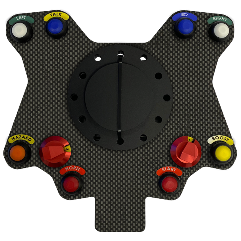

The 10-channel wireless system allows you to have push button controls at your fingertips, whether you have a detachable steering wheel or would like to avoid the need for an unreliable coiled wire connection from your steering wheel to the dashboard. The plate has a carbon finish for superior durability at a fraction of the weight of other systems.
Digital Push Buttons & Analogue Inputs
Wirelessly implemented, the in-vehicle commands are executed in a fraction of the time with 8 digital push buttons and two 12-position analogue inputs, ideal for features such as traction control settings or for engine mapping.
The steering wheel plate is lightweight and integrates with most CAN devices, including dashboards, ECUs, PDUs and dataloggers, and has been tested to withstand the harshest EMI that can be generated within your car.

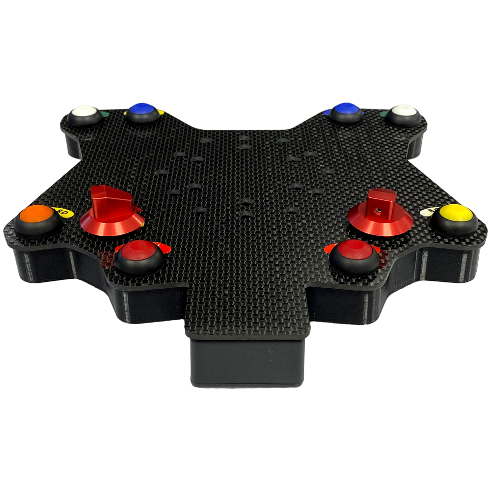

Button Plate Front
  • Matt black, carbon
  • Dimensions: 176 x 154mm

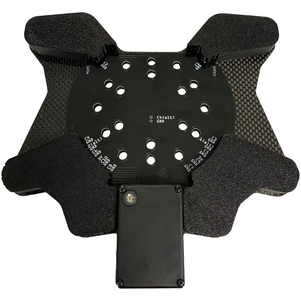

Battery
  • Housing: ABS-UL94-VO
  • Dimensions: 54 x 38 x 23mm external
  • CR2 lithium battery
  • 50,000 miles of active use
  • Push Buttons: IP67 waterproof
  • Assembly: 10-channel, 285g
