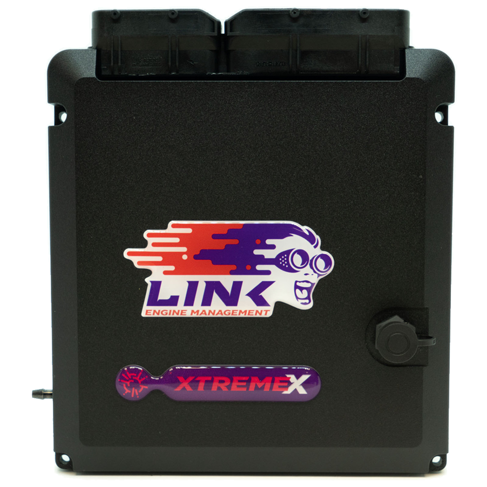

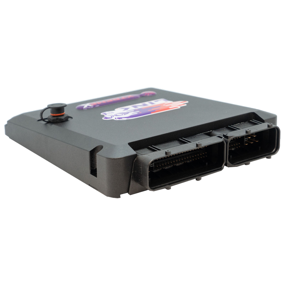

    Easy to install. Affordable. Reliable
    This ECU comes in its own enclosure, while the installation is a breeze with no alteration of the factory wiring loom required for the models listed below.
    The N350X ECU is designed to suit the VQ35DE engine.
    This ECU works with manual AND automatic transmissions.
    ECU includes an onboard 4 bar or 7 bar MAP sensor.
    Check the features tab for I/O expansion options
    Highly recommended to fit an IAT sensor.
    Suitable Applications:
    2002 to 2006 Nissan 350Z (Fairlady Z Z33)
    2003 to 2006 Nissan Skyline V35
    2003 to 2006 Infinity G35
    PlugIn Key Features:
    Sequential fuel delivery
    OEM idle hardware supported
    CAN port
    USB tuning cable included
    Staged injection
    Knock with "windowing"
