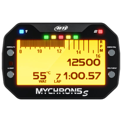

Advanced Display
The MyChron 5 2T features a wide graphical display, ensuring excellent readability. Brightness and contrast are automatically adjusted to maintain ideal visibility in all lighting conditions, and this allows drivers to clearly monitor their best vs current sector times.
LED & Alarms System
5 RGB shift lights can be customised to display lap times or function as traditional shift indicators. The 2 RGB alarm LEDs provide real time engine monitoring of vehicle temperature, ensuring the kart operates within optimal parameters and preventing overheating or potential damage.
