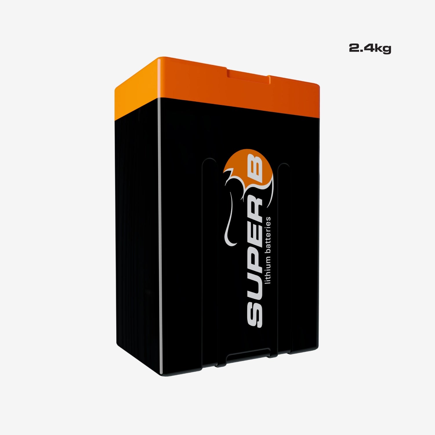

The Super B Andrena 12V15Ah Lithium Battery delivers lightweight, high-performance power designed specifically for motorsport and high-demand 12V systems. The Andrena 12V15Ah battery equals a lead-acid battery of 40 to 60Ah, provided the alternator’s maximum current doesn’t exceed the battery’s maximum charge current of 52A.
Lightweight Power
With a weight of only 2.4kg/5.4lbs, the Super B Andrena 12V15Ah Lithium Battery saves up to 80% in weight in comparison to traditional lead-acid batteries and is only 1/3 of the size of a conventional battery. This improves not only the performance of your vehicle but also helps to increase the fuel economy.
The power battery offers a high level of power, fast charging and a long, maintenance-free service life. It also has a stable and flat discharge, which means you have over 80% of the batteries capacity available, and you can leave your vehicle unattended for a much longer period compared to a lead-acid battery.
Safe & Reliable
Based on lithium iron phosphate (LiFePO4) technology, the Super B Andrena has the safest lithium technology available today. On top of that, it offers a nominal capacity of 15Ah and 192Wh of energy, with a bespoke casing and electronics that further increase safety and durability.
With ultra-low self-discharge (< 3% per month) and the durability of LiFePO4 technology, the Super B Andrena remains ready even after long periods of inactivity. Ideal for motorsport, marine, or performance-mobile applications, this battery offers fast recovery, reliable starting power, and the peace of mind that comes with lithium technology.
3-Year Warranty
All Super B batteries come with a 3-year warranty, offering the best peace of mind. It is the benefit of years of continuous engineering improvement and proven experience with all batteries in the harshest environments.

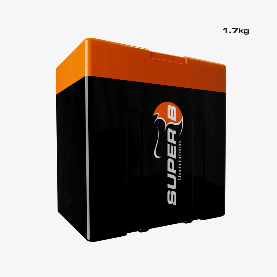

  • Dimensions: 120 x 82 x 124mm
  • Weight: 1.7kg

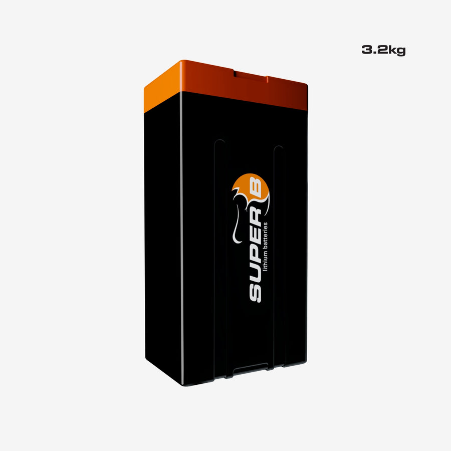

  • Dimensions: 120 x 82 x 238mm
  • Weight: 3.2kg
