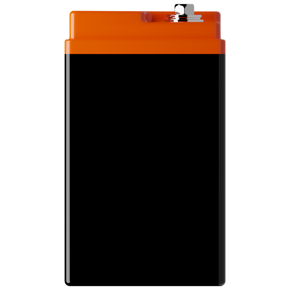

The Super B Andrena 12V15Ah-SC Lithium Battery is compact in size, measuring in at 249 x 96 x 141mm and weighing 2.9kg, so it is perfect for vehicles that need a smaller power source with high energy capacity.
At only 1/3 of the size of traditional lead-acid batteries, the Super B Andrena 12V15Ah-SC Lithium Battery not only simplifies maintenance and installation in tight engine bays, but it also improves fuel economy and performance, delivering sharper handling, quicker acceleration and less strain on suspension components.

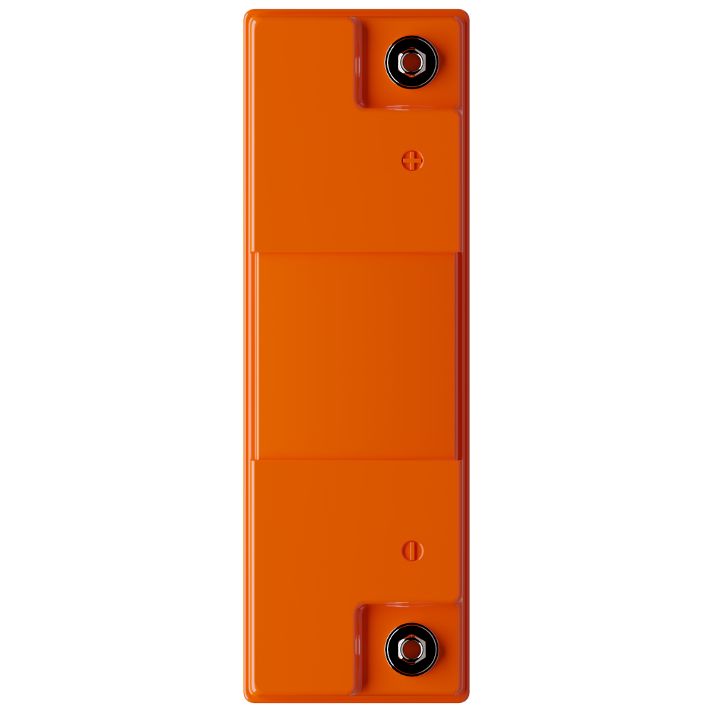

  • Dimensions (LxWxH): 249 x 96 x 141mm / 9.80” x 3.78” x 5.55”
  • Weight: 2.9kg / 6.4lbs
  • Case Material: PC - ABS
  • Ingress Protection: IP69
  • EAN-13: 8718531360068
  • Battery Designation: 4IFpR27/66-6
  • Charge Method: CCCV
  • Max Charge Current: 52A
  • Discharge Current Continuous: 240A
  • Discharge Pulse Current (1 sec): 708A (47C)
