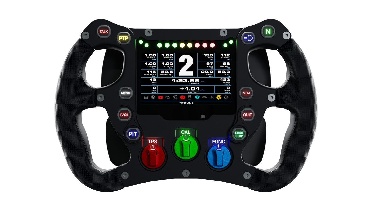

The all-new AiM Formula Steering Wheel 4 280 is our most advanced steering wheel to date. Get a closer look at our brand new design of display and functions.
The Formula Steering Wheel 4 is available in four unique sizes and incorporates an internal data logger with complete configuration.
4.3" TFT display Over 2,000 ECU protocols
2 CAN available Additional CAN expansions
Internal data logger Dedicated RGB LED buttons
2 direct contact buttons 3 configurable rotary switches
Removable handgrips Configurable keys: momentary, toggle, multi-status
Optional shift & clutch paddles Easy configuration with Race Studio 3
AiM Formula Steering Wheel 4 280 with Internal Data Logger
The New AiM Formula Steering Wheel 280 is used for Formula cars and Sports prototypes. The internal data Logger is fully configurable and suitable for many different Motorsports. It has been designed to acquire and display data coming from the ECU with over 2,000 fully compatible ECU protocols. The New AiM Formula Steering Wheel 280 is an excellent choice for compact cockpit installations where space is at a premium.
The Formula steering wheel 4 280 has ten push buttons and three rotary switches, all backlit with RGB LEDs.
The Formula Wheel has an internal data logger with complete configuration, removable grips, rotary switches and a long list of fully compatible ECU and CAN connectivity options.
Our formula wheels come in a range of sizes. The difference between the Formula Steering Wheel 4 270 and 280 is the overall size of the wheel. The formula steering wheel 280 is 10mm larger to meet every driver's requirements.
The Formula Steering Wheel 4 280 is also compatible with our PDM32 by talking through a CAN network.
Connecting the AiM Formula Steering Wheel 280 to your ECU is simple. You can sample dozens of channels straight from the vehicle ECU. This is usually the quickest and easiest setup, needing only a cable connection to the ECU instead of multiple connections and analogue sensors. The sampled data will depend on your actual ECU but typically includes RPM, engine load, throttle position (TPS), oil, air, water temperature, oil pressure, battery voltage, speed, gear, and lambda value (air/fuel ratio). The list of available ECU drivers is constantly updated and upgraded and includes approximately 1000+ different ECUs.
The Formula Steering Wheel 4 280 has a high contrast 4.3" TFT display that is fully configurable and fully sunlight viewable. With the added ambient light sensor, the display stays straightforward to read. The wheel has eight visible shift lights and four-alarm RGB LEDs. The display is a high-quality solution for a formula wheel delivering clear, precise, and easy-to-read information to the driver.
  • Display: 4.3" TFT
  • Contrast: 800:1
  • Ambient light sensor: Yes
  • Alarm display icons: Yes, freely configurable
  • Shift lights: 8 configurable RGB LEDs
  • CAN connections: 3
  • ECU connection: CAN
  • ECU compatibility: 1,000+ industry-leading ECUs
  • Expansion CAN connection: GPS Module, Channel Expansion, TC Hub, Lambda Controller, SmartyCam HD, RIO02, GS Dash, Memory Module
  • Internal memory: 4 GB
  • Body: Anodized Aluminium
  • Pushbuttons: 10 pushbuttons + 3 rotary switches (all with RGB backlights)
  • 1 Deutsch Autosport 22 pin male connector
  • Weight: 2,400g
  • Power consumption: 500 mA
  • Waterproof: IP65
