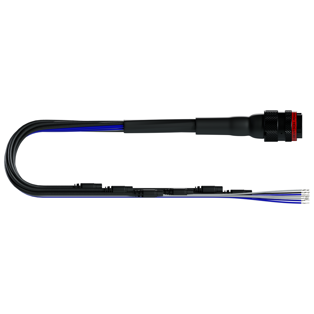

The AiM EVO5 22 pin Deutsch harness has been designed as an optional harness to add extra data to your device.
Suitable for EVO5 | Optional 22 harness |
4 analogue channels | |
22 pin Harness for EVO5
The AiM 90° 22 pin Deutsch harness for the EVO5 is an optional harness to add extra channels (sensors) and advanced functions to your device.
Several of the advanced functions rely on this harness, which is not included with the 37 pin harness which comes as standard with the EVO5.
The AiM 22 pins Deutsch harness functions are listed below:
Analogue sensor channels 5, 6, 7, 8
Digital wheel speed sensor inputs 2, 3, 4
Digital 12V outputs 1, 2
RS232TX
The standard 37 pin harness that comes with the EVO5 allows 4 inputs. If you would like to add more inputs to your race data then add this optional harness.
Adding analogue sensors greater than 4 - The standard harness will allow 4 analog channels (sensors) - (1) Water Temperature, (2) Oil Temperature, (3) Oil Pressure, (4) Brake Pressure.
Using the 22 pin harness you can add four more analogue channels (sensors) (5) Steering Angle, (6) Throttle Position, (7) Gear Box, (8) Differential Temperature.
Please Note: If you wish to add extra race data then you will need the 22 pin Deutsch harness. This will add four more analogue channels (sensors). Available in the Accessories Tab.
