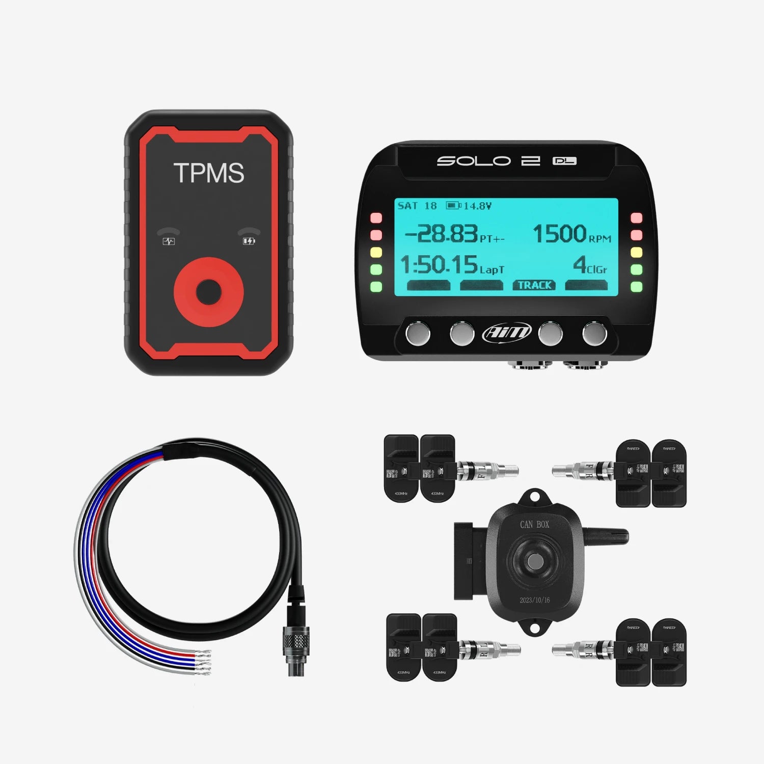

Tyre Pressure Monitoring Solo 2 DL Kit
The Aim Tyre Pressure Monitoring System (TPMS) paired with the Solo 2 DL allows you to get the most precise lap times, accurate data on tyre pressures throughout your race, and alerts to changes in tyre pressure.

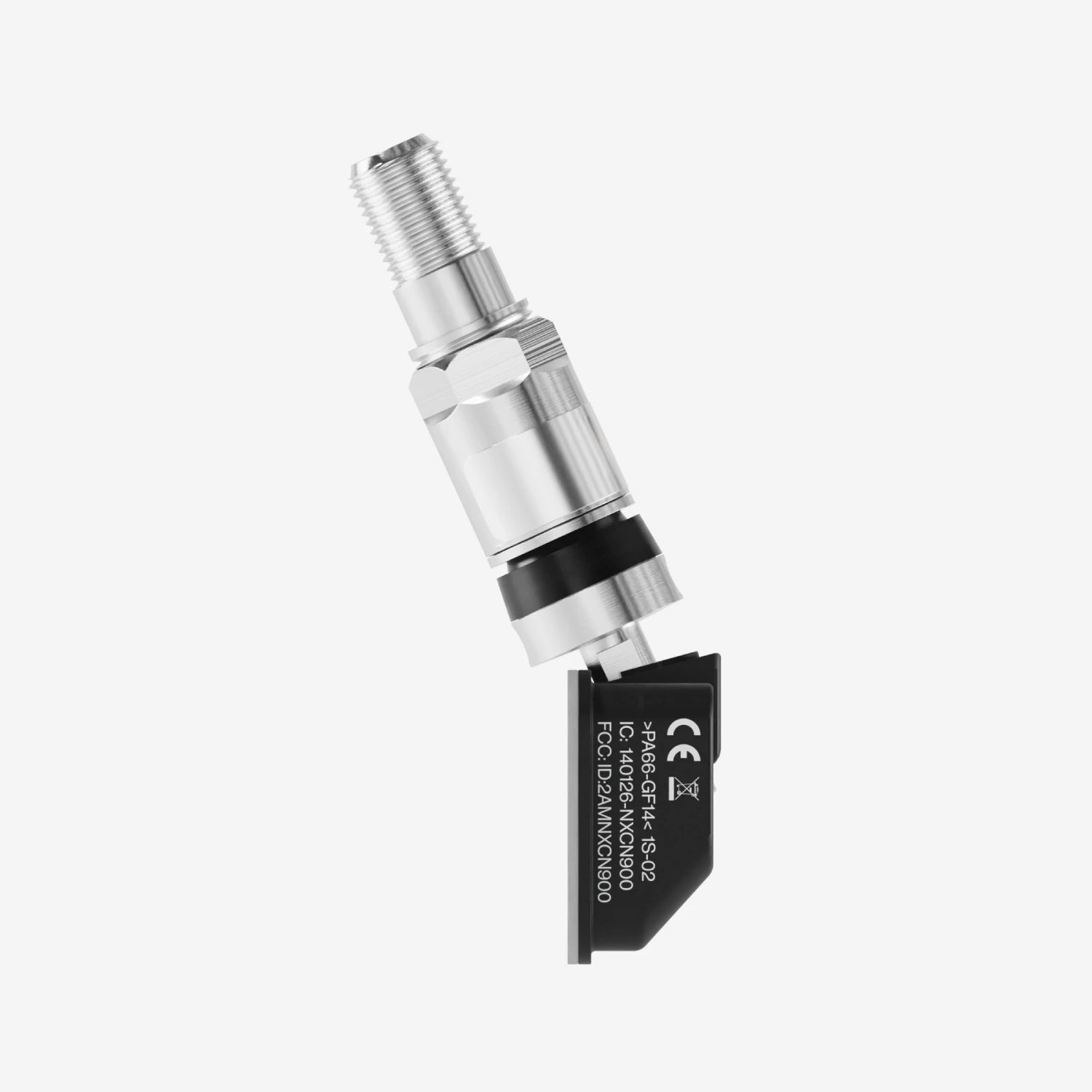

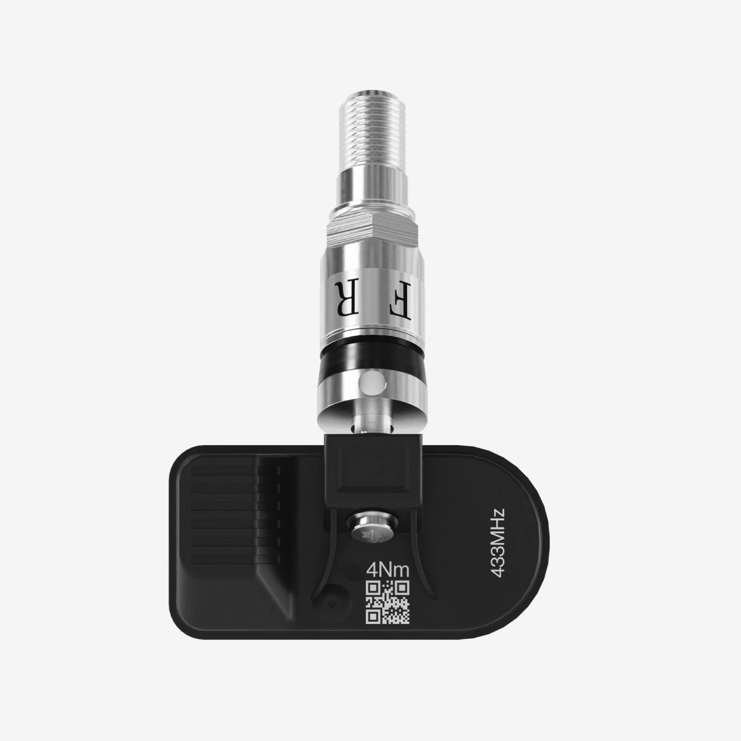

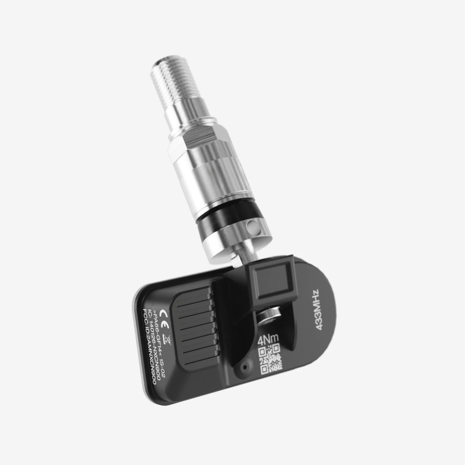

The TPMS utilises robust sensors for each wheel, with high-resolution sensors that measure tyre pressure and temperature, transmitting securely coded data to the onboard receiver.

TPMS kit with Solo 2 DL

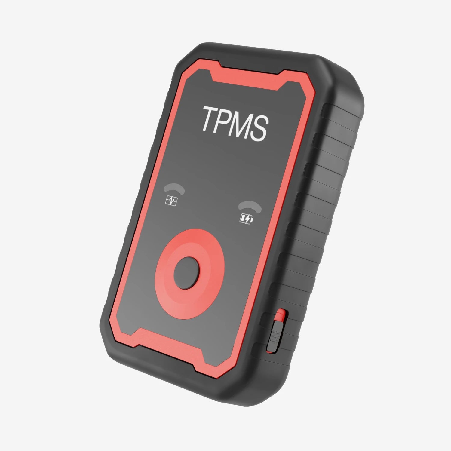

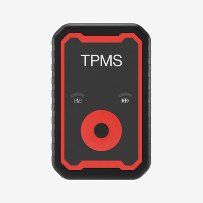

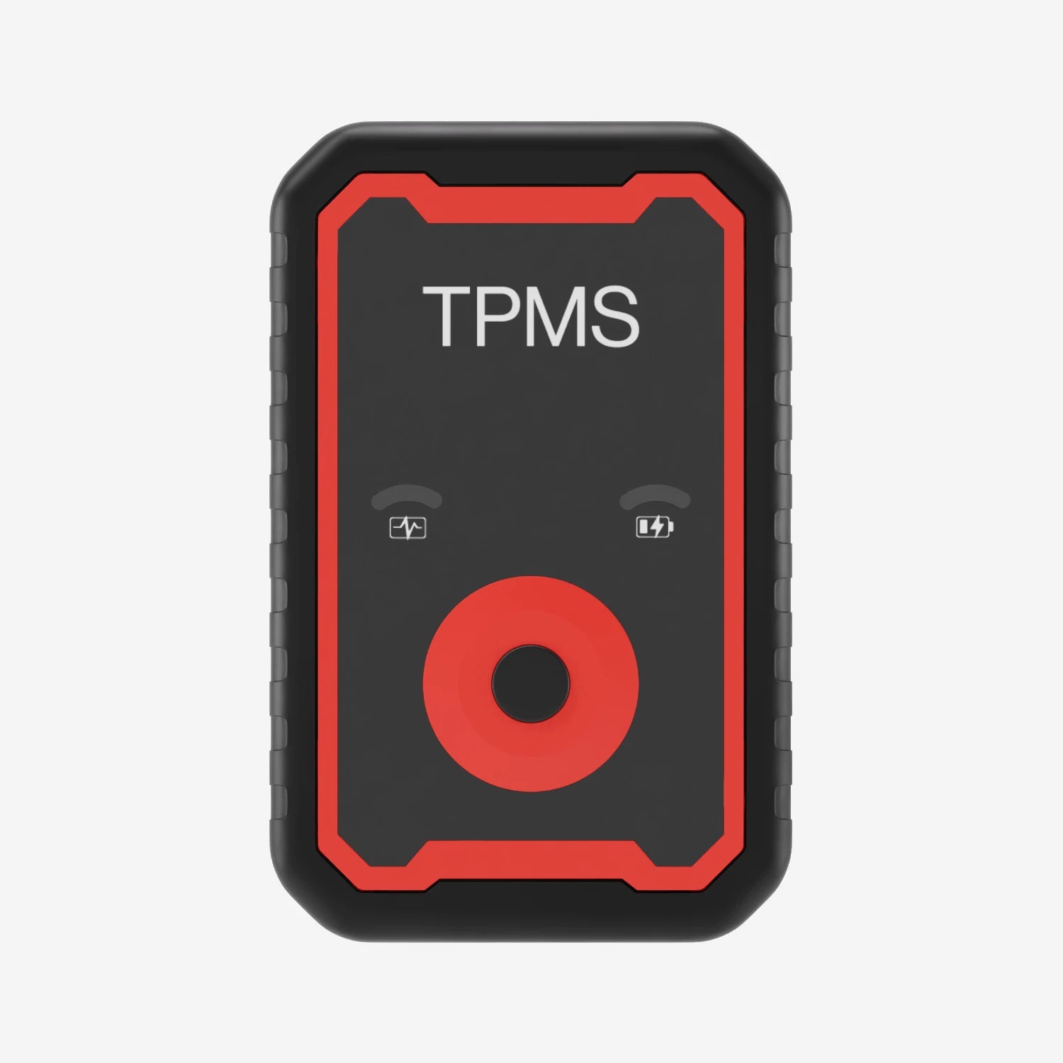

All sensors are pre-programmed in-house to be Set 1, Set 2, or Set 3 (or more if required), and these can be changed as needed with the Handheld Programming Unit.

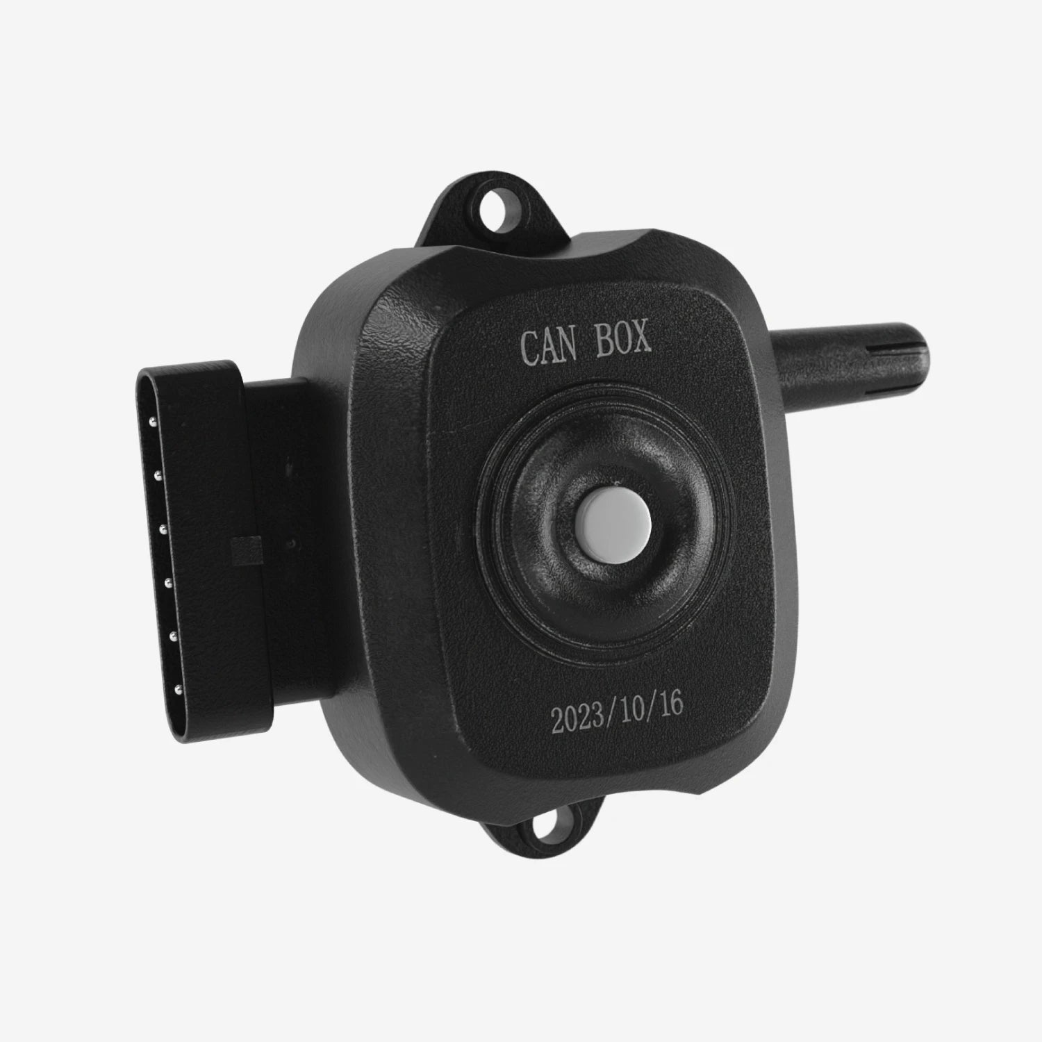

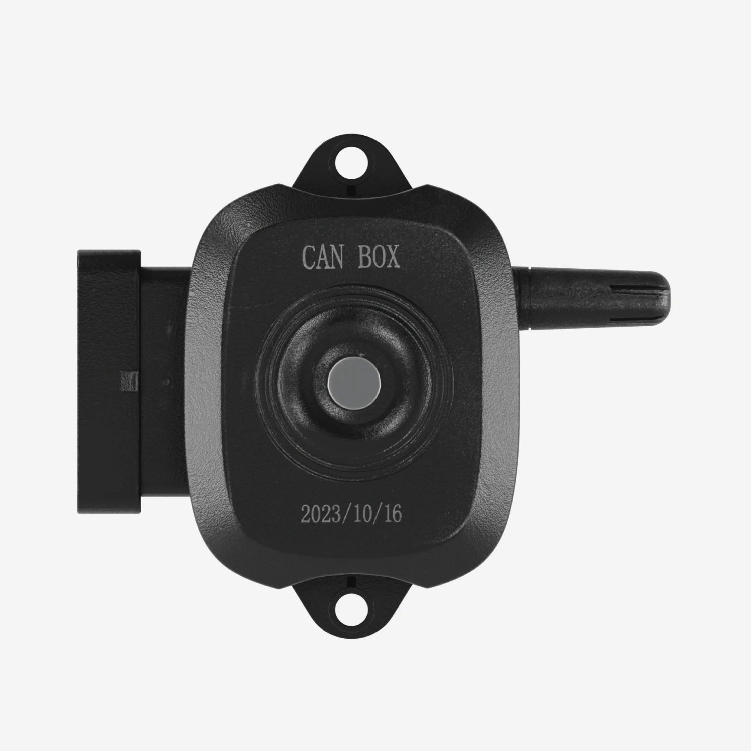

The Aim Tyre Pressure Monitoring System comes with a wiring harness, 4, 8, 12, 16, 20, or 24 sensors, and a CAN Receiver, which is compatible with race car applications and competitions.
The CAN Receiver utilises 1Mbit CAN (11bit), which has become the standard over the years for most professional ECUs, data loggers and dashboards within the motorsport and automotive sectors. The receiver is pre-coded with 4 sensors, and each sensor is labelled FR, FL, RR, and RL for each of the wheels of the car. All you need to do is connect your sensors to the correct tyre and all the data will be recorded on the receiver. You can overlay all of this data straight to your dash logger. Extra wheels can be clone-coded and used as sets of spares for pit changes, just clone a sensor manually using the Handheld Programming Unit.

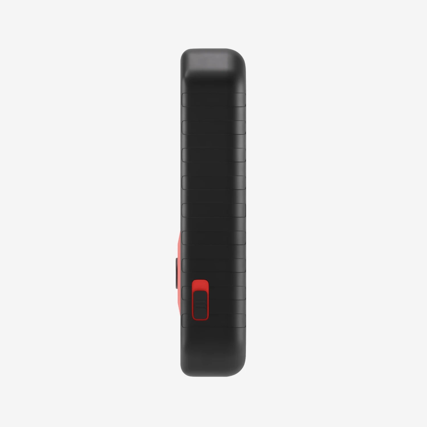

While the standard CAN Receiver uses a precise radio link to all your sensors, with the address of each sensor pre-defined as to which wheel is being measured, the Handheld TPMS Programmer lets you read each wheel individually when in close proximity.

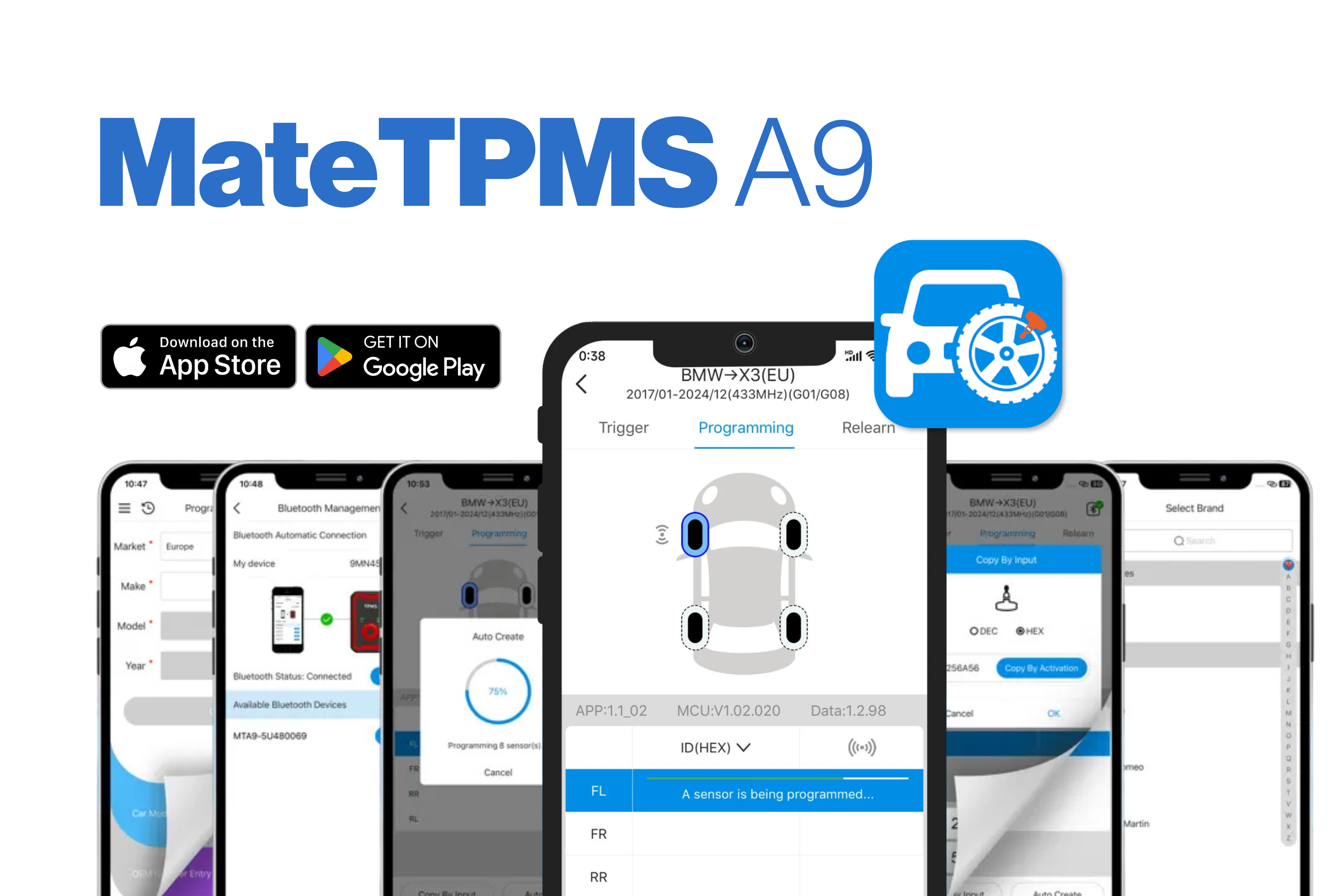

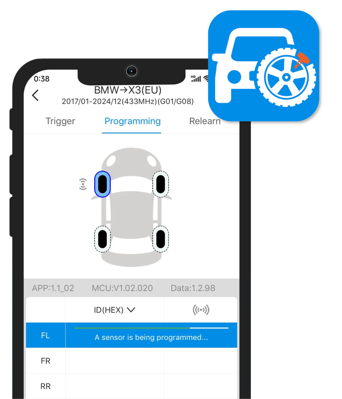

Free TPMS App
Quickly connect to the programming tool via Bluetooth without complex setups for easy programming of automotive tyre sensor replacements. It covers 95% of vehicles on the market, ensuring that no matter what car you drive, there's a corresponding programming option.
Download on iOS Download on Android

Sensor Specifications
  • Sensor Pressure Measurement Range: 0-8,000 mbar
  • High-Frequency Modulation Mode: FSK
  • Sensor Temperature Measurement Range: 0°C to 125°C
  • Sensor Temperature Resolution: 1°C
  • Sealing: IP67
  • Battery Lifespan: Min 2 race seasons
  • RF Frequency: 433.92 MHz
  • High-Frequency Emission Power: <8dBm (50ohms)

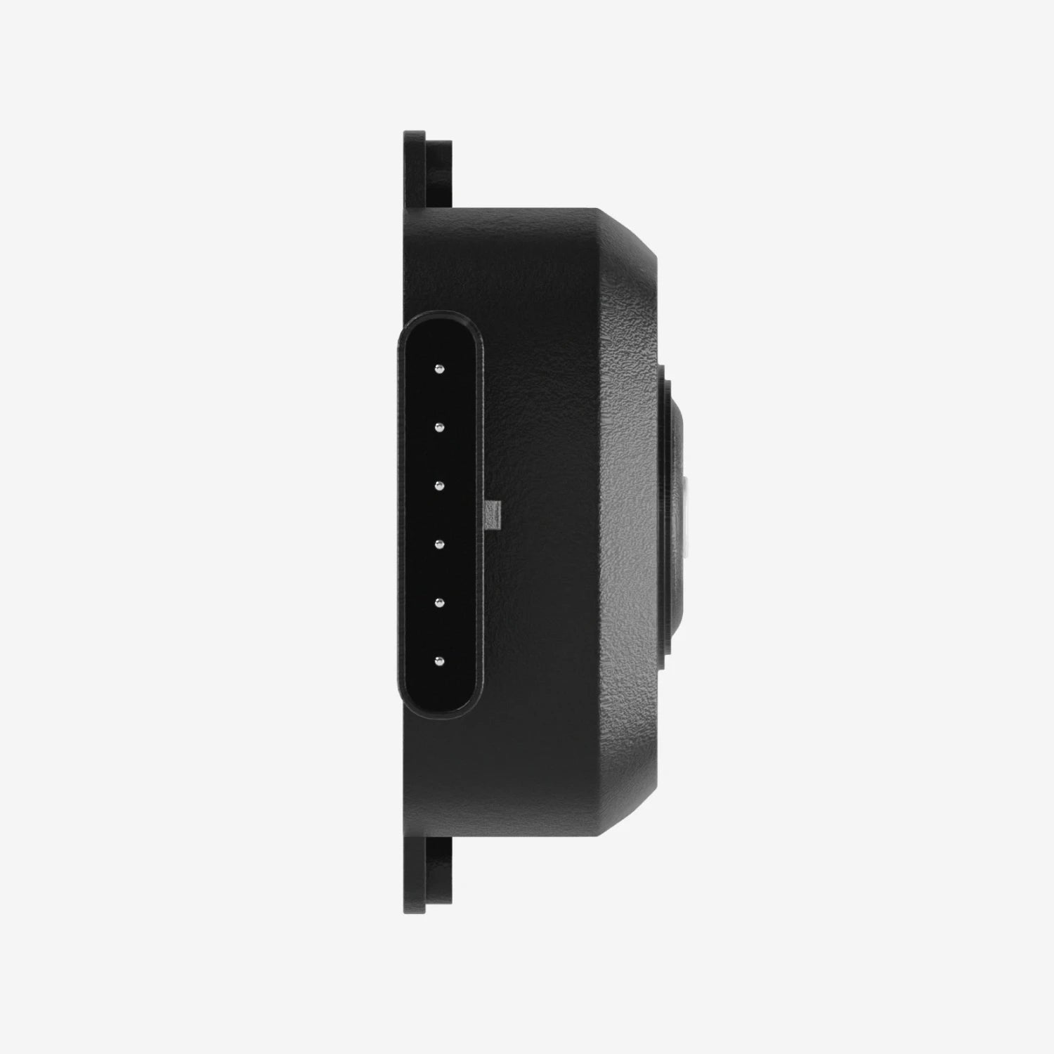

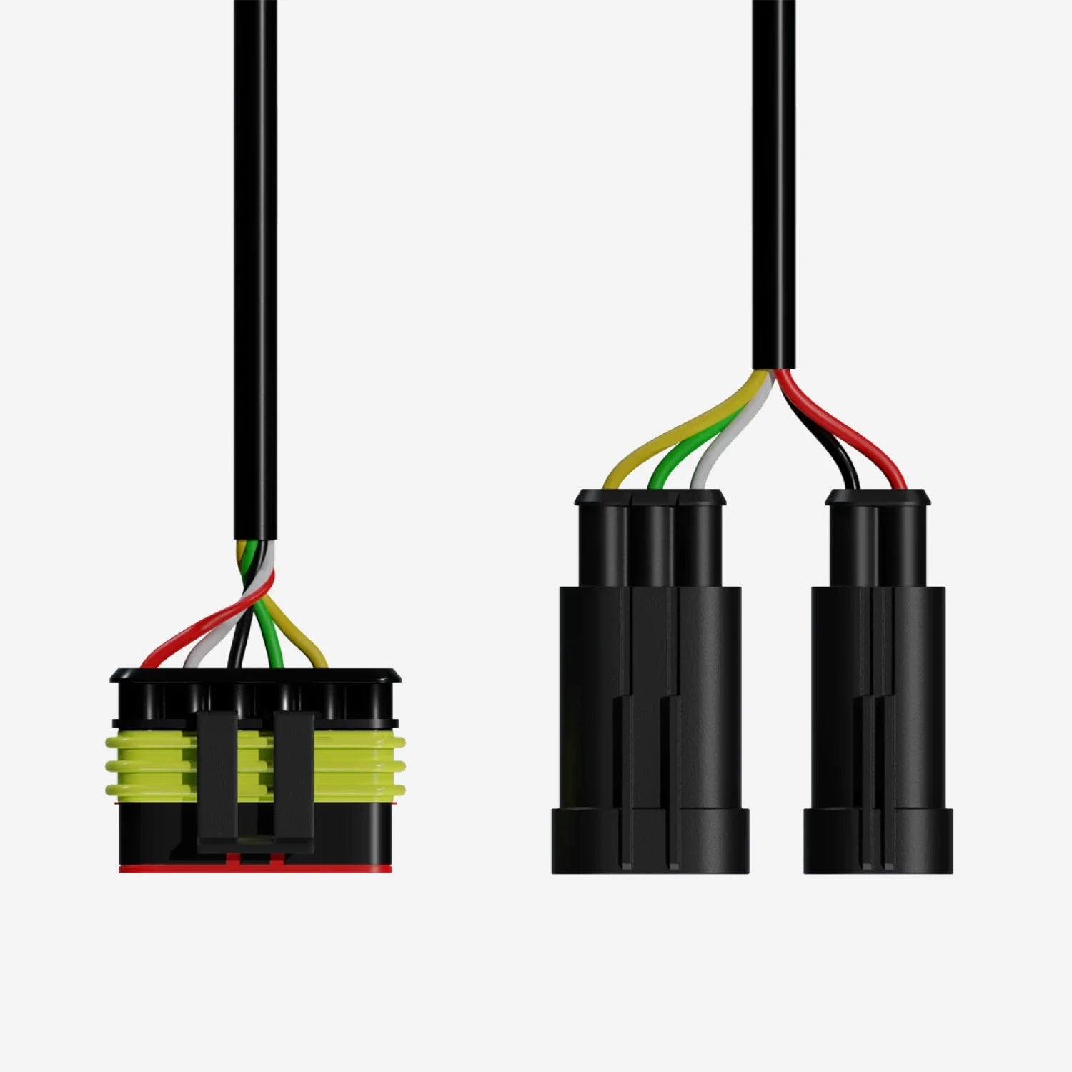

Wire Colour Code
  • +12V: Red
  • Ground: Black
  • CAN+: Green
  • CAN-: White

  • Connection output for CAN 2.0 1Mbps 11 bit

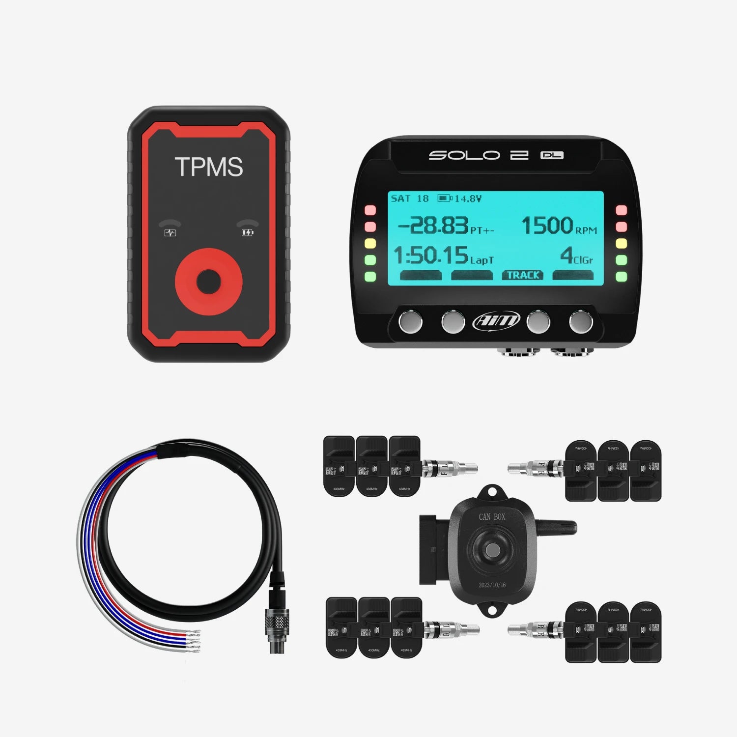

SKU: SOLO2-K3-TPMS-KIT-X47SOLO2DL02
  • Solo 2 DL
  • Power Cable with AC Adapter
  • CAN Cable
  • Sensors (quantity selected at checkout)
  • Tyre Pressure Monitoring System CAN Receiver - AimShop.com
    1x CAN Receiver
    TPMS Harness
