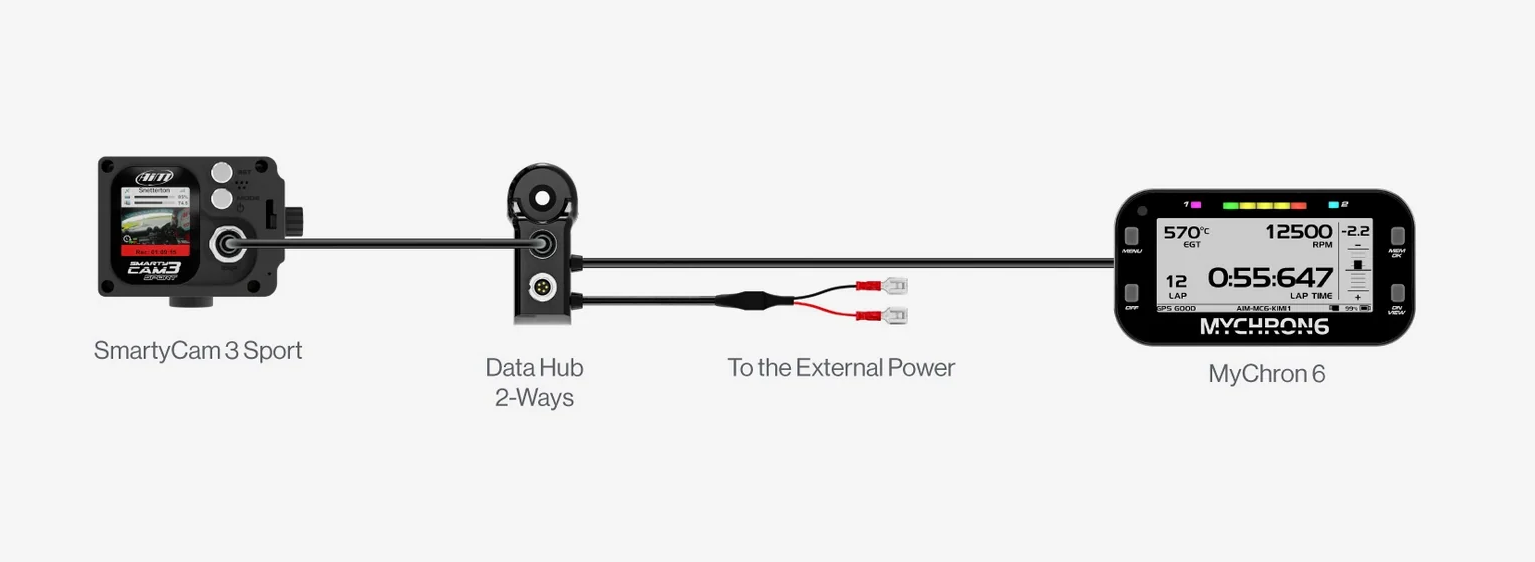

SmartyCam 3 Sport Connections
The SmartyCam 3 Sport camera, ideal in size and function for karting, can be directly connected to any of our supported lap timers and loggers - such as the MyChron 6 GPS Karting Lap Timer - that supply the camera with power and CAN information directly from your kart.

Expand your SmartyCam 3 Sport kart camera with a MyChron 6 Lap Timer, LCU-One S Lambda Controller, ACC3, Data Hub and sensors
Overlay your delta, predictive, timing splits, lap data and more in Race Studio 3 when you pair the SmartyCam 3 Sport with the Aim MyChron 6 GPS Lap Timer. Expand your system further with additional sensors and expansions such as the ACC, LCU-One S, Data Hubs, sensors and more. Please see the connections tab for connection examples.

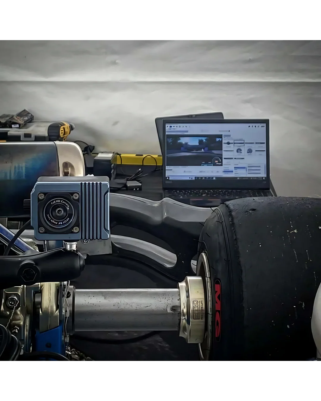

Aim SmartyCam cameras automatically record track sessions with telemetry data overlays on the video. When combined with sensors, the SmartyCam 3 Sport helps to monitor essential vehicle data to keep the kart running at its best and improve overall driving performance. To learn how to set up your SmartyCam 3 Sport to overlay track sessions, take a look at our video tutorial.
How do you mount the Aim SmartyCam 3 Sport to the kart?
The Aim SmartyCam 3 Sport has a variety of optional mounts for your kart, such as a u bolt or roll cage bracket. All mounting options provide a stable and vibration-resistant mounting solution, ensuring maximum visibility of your laps.
Where should the SmartyCam 3 Sport be aimed?
The camera should be aimed towards the track, ideally capturing the karters straight on view using the 67° lens or the wider 84° lens to get a broad view of the track and apexes. The built-in screen will allow you to visually set the positioning of the camera to get the best view of the track.
