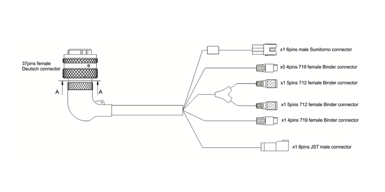

The Legends cars' specific 37-pin Deutsch connector harness allows connection to the vehicle battery and ECU directly, through the 8-pin, white JST connector labelled “ECU”, and to the onboard gear sensor, through the 6-pin, white Sumitomo connector labelled “CH. 1”.

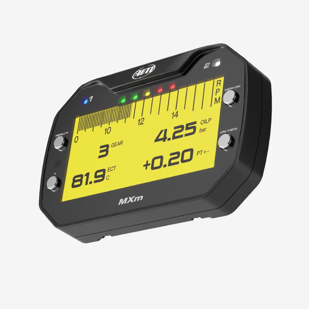

Integrated Shift Lights & Alarms
The MXM display has an integrated shift light system that features 5 fully configurable LEDs, which can be customised to your requirements and for each gear.
Two further LEDs can be configured to operate as warning alarms. These warning lights can be customised for a particular parameter that requires a warning light, the colour of the LED, and whether you want a solid or a flashing style alarm; even the flashing frequency can be tailored to suit your requirements.

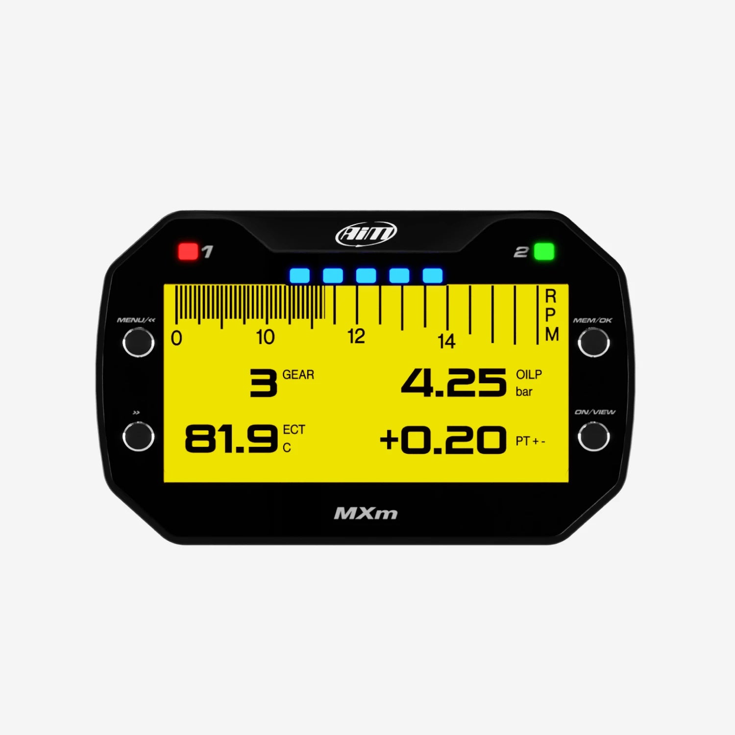

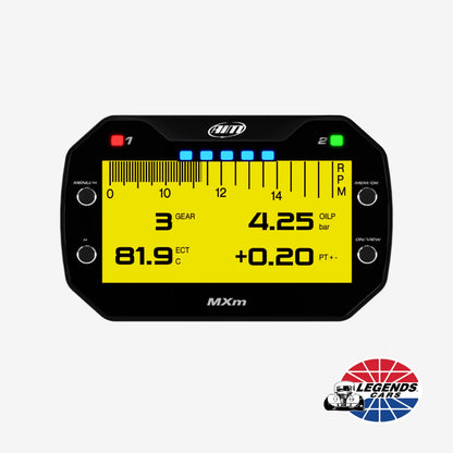

Sharp Liquid Crystal Display (LCD)
Making use of a sharp liquid crystal display, you can select the information that is displayed, and the backlight can be switched between a selection of available colours, all with high contrast and easy-to-read graphics.
The information that is displayed on the screen can be fully configured to show the most important information to you. If there is too much information shown on the screen, you can scroll between multiple pages using the integrated buttons so that nothing is missed.
After the session has concluded, all the data can be recalled on the screen, including a summary of your best laps, along with max/min RPM, speed and temperatures. If you would prefer to go through the data in more detail, the MXM dash features a Wi-Fi function to enable fast and secure data transfer to a laptop or PC up to 50 meters away, so you no longer need to take the laptop to the car.

Data Recall On-Screen
The information that is displayed on the screen can be fully configured to prioritise the most important information to you. If there’s too much information on the screen, you can scroll between multiple pages using the integrated buttons so that nothing is missed.
After the session has ended, all the data can be recalled on the screen, including a summary of your best laps along with max/min RPM, speed and temperatures. If you prefer going through the data in more detail, the MXM features a Wi-Fi function to enable fast and secure data transfer to a laptop or PC up to 50 metres away, so you no longer need to take the laptop to the car.

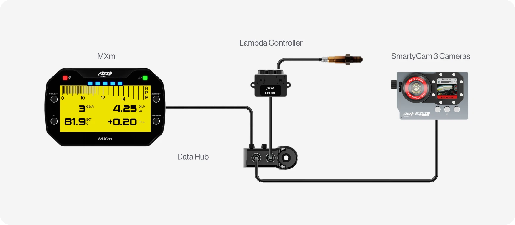

MXM Expansions list; SmartyCam 3, ACC3, Data Hub, GPS, and more.
Expand your MXM’s capabilities with a range of compatible accessories to guarantee precision and reliability.

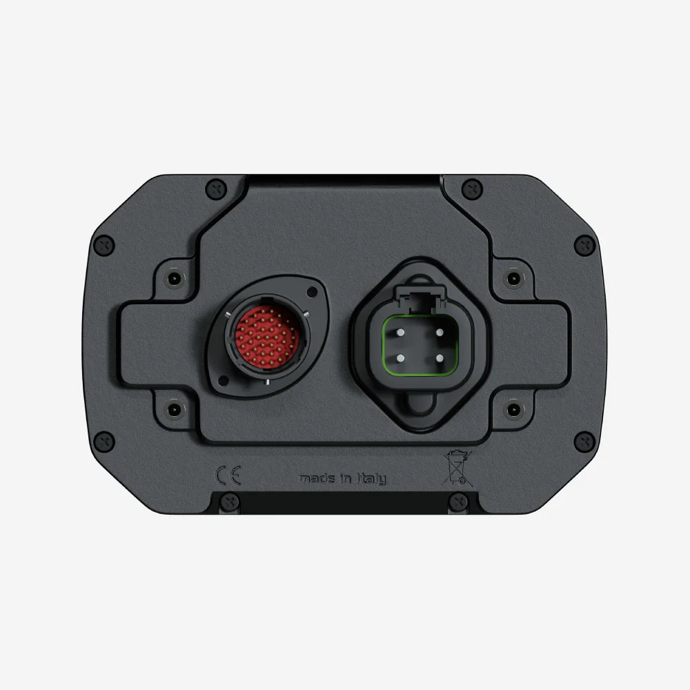

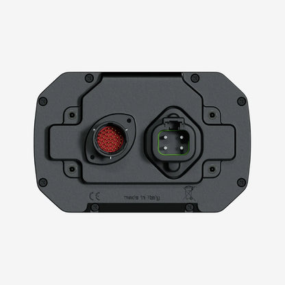

  • Connectors: 37-pin Motorsport connector for Legends cars + 4-pin power connector
37-Pin Harness Specifications
  • x1 6-pin male Sumitomo - On-board gear sensor connection
  • x3 4-pin 719 female binder - Analogue sensors connection
  • x2 4-pin 719 female binder - Speed inputs
  • x2 5-pin 712 female binders ("Y" cable) - Aim Expansions connection (labelled CAN EXP)
  • x1 4-pin 719 female binder - USB connection
  • x1 8-pin JST connector - ECU + external power connection (labelled ECU)

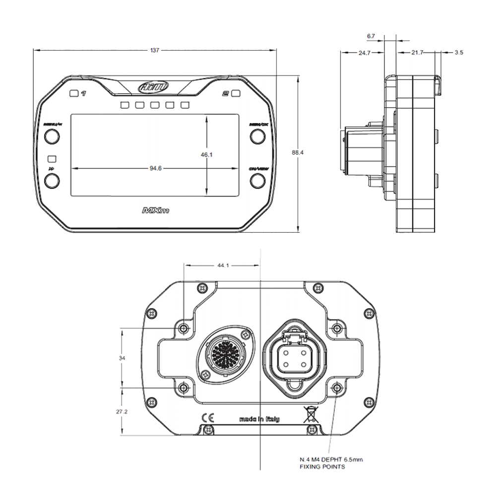

  • Weight: 330g
SKU: MXM-LEGEND-X87MXM0007
Aim MXm Data Logging Display dimension diagram

Aim MXm harness for legends cars
