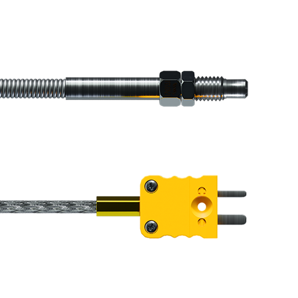

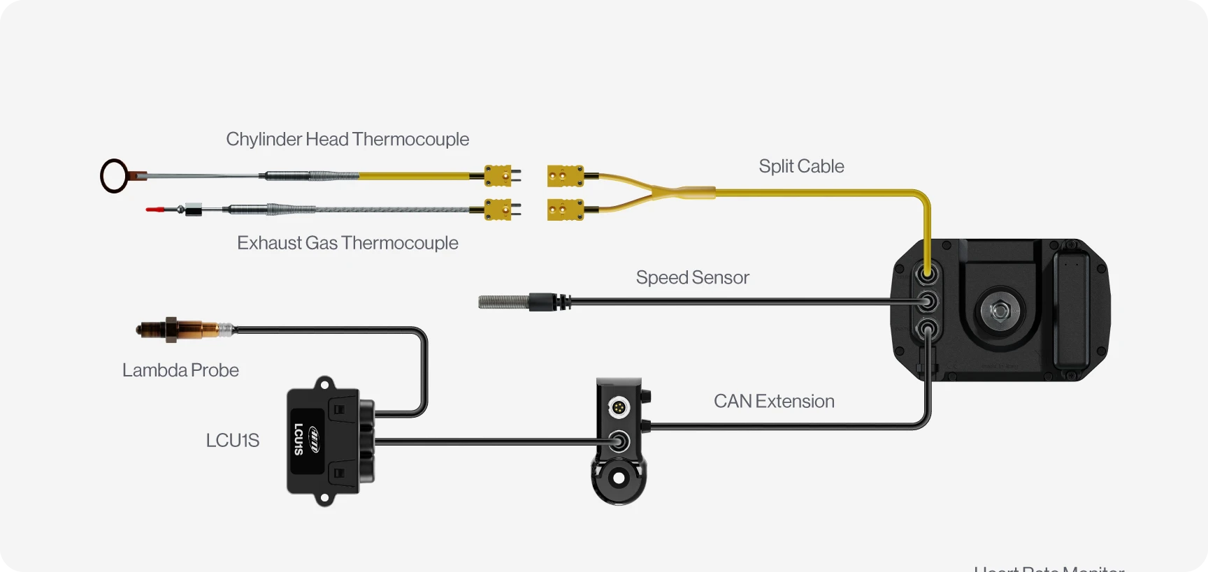

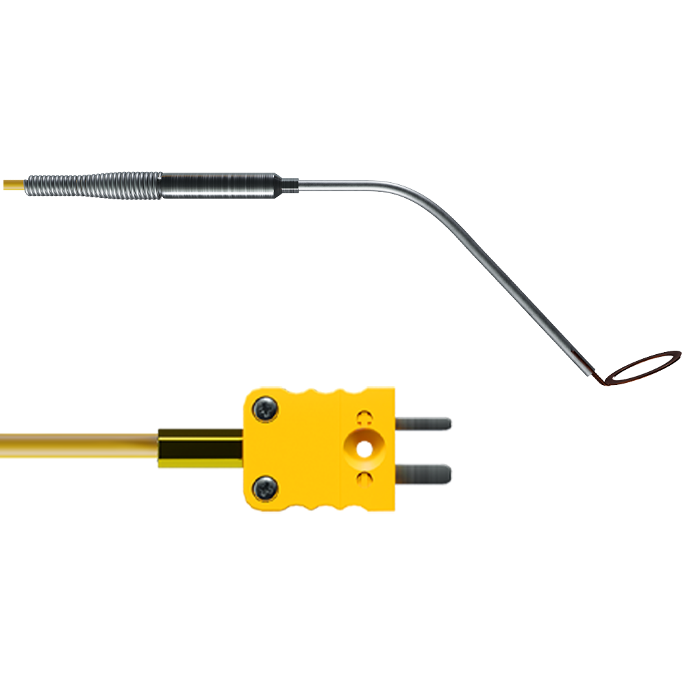

  • A cylinder head temperature (CHT) thermocouple and an exhaust gas temperature (EGT) thermocouple to accurately measure the EGT, which can both be fitted to the provided dragster thermocouple split cable.
  • A phonic wheel kit and a speed sensor that connects straight into the rear of the logger.

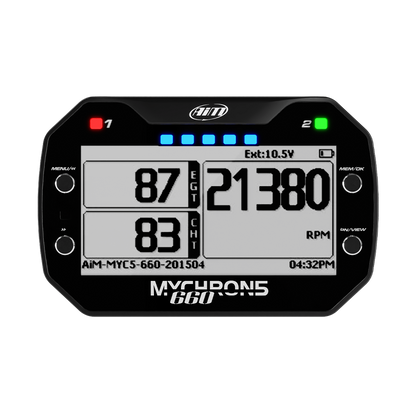

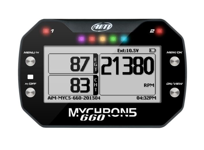

The MyChron5 660 features a high-contrast LCD screen, offering great flexibility and readability while you drive. Choose from 8 configurable RGB backlight colours to suit your requirements. The ambient light sensor switches the backlight ON/OFF according to the ambient light conditions. The MyChron5 660 has 2 RGB alarm LEDs. You can set these to work as a temperature alarm.

After a test session, it is possible to recall sampled data. Check your test sessions, test summary, selected test values eg, RPM, CHT, EGT, overdrive, or you can view in graph mode.

The MyChron5 660 has 4 metal, easy-to-use push buttons. This system has been designed to make the configuration of your display as easy as possible. You can configure the LCD set-up, drive set-up, RPM set-up, and units of measure. You can check that all sensors and expansions are connected and are in working order, and also know the number of recorded test sessions you have completed. Set the date and time and configure your Wi-Fi.
The MyChron5 660 is equipped with 4 engine pass counters, which can be configured in the menu.

The LCU-One S allows you to perfectly tune the carburetion of your engine to keep it at its best and improve the engine's performance. Alongside the Analogue CAN Converter, you can choose among 5 different split harnesses. Up to 4 thermocouples or 4 analogue channels 0-5V/0-12V are available.

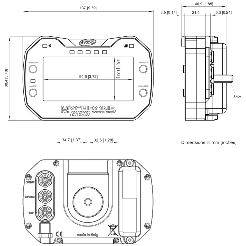

  • Dimensions : 137 x 88.4 x 47mm
  • Weight: 390g, battery included
