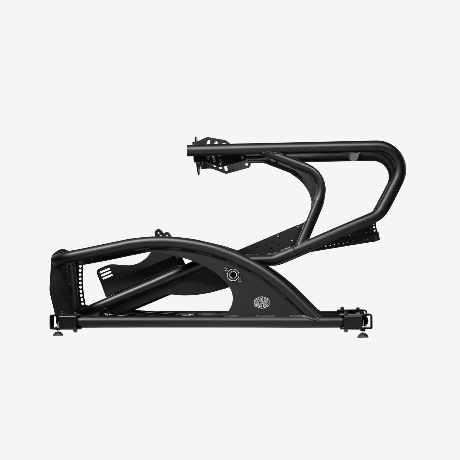

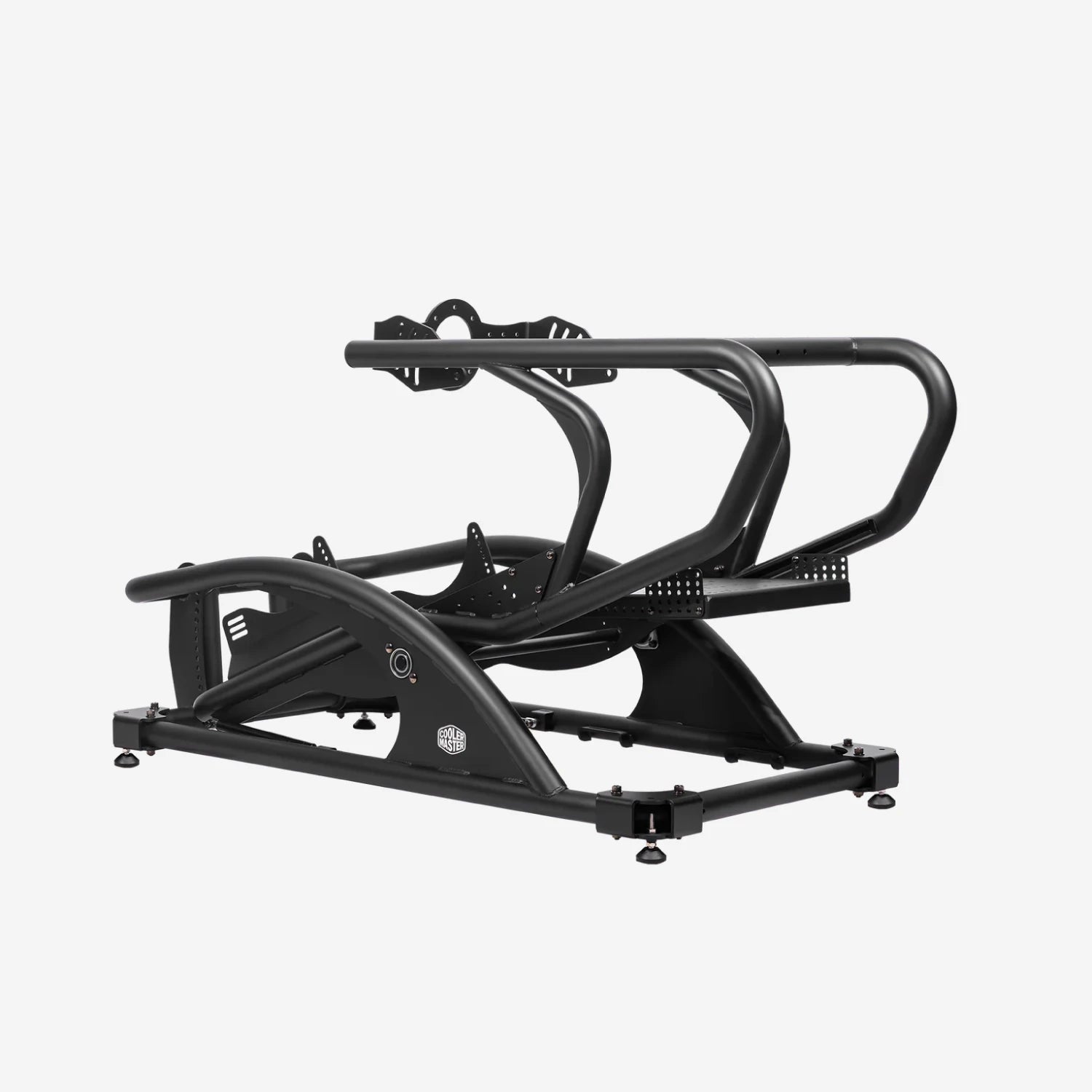

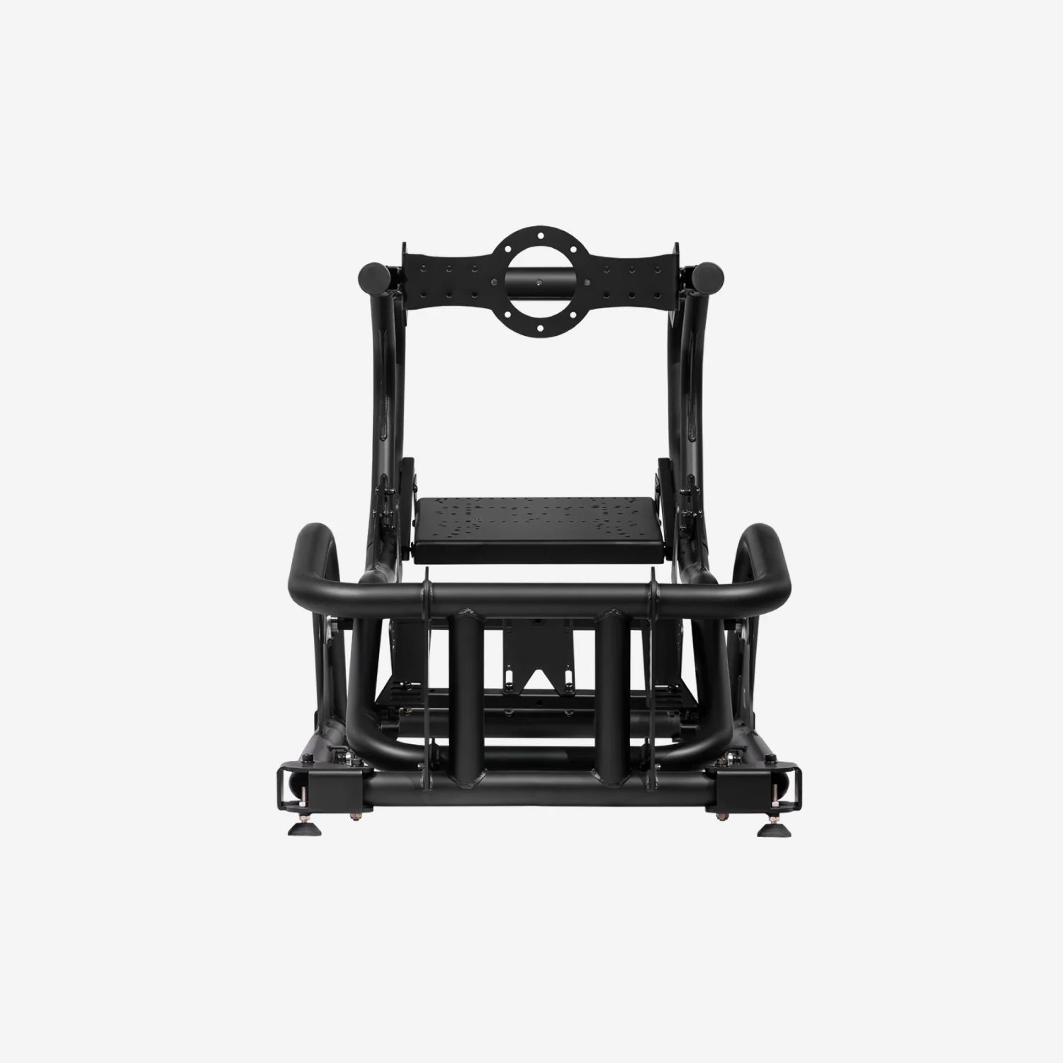

  • Component 1: Dyn X - Cockpit
  • Component 2: Dyn X - Racing seat
  • Ergonomics Group: 5 - 99th percentile (men)
  • Assembled Dimensions (Upmost Position): 1707 x 756 x 1044mm (LxWxH)
  • Assembled Dimensions (Downmost Position): 1591 x 756 x 998mm (LxWxH)
  • Ready for Motion Actuator System: Yes
  • Buttkicker Mount: Yes
  • Included Steering Wheel Mount: Front mount
  • Number of Driving Positions: 14
  • Frame Tubing Material: Steel (JIS STKM 13A)
  • Frame Tubing Diameter: 50.8mm
  • Frame Tubing Wall Thickness: 2mm
  • Gusset Thickness: 5mm
  • Steering Wheel Mount Material (All Mounts): Steel
  • Steering Wheel Mount Material Thickness (All Mounts): 6mm
  • Pedal Tray Material: Aluminium (5052)
  • Pedal Tray Material Thickness: 5mm
  • Seat Mount Material: Steel
  • Seat Mount Material Thickness: 3mm
  • Steering Wheel Slide (Forward/Back): 300mm
  • Steering Wheel Mounting Positions (Front & Side Mount): 6 (3 regular + 3 with mount inverted)
  • Steering Wheel Mount Degrees of Adjustment (Front & Side Mount): Position 1: 50°, Position 2: 47°, Position 3: 44°, Total: 80° (regular + inverted)
  • Steering Wheel Mount Height Adjustment (Front & Side Mount): 81mm (6 positions)
  • Steering Wheel Mounting Positions (Tray Mount): 4 (2 regular + 2 with mount inverted)
  • Steering Wheel Mount Degrees of Adjustment (Tray Mount): Position 1: 26°, Position 2: 24°, Total: 60° (regular + inverted)
  • Steering Wheel Mount Height Adjustment (Tray Mount): 140mm (4 positions)
  • Pedal Tray Slide (Forward/Back): 400mm
  • Pedal Tray Tilt (Up/Down): ±45°
  • Pedal Tray Lift (Up/Down): ±100mm
  • Seat Slide (Forwards/Backwards): 150mm
  • Seat Tilt (Up/Down): 3 - 27°
  • Seat Lift (Up/Down): 30mm
  • Number of Frame Tilt Positions: 14
  • Frame Tilt: 3 - 22°
  • Combined Frame/Seat Tilt: 6 - 49°
  • Seat Shell Material: Fibreglass reinforced plastic (FRP)
  • Seat Fabric Material: Premium synthetic suede (eco-suede)
  • Seat Padding: Multi-density foam / shock-absorbent foam
  • Harness Slots: 5
  • Headrest: Detachable and adjustable
  • Component 3: Dyn X - Steering Wheel Mounts - Side Mount
  • Component 4: Dyn X - Steering Wheel Mounts - Tray Mount
  • Side Mount - Supported Mounting Style: Side-mounted
  • Side Mount - Material: 6mm mild steel plate
  • Side Mount - Dimensions: 132.3 x 135.5 x 234.4mm
  • Side Mount - Degrees of Adjustment: Position 1: 50°, Position 2: 47°, Position 3: 44°, Total: 80° (regular + inverted)
  • Side Mount - Height Adjustment: 81mm (6 positions)
  • Tray Mount - Supported Mounting Style: Desk-mounted
  • Tray Mount - Material: 6mm mild steel plate
  • Tray Mount - Dimensions: 435.6 x 106.2m x 249.0mm
  • Tray Mount - Degrees of Adjustment: Position 1: 26°, Position 2: 24°, Total: 60° (regular + inverted)
  • Tray Mount - Height Adjustment: 140mm (4 positions)
  • Product Number: IXM-DX1-K-NN-1 (Rig)
  • Product Number: IXM-RS1-KB-NN-1 (Racing Seat)
  • Product Number: IXM-WM1-KS-NN-1 (Side Mount)
  • Product Number: IXM-WM1-KT-NN-1 (Tray Mount)
