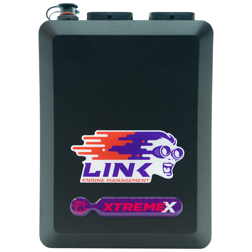

    Link G4X XtremeX WireIn ECU
    The XtremeX is one of Link’s premium ECU’s with more inputs, outputs and features.
    The XtremeX has a built-in E-throttle and all the advanced features including Anti-lag, Cruise Control and Traction Control.
    With 8 Injector drives and 8 ignition drives, the XtremeX can control up to 4 rotors or 8 cylinders with sequential injection and direct spark. The XtremeX is a great choice for professional-level motorsport or more demanding road car applications.
    Please note: for peak & hold, please contact a Link ECU Sales Person to purchase a G4+ Xtreme ECU.
    * Requires "A" & "B" looms for installation.
    If it is Onboard Digital Wideband Lambda Control you are after, consider the Fury.
