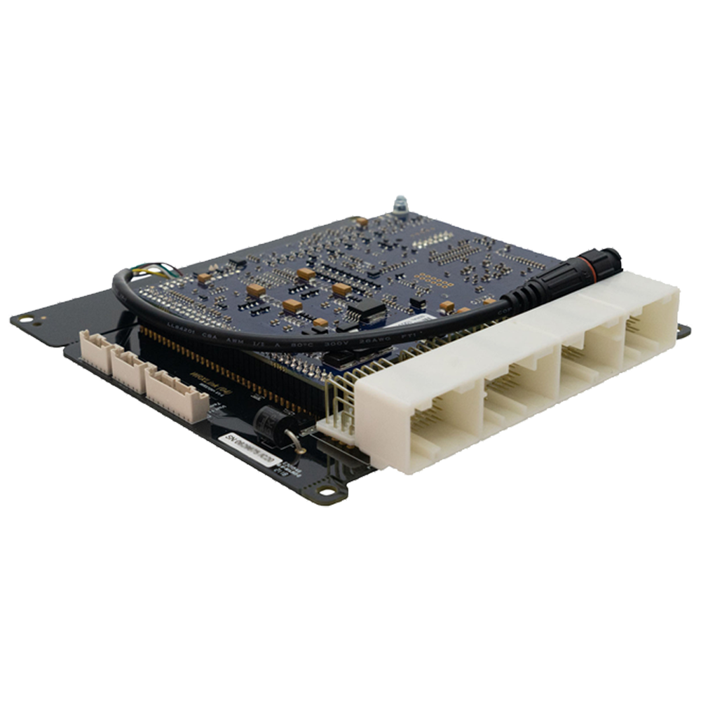

    Link Subaru WRXLink (04) - WRX104X PlugIn ECU
    Designed for the WRX V10 EJ25. These ECUs cover 2.5L from 2004 to 2007.
    Air temp sensor highly recommended.
    Suitable Applications:
    The WRX104+ mostly covered the 2004-2006 range.
    The WRX107+ mostly covers the 2007 model (listed separately).
    However, some 2006 models require the WRX107+
    *The fastest and most reliable way to tell, is to check whether pins A1-3 are populated.
    *If the pins have wires, you need the WRX104+, if there are no wires, you need the WRX107+
    *Suits GD or GG chassis with electronic throttle. Not suitable for the GR/GH/GE/GV hatchback or 3rd generation WRX’s
    PlugIn Key Features:
    Sequential fuel delivery
    OEM idle hardware supported
    CAN port
    USB tuning cable included
    Staged injection
    Knock with "windowing"
    There are two different options for the expansion connectors, depending on whether your ECU is the 2004-2006 ECU or the 2006-2007 ECU.
    2004-2006 ECU
    Blank AN Volt 11
    Blank No function
    Blank AN Volt 12
    Blank No function
    Blank No function
    Gnd Sensor Ground Only
    2006-2007 ECU
    The 2006-2007 V10 ECU contains an 8 pin expansion connector.
    Aux 11 Auxiliary Output
    Aux 12 Auxiliary Output
    Volt 11 Analog 0-5V input
    Aux 13 Auxiliary Output
    DI 11 Digital Input
