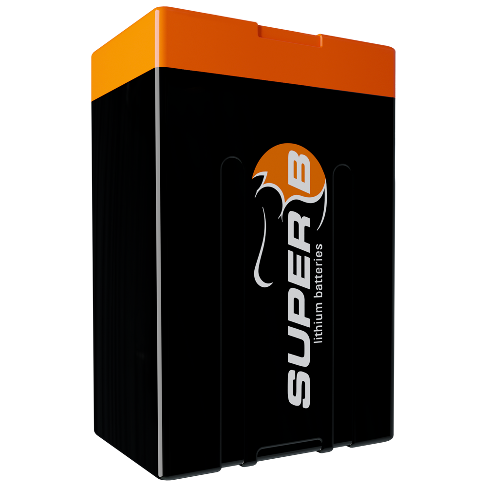

The Super B Andrena 12V15Ah Lithium Battery delivers lightweight, high-performance power designed specifically for motorsport and high-demand 12V systems. The Andrena 12V15Ah battery equals a lead-acid battery of 40 to 60Ah, provided the alternator’s maximum current doesn’t exceed the battery’s maximum charge current of 52A.
Lightweight Power
With a weight of only 2.4kg/5.4lbs, the Super B Andrena 12V15Ah Lithium Battery saves up to 80% in weight in comparison to traditional lead-acid batteries and is only 1/3 of the size of a conventional battery. This improves not only the performance of your vehicle but also helps to increase the fuel economy.
The power battery offers a high level of power, fast charging and a long, maintenance-free service life. It also has a stable and flat discharge, which means you have over 80% of the batteries capacity available, and you can leave your vehicle unattended for a much longer period compared to a lead-acid battery.
Safe & Reliable
Based on lithium iron phosphate (LiFePO4) technology, the Super B Andrena has the safest lithium technology available today. On top of that, it offers a nominal capacity of 15Ah and 192Wh of energy, with a bespoke casing and electronics that further increase safety and durability.
With ultra-low self-discharge (< 3% per month) and the durability of LiFePO4 technology, the Super B Andrena remains ready even after long periods of inactivity. Ideal for motorsport, marine, or performance-mobile applications, this battery offers fast recovery, reliable starting power, and the peace of mind that comes with lithium technology.
3-Year Warranty
All Super B batteries come with a 3-year warranty, offering the best peace of mind. It is the benefit of years of continuous engineering improvement and proven experience with all batteries in the harshest environments.
Electrical Specifications
  • Nominal Capacity: 15Ah
  • Energy: 192Wh
  • Nominal Voltage: 12.8V
  • Open Circuit Voltage: 13.2V
  • Cycle life: >1000 (at 10C charge/discharge, 100% DoD)
  • EqPb (Equals lead-acid): 40 - 60Ah
Mechanical Specifications
  • Dimensions (LxWxH): 120 x 82 x 181mm / 4.72” x 3.23” x 7.13”
  • Weight: 2.4kg / 5.4lbs
  • Case Material: PC - ABS
  • Ingress Protection: IP69
  • EAN-13: 8718531360044
  • Battery Designation: 4IFpR27/66-6
  • Charge Method: CCCV
  • Max Charge Current: 52A
  • Discharge Current Continuous: 240A
  • Discharge Pulse Current (1 sec): 708A (47C)
