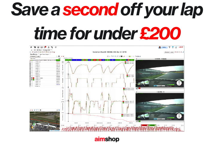

How Can Brake Pressure Sensors Help Me Save A Second Off My Lap Time In Racing?
A brake pressure sensor can be a game changer for improving lap times in racing by giving you more precise control and insights into your braking performance. Here's how:
- Optimising Brake Usage: A brake pressure sensor allows you to monitor how hard you're applying the brakes at each corner. By knowing exactly how much pressure you’re applying, you can adjust your braking strategy to maximise braking performance without overshooting the threshold (locking up or running too deep into a corner).
- Consistency: One of the most critical factors in racing is consistency. With a brake pressure sensor, you can ensure that your braking force is repeatable, lap after lap, which is crucial for maintaining a fast pace. Inconsistent braking can lead to slower lap times, so being able to match the pressure you apply to the exact ideal level can shave off valuable time.
- Fine-Tuning Brake Bias: In some racing setups, you can adjust the brake bias (front to rear brake force distribution). Having brake pressure data from all corners allows you to fine-tune the balance to optimise braking efficiency. If you're overloading one end of the car (e.g., too much front brake pressure), you can adjust accordingly, which leads to better handling and braking performance.
- Feedback for Improvement: Over time, you can analyse data from the sensor to understand your braking behaviour. Maybe you're braking too early or too late, or maybe you’re not reaching peak braking pressure at certain parts of the track. This data gives you specific points to focus on in your driving technique, helping you improve your braking performance and overall lap times.
- Managing Brake Temperature and Wear: Brake pressure sensors can also help track how much you're using the brakes during a race, which can indirectly inform you about brake wear or potential overheating. By managing your brake usage more efficiently, you can avoid fading or failure, allowing for more consistent lap times throughout the race.
By using the brake pressure sensor to adjust your braking techniques, monitor your consistency and optimise the setup, you can ensure you're braking as effectively and efficiently as possible, shaving seconds off your lap times.
Understanding The Brake Trace
The brake trace (or braking graph) is a visual representation of how you apply brake pressure throughout a braking event during a lap. To achieve the best braking practice, the ideal brake trace typically has these characteristics:
Sharp Initial Application (Peak Pressure)
- What it looks like: At the beginning of the braking zone, the graph shows a sharp upward spike as you quickly apply maximum brake pressure.
- Why it’s ideal: You want to reach peak brake pressure as quickly as possible without locking the wheels, which maximises deceleration while maintaining control.
Consistent Peak Pressure (Flat Top)
- What it looks like: After the initial spike, the brake pressure should hold at or near peak pressure for a period (depending on the corner's requirements).
No Early Release or Snail-Like Decay
- What it looks like: There should be no sudden or premature release of brake pressure; ideally, the graph should show a smooth, controlled drop in brake pressure as you reach the apex of the corner.
- Why it’s ideal: If you release the brake too early, you’re not using the full braking potential of the car, which reduces lap time. A jagged or inconsistent release can destabilise the car and make corner entry harder.
Minimal Oscillations
- What it looks like: Ideally, the brake pressure curve should be smooth without significant fluctuations. If the trace has spikes or drops mid-braking, it indicates inconsistent application of brake pressure.
- Why it’s ideal: Oscillations suggest you're not applying brake pressure smoothly, which can lead to unpredictable car behaviour or excessive tyre wear.
Example Of The Ideal Brake Trace
- Sharp initial rise: From 0 to peak pressure (typically at 100-200ms after entering the braking zone).
- Sustained high pressure: Flat or slightly sloped plateau for the majority of the braking zone.
- Smooth tapering off: Gradually reducing the pressure over the final 50-100 meters (depending on corner specifics).
What Bad Practices Look Like
- Late application: If you see a delayed rise to peak pressure (you start braking too late), it means you’re losing valuable time during the braking zone.
- Too early or too quick of a release: If the brake pressure drops too quickly, it indicates you’re not maximising braking efficiency.
- Jagged oscillations: This can be a sign of improper modulation of the brake pedal or aggressive driving inputs that destabilise the car.
By analysing the brake trace and aligning it with these best practices, you can ensure you're braking as effectively and efficiently as possible.
