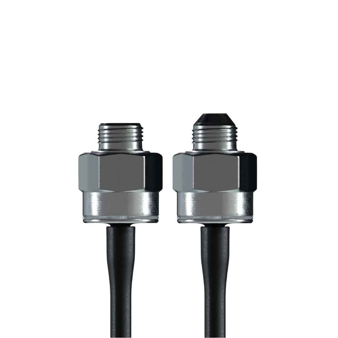

Ideal in motorsport setups where space and weight are at a premium, Combined Temperature & Pressure Sensors offer a dual-purpose solution without compromising reliability up to 100 Bar.
  • Dual-Stream Data: Monitor fluid or air pressure alongside temperature simultaneously, giving you a complete picture of your vehicle's thermal and hydraulic health.
  • Motorsport-Grade Durability: Built to withstand the extreme vibrations, high-G shocks, and intense heat cycles found in racing environments.
  • Versatile Fitment: Available in M10 or -3 JIC (3/8-24 UNF) threads to suit most engine blocks and manifolds.
  • Flexible Integration: Choose between a 4-pin binder 719 (plastic) male connector for a plug-and-play experience with Aim devices, or free wires for custom loom builds.
  • Customisable Scales: Available in both Bar or PSI to match your preferred data visualisation.

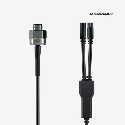

How the Combined Pressure Sensor Works
The Combined Sensor utilises two distinct internal sensing elements, housed within a single threaded body. This allows it to tap into a single fluid gallery, such as an oil sandwich plate or a coolant bypass, to provide two independent signals.
