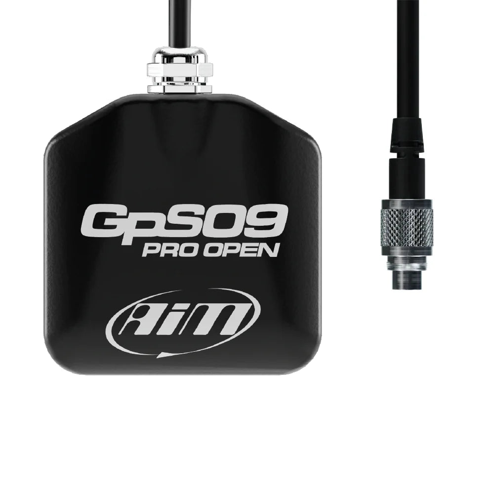

GPS09 Pro Open Module activates instant lap tracking, recognising start/finish lines and details effortlessly. The Pro Open version of the GPS09 features a 6-axis 100Hz inertial platform and is connected via a CAN cable, which makes it quick and simple to install.

  • Open Dimensions: 53.2 x 53.8 x 19.7mm
  • Open Weight: 60.5g

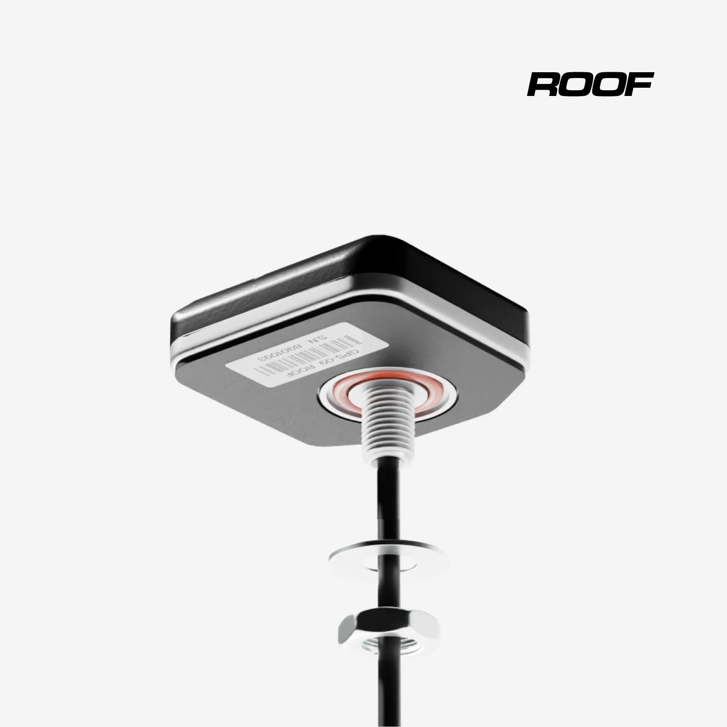

  • Open Roof Version Dimensions: 53.2 x 53.8 x 37.2mm
  • Open Roof Version Weight: 100g
